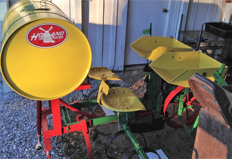

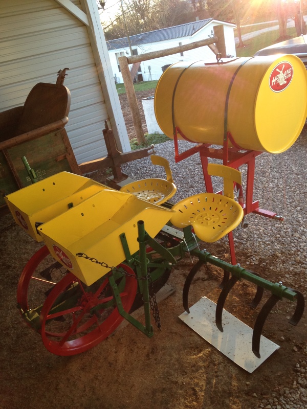

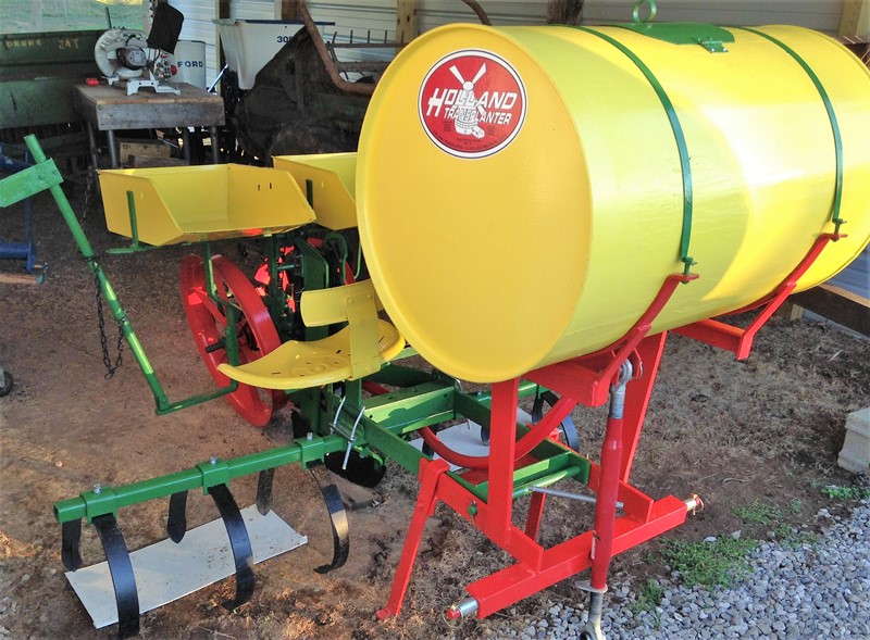

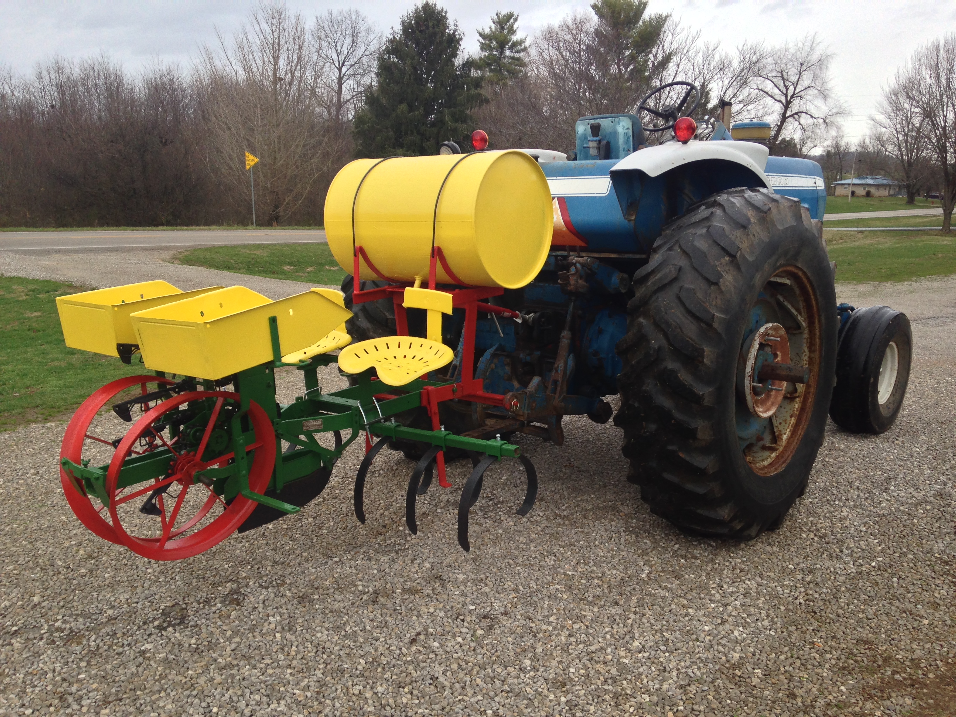

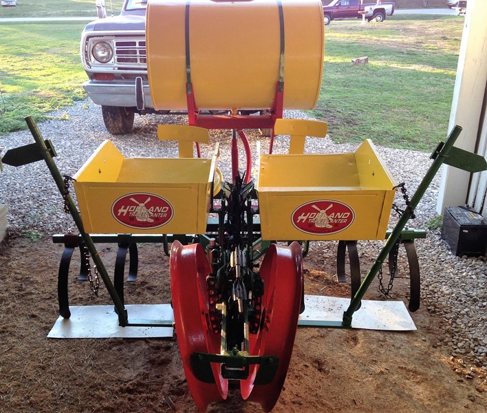

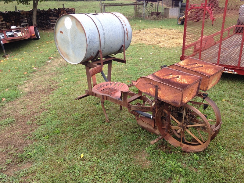

Here's my second restore i hope to use this year to plant my vegtable's in the garden lol a Holland Transplanter I picked up for $30 no one else wanted it said it was scrap. Ohh how wrong they were i love the way it turned out.
Before
With out New Decal's and set of row marker's
After the new Decal's in my shed

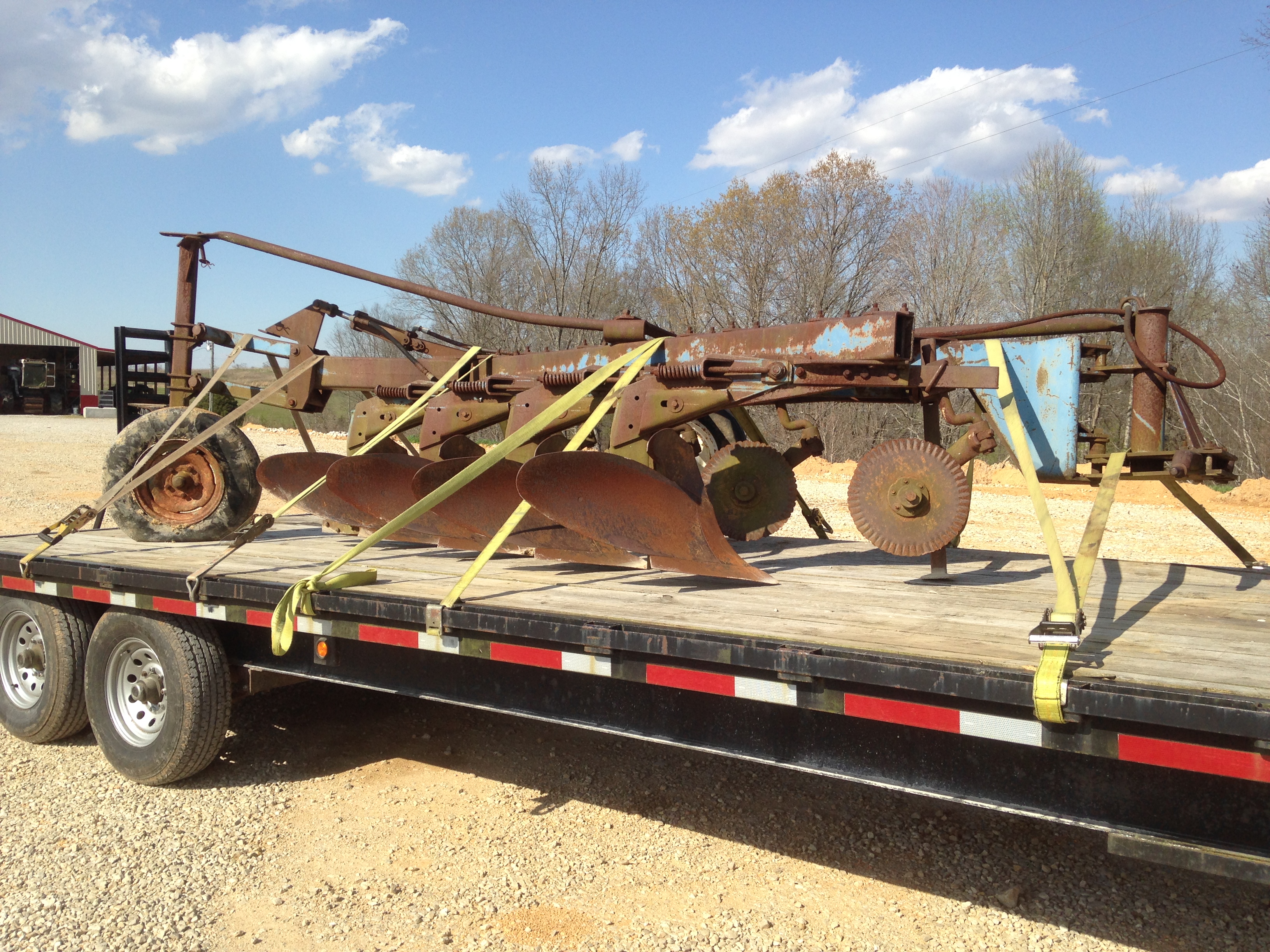

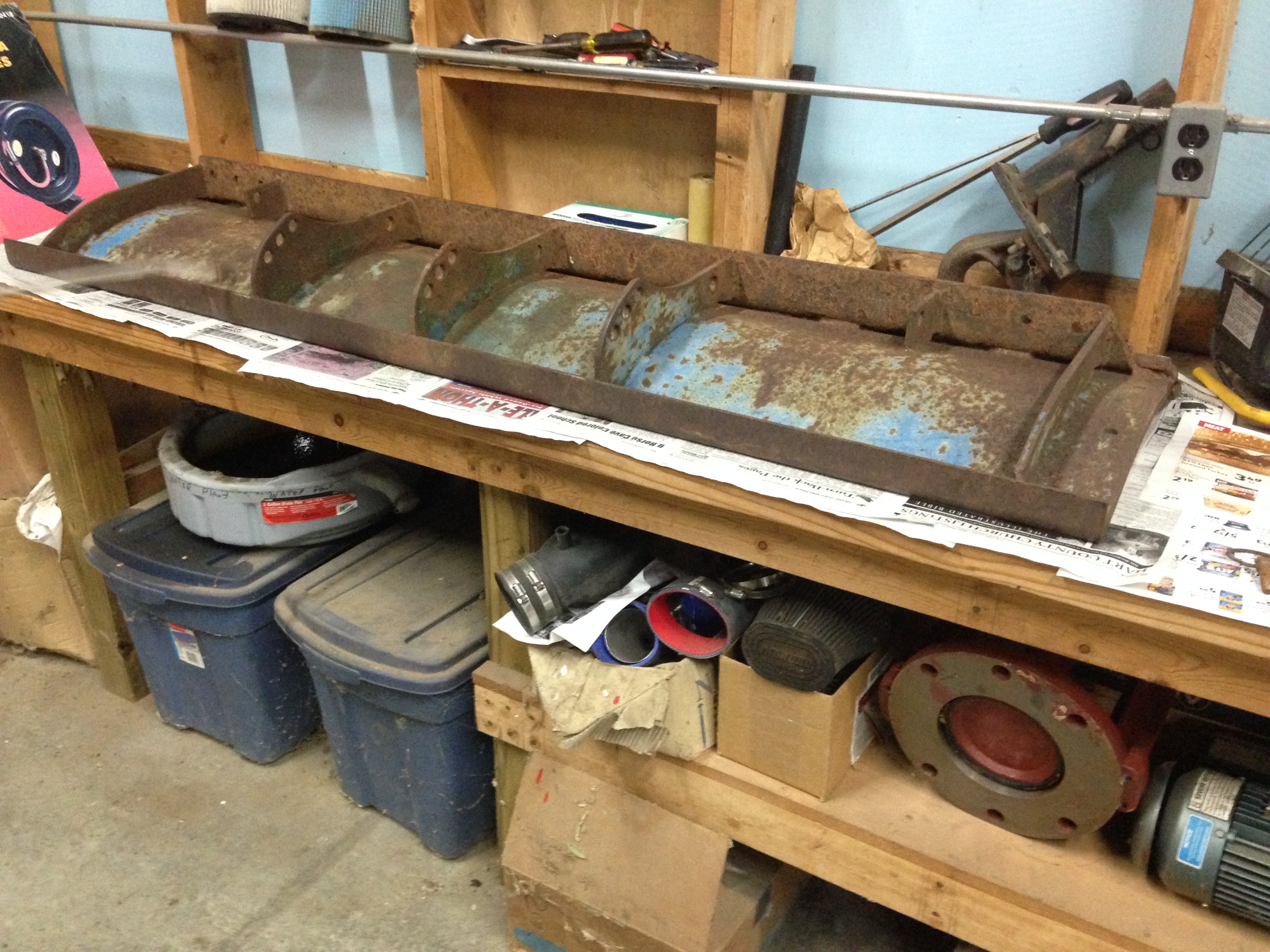

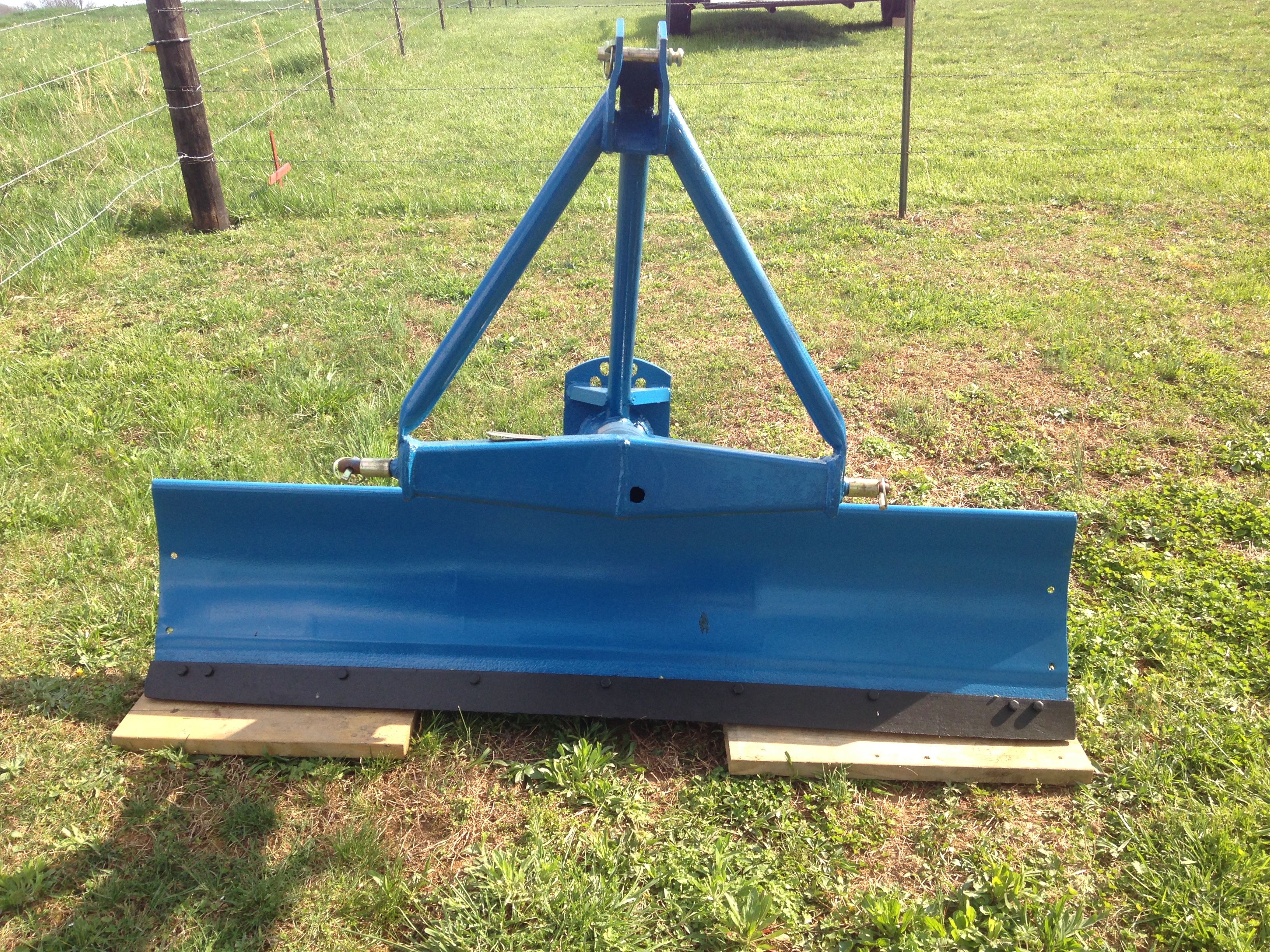

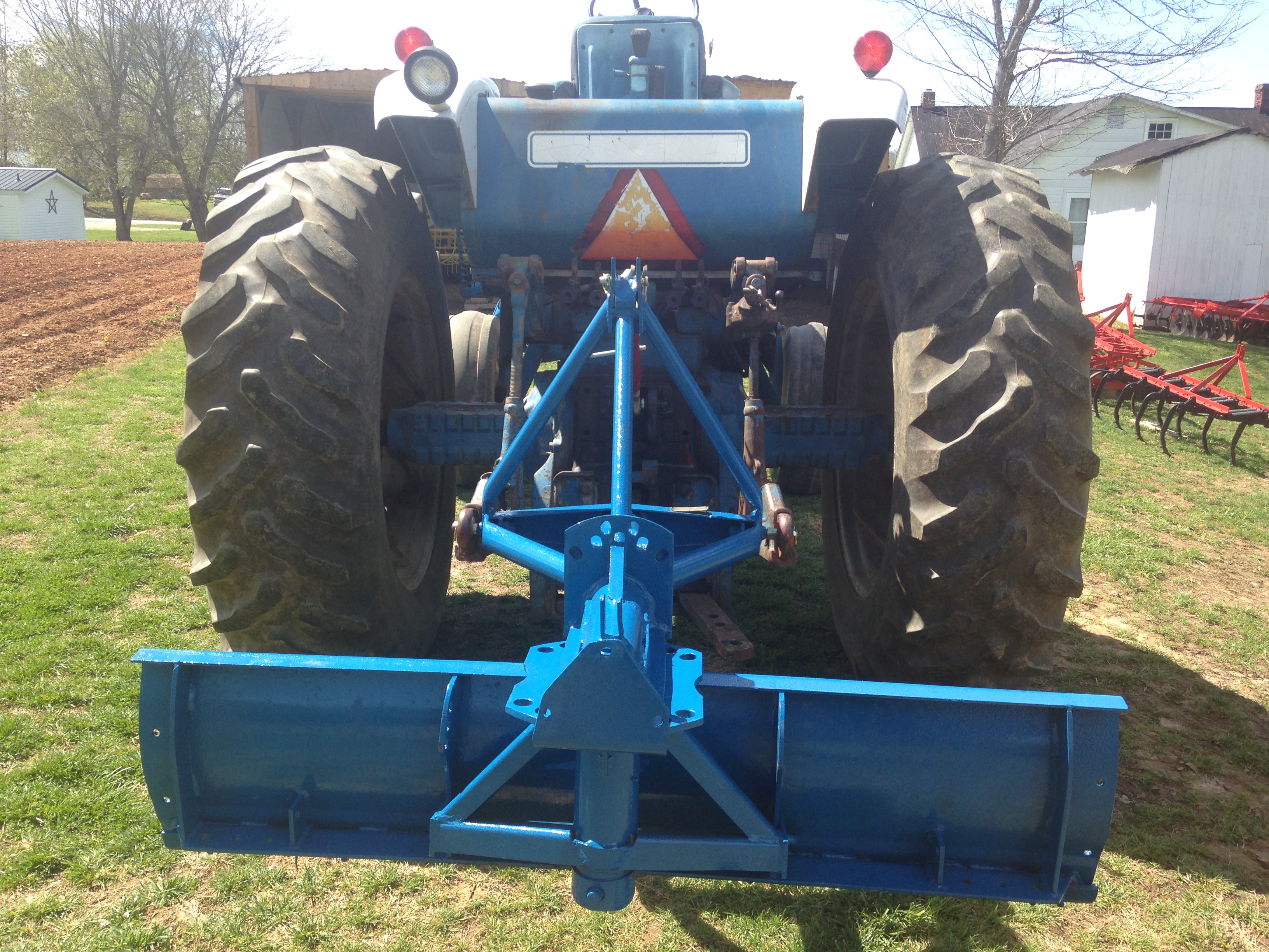

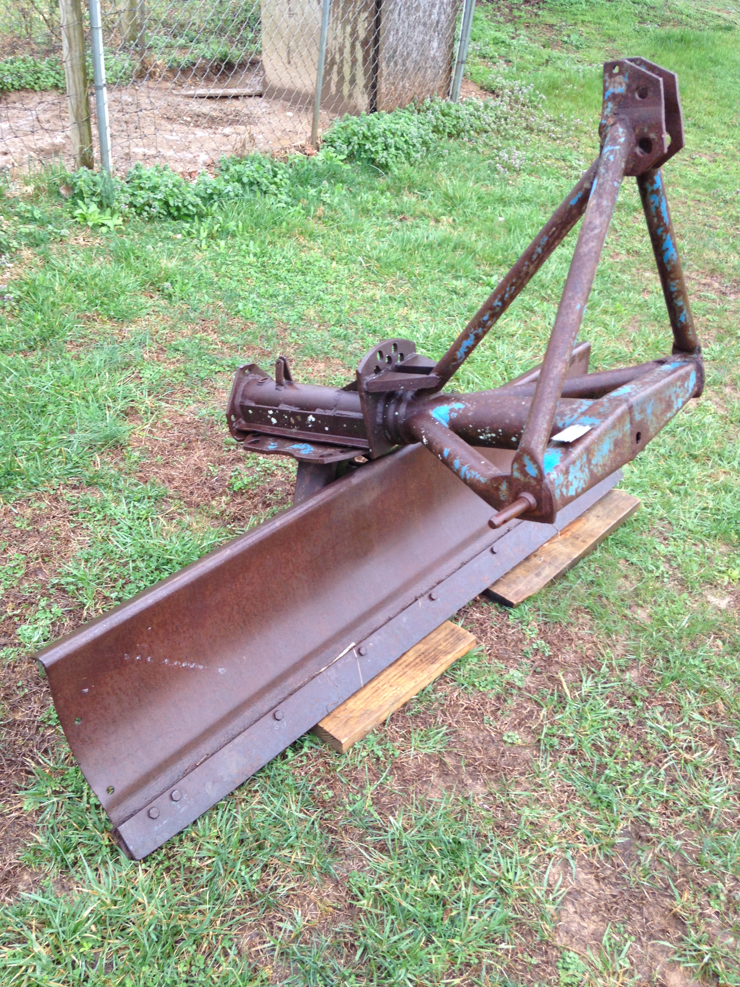

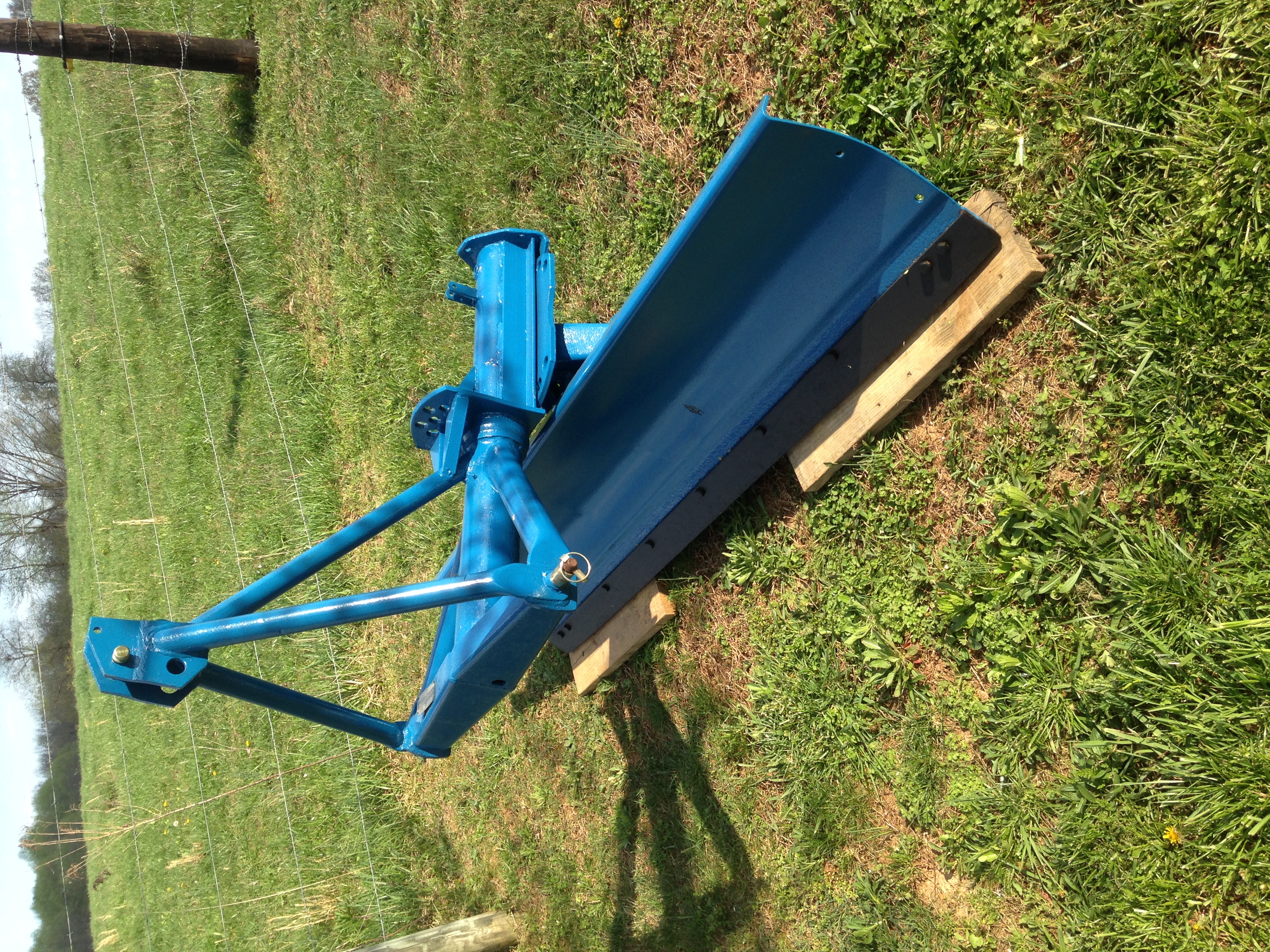

Awesome work guys keep those post coming!! Here's my Latest Job A ford 710 Utility Blade i wasn't able to do a complete restore because someone had welded it up fixed and i think its a lot more solid now. So i left it alone and just grind down the rough spot's. Cleaned up the weld's, sanded, Primed and Painted it good. I believe it will suit me till i can get a bigger one. Have to wait on new decals the lady i use had a death in the family so gotta wait till next week. I also traded my 101 Ford 3 btm 14" Plow for a Ford 142 4 btm semi-mount 16" Plow which will be in for a redo soon. Currently redoing my Ford Rotary Hoe which has been a little tough the axle and spacers are rusted together so gotta use heat which is time consuming to say the least.
Before:
During:
After Without Decals and a darn bird pooped on it lol:
My Ford 142 Plow:

You do some very nice work Greenriver. So now I'm curious about your process. What are you using to sand down the implements? What type of primer and paint are you using? Any tips you might have. I have been acquiring a few implements and would like to see them look like new. I'm afraid I will run out room in my shop if they looked as good as your equipment. Currently they live outside.
Keep the pictures coming
   / Restoring old Implements back To there former glory
#30
Thanks Northcountryboy and none of my stuff is showroom quality but, i do try to make the best of what i have to work with. The first thing i do with any item is pressure wash it really good get all the mud, flaky rust, caked on grease, and so on off. Then i go over it good with a paint scraper and a wire brush. Then i use just regular sand paper 180-320 in stages and hand sand it till it all feels smooth to the touch. Since i don't have a sand/Media blaster. Followed by a good blow off with the air tank wand. Then i wipe it down with a towel to make sure to get all the dust and crap off. I use dupli-color Spray can primer and put a light coat on it to see if i have any low or high spot's still then a good coat of spray primer. I use Majic brand paint from TSC not the best but, its cheaper and closer to the house and since i use these items alot i didn't really wanna give that dealer paint price. Then just use a normal 2 inch paint brush and take my time brushing going back over any thing that might try to run. When the paint has dried and i check for any runs or issues i go back and fix the problem or if good i put a couple coats of Majic clear coat on for a bright finish and to help protect the paint. I use a cheap air gun sprayer for the clear since it's not as messy or leaves a big mess. lol I really wish i had a good paint area with a good quality air gun but, i do all these piece's at my job on my downtime in our 30x30 garage. Gotta love those long boring 12 hour night's haha. I cant really use a air gun in there due to over spray and the mess lol. It's took time to find the right amount to put on at a time to keep from running or crumpling. But i enjoy it more to be honest doing it all by hand.
