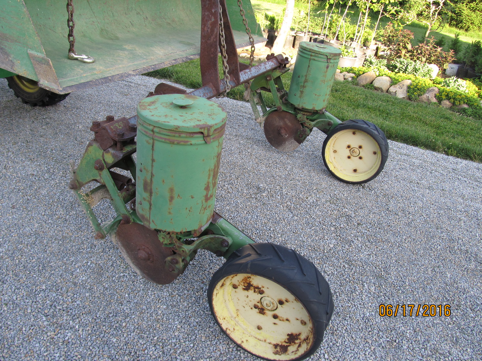

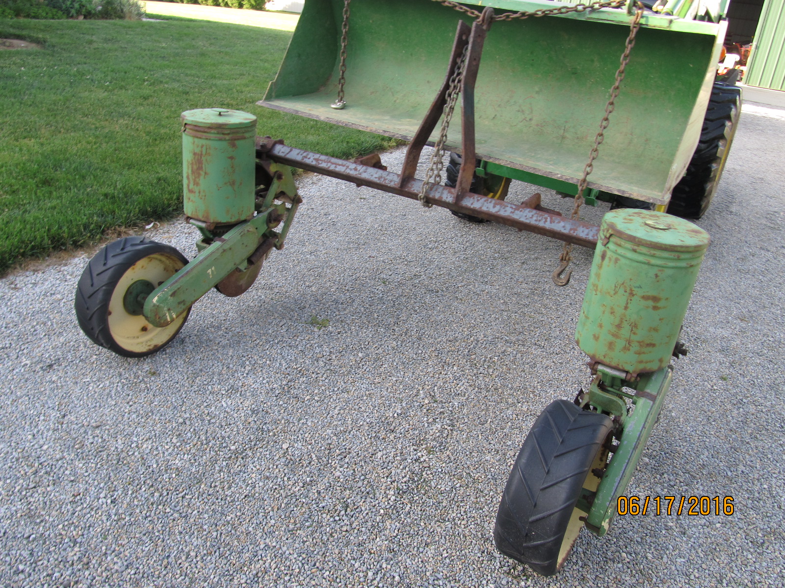

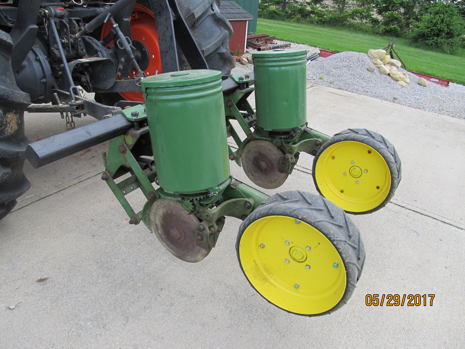

Here's a two row Deere 71 "flexi planter" I bought pretty cheap. The prior fellow converted it to plant pumpkins so some of the corn planter parts are missing. Plus it sat outside in Ohio for 10 years or so. I dragged it home, assessed the situation and things look pretty good.
I need new seed drop parts, need to clean it up and paint it. The parts are maybe $80 if I buy new plus I'll need a quart of paint. I also have to bondo a couple places on the seed containers. I have a new super duty pressure washer that I bet will blow most of the rust off so I'll just need to spray it green with yellow wheels. I'll spray oil on everything that moves and it will plant corn for the next 60 years. These things will never go out of style and command a pretty penny at auctions.

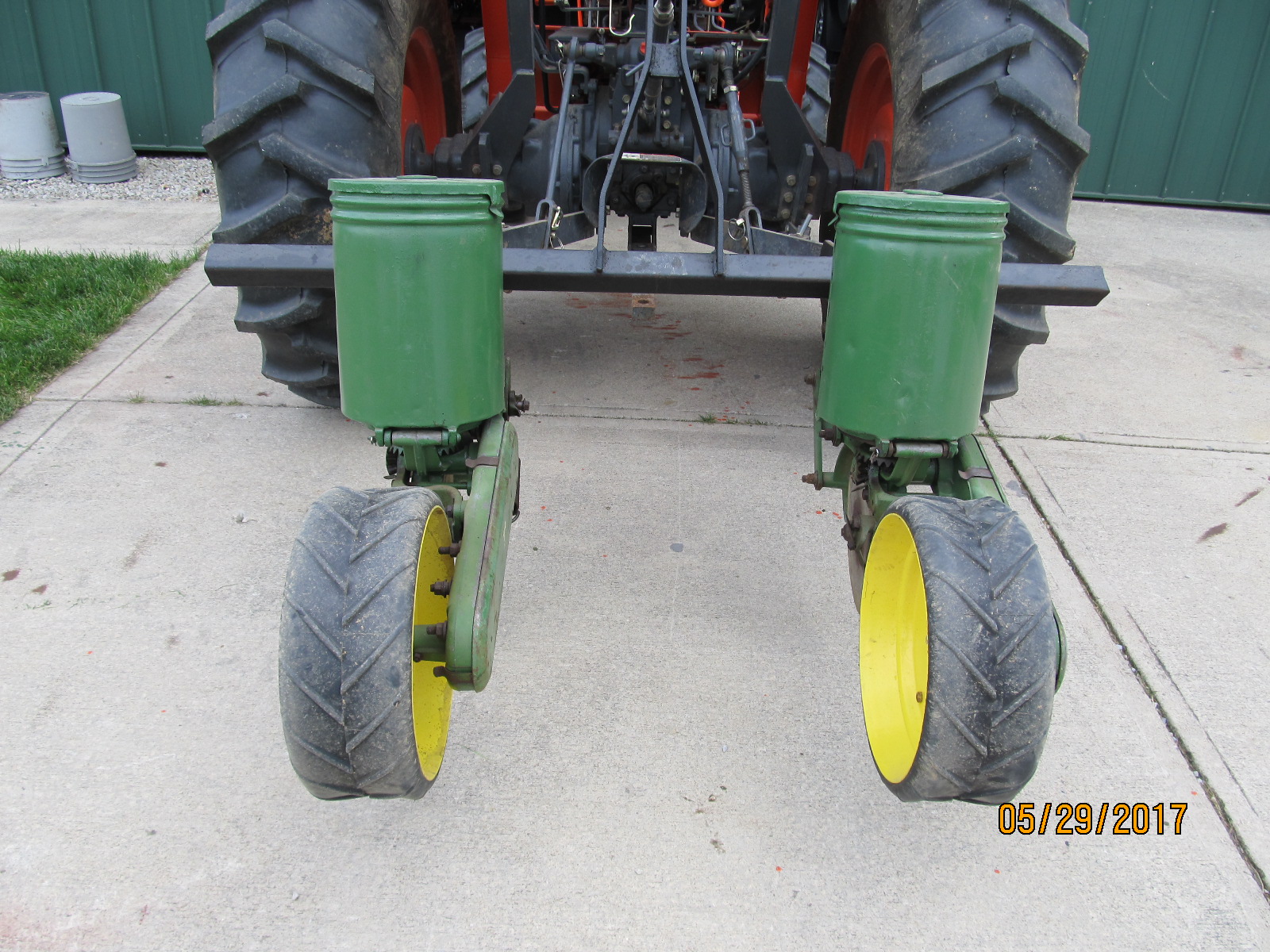

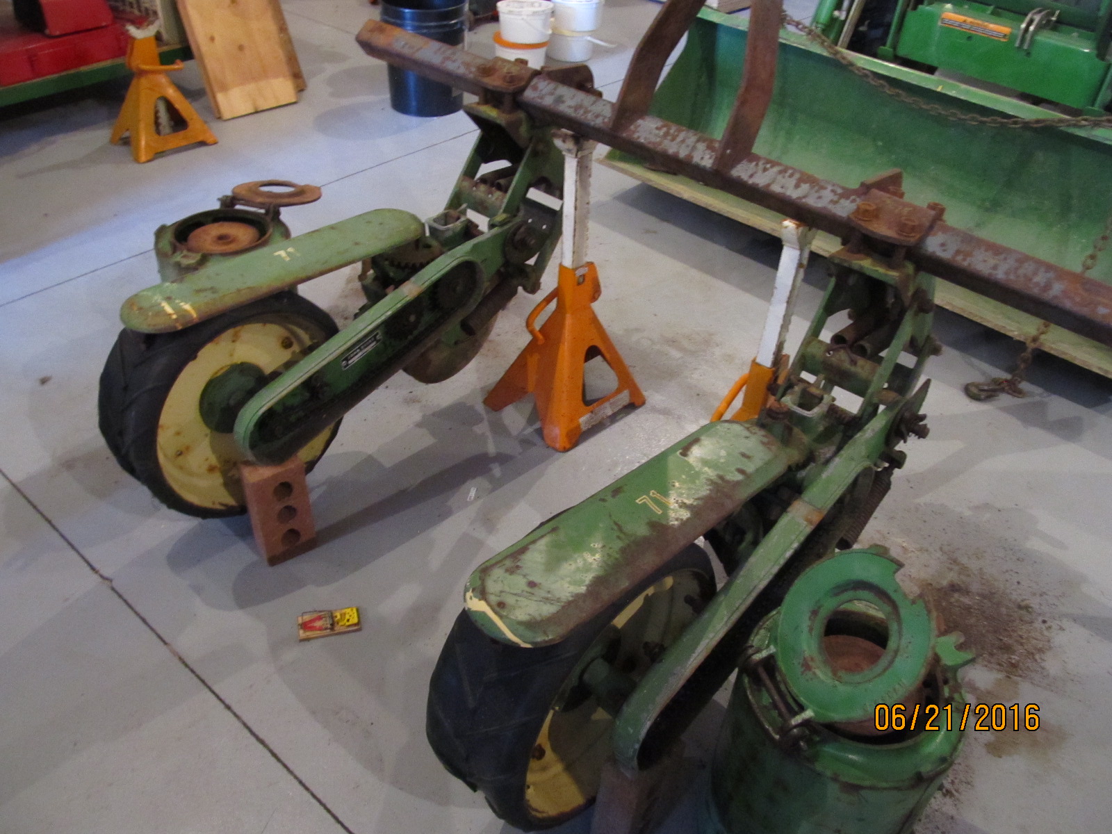

Here's a continuation of the above---post #64--- Deere 71 planter I bought and cleaned up. I had to take the planter portion of the units apart and get everything going again and the rust out. I sprayed the units with penetrating oil and just kept working things until they moved. Most everything did but I broke the bottom of one hopper an it took a few months to find one on EBAY.
I repainted the toolbar and the hoppers only. Anything more would have involved a complete disassembly that wasn't needed. I just sprayed the balance with oil and loosed up what I could. Here's the pic assembled and on my L4300 Kubota.

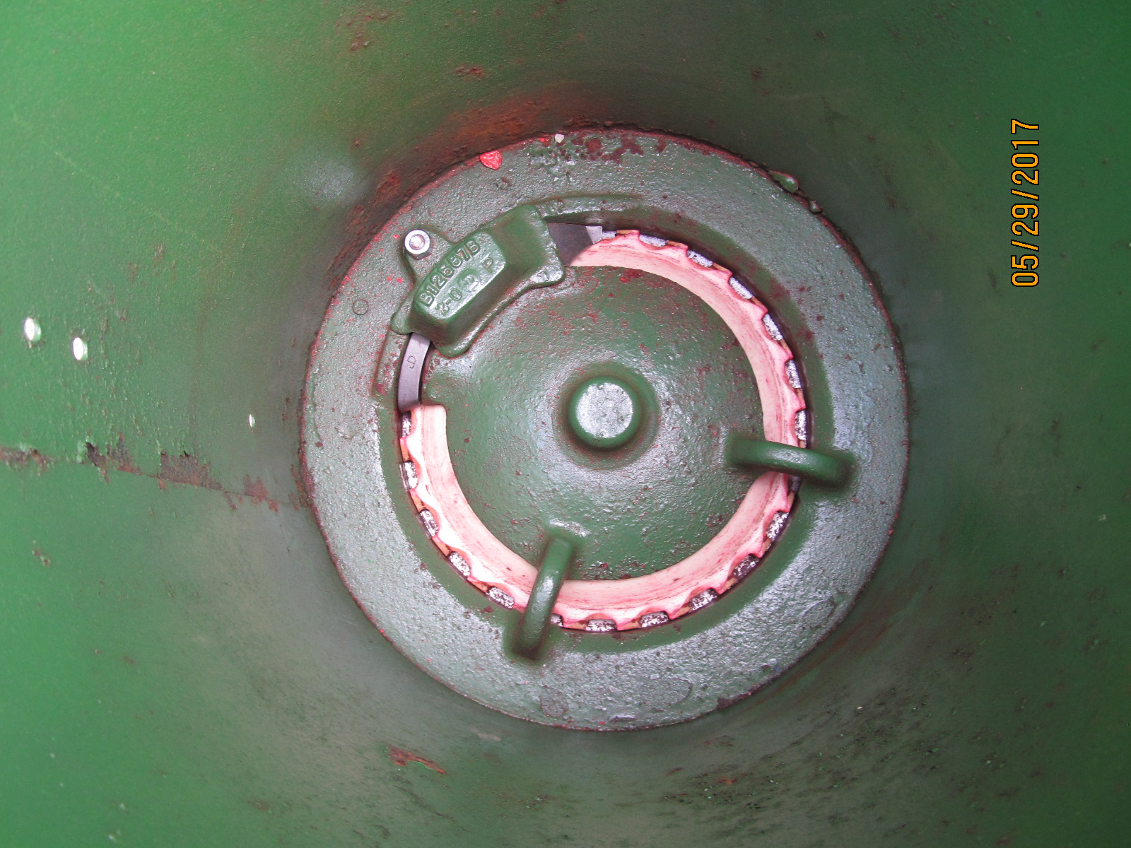

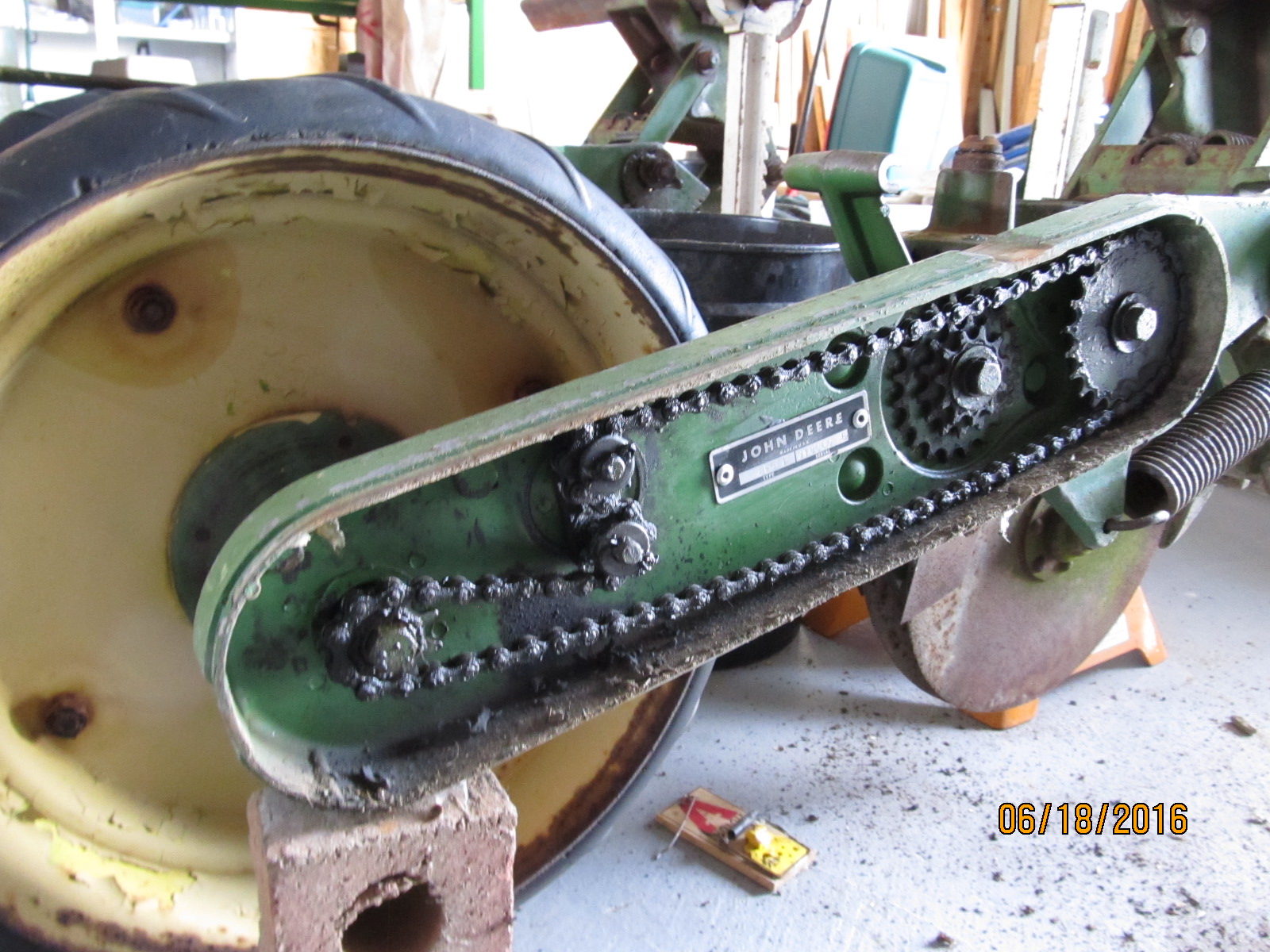

The heart of any planter is the planting unit and that's where things go wrong. So I replaced the planting seed drop parts in each unit. They are called "clickers' or "knockers' probably because they click as they knock the seed out. The sight below is a far cry from what I first saw. By the way, I took these pics after I had already planted my corn this year.
This is how simple Deere --or International--unit planters are. Nothing to them.

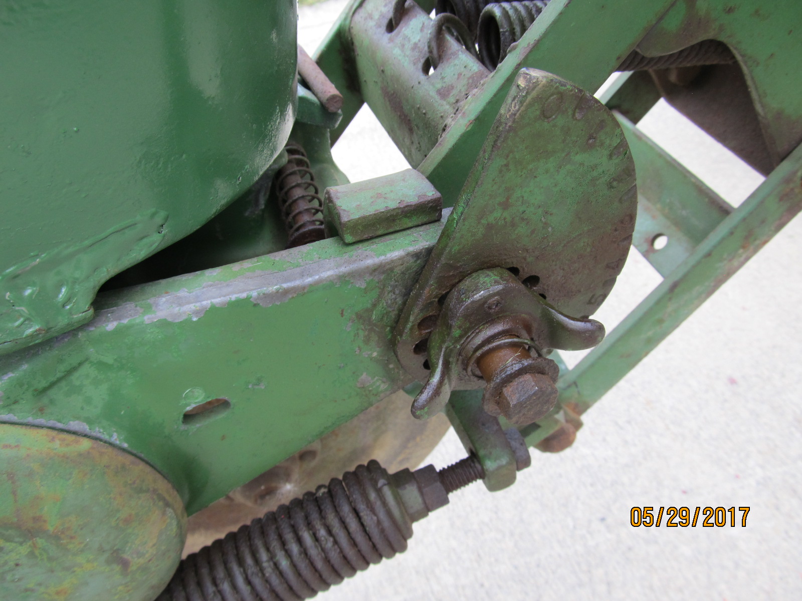

Things like the depth adjusting gauge, or whatever it's called, often rust up and this did as well. Spray oil and some time to work things back and forth and good as new again.

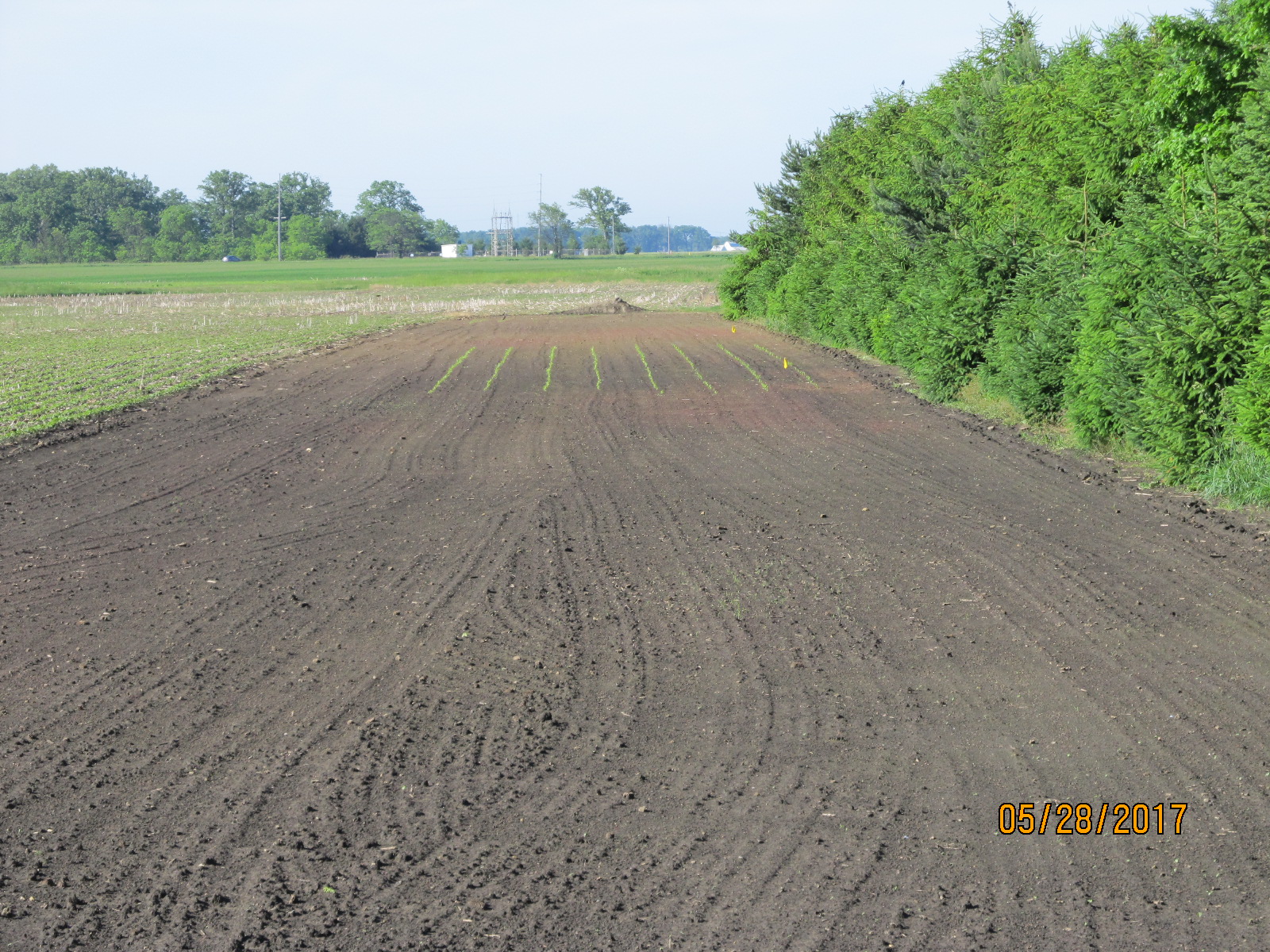

This is a telephoto shot of the corn I planted and it looks great despite maybe 3" to 4" or more of rain last week. We were swamped but I still got an acceptable stand of sweet corn. I'm going to plant some more this week just to make sure everything works and then find a couple of decals for the back of the hoppers. They look naked without the leaping Deere.
For a little patience and elbow grease I now have a great two row planter for not much money and it does a fine job. Now to advertise my old IH 295 planter for sale.
