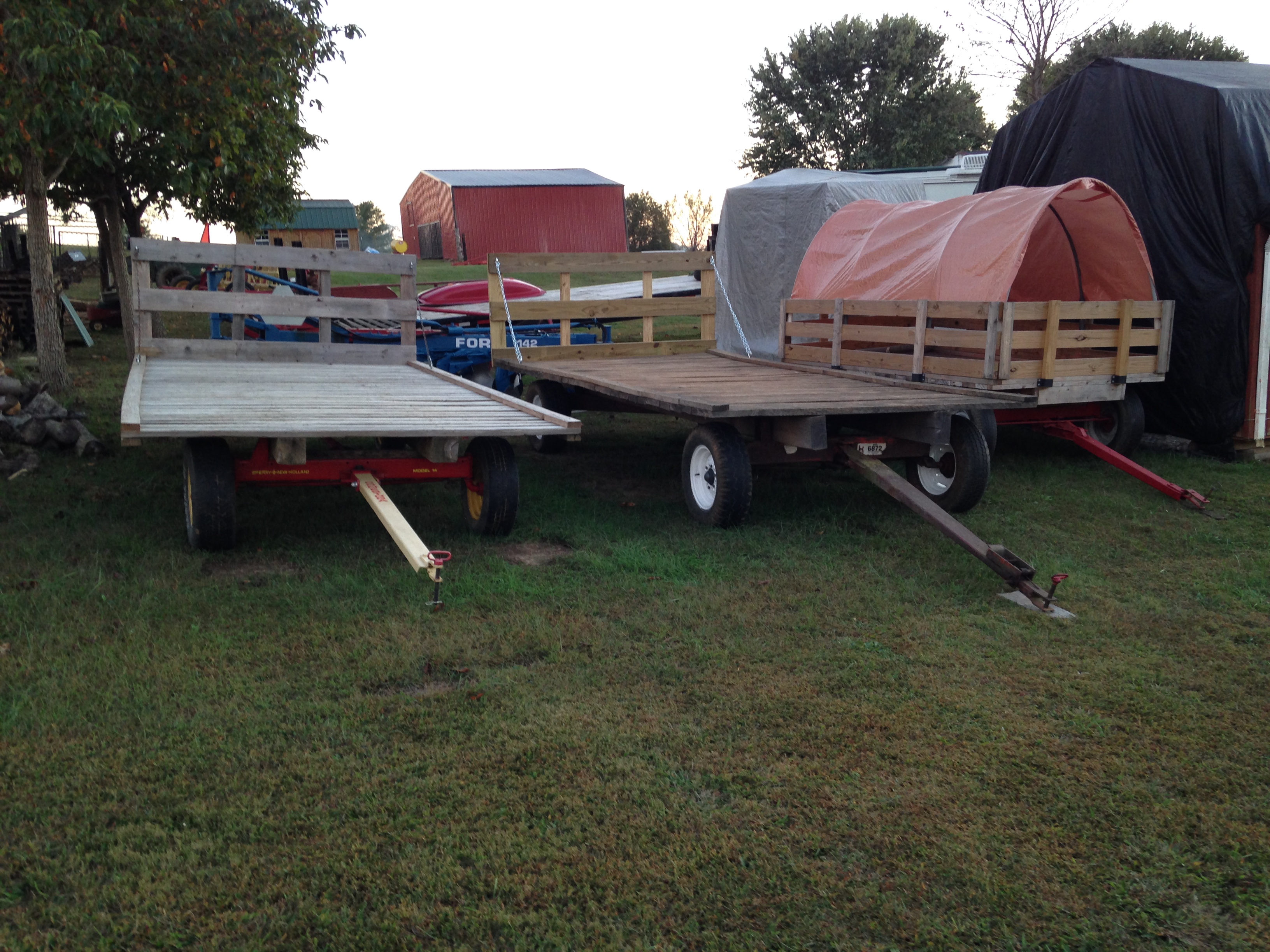

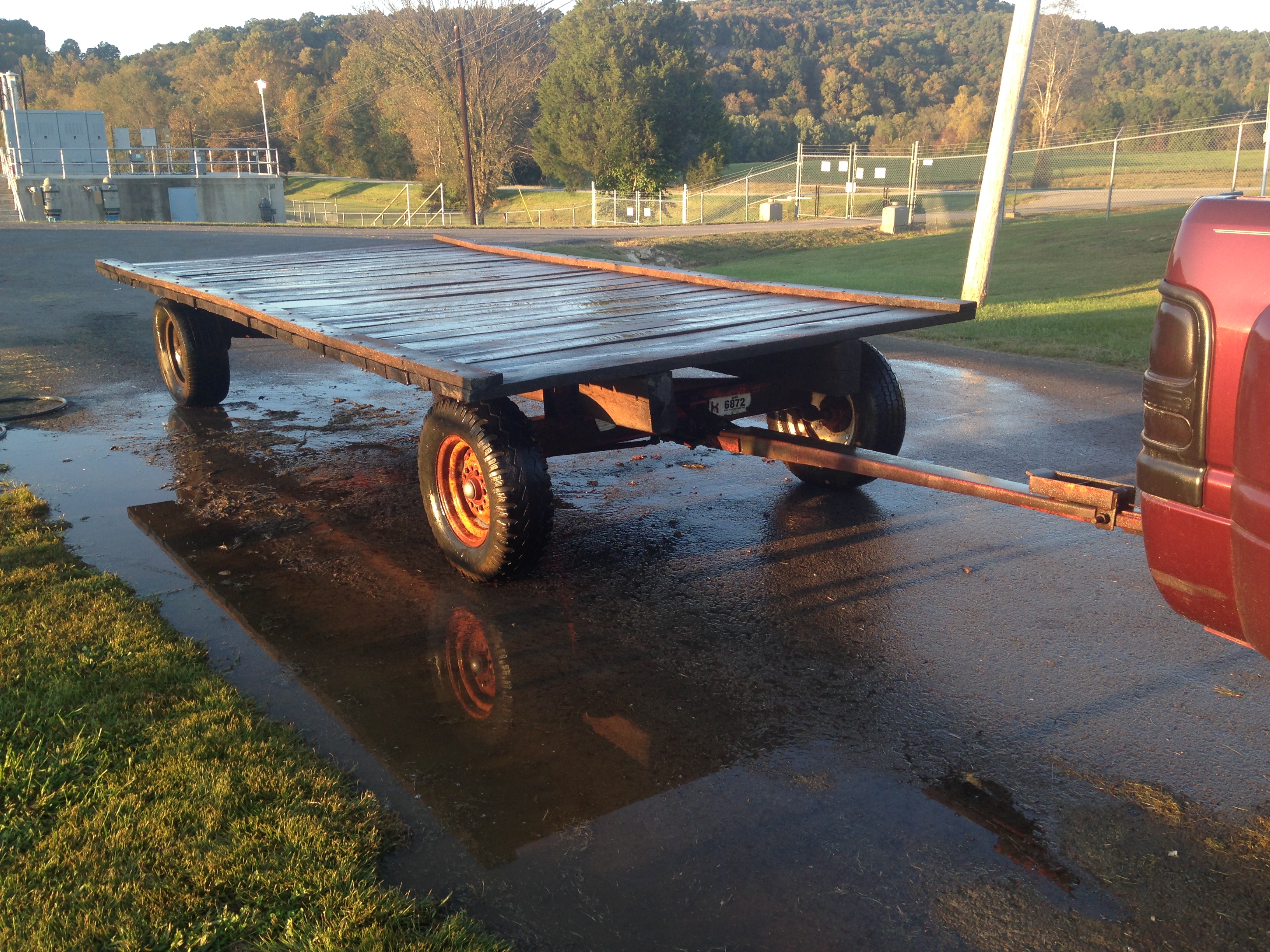

Sorry to take so long to answer sixdogs but, I used Gloss white same as the front and rear Rim's and Grill to tie it all together. Here's my latest restore a 16' 8-Ton Kory wagon. My father housed tobacco on this wagon many years ago it belonged to a friend a few miles away. He put a new floor and runner's on it 5 years ago. But while hauling a load of tobacco a wheel bearing went out and it sat in a barn under a tarp till i bought it form him. I replaced and/or re-greased all the bearing's, sanded, primered, painted and built a new rear gate. It was well taken care of so it was a pretty easy task. All that remains is the Decals i picked up today to be finished and new flotation tire's.

Looks good and Kory is a nice wagon to restore. On the wheel bearings, I always replace all if needed, clean and regrease. Bearings are so cheap it isn't worth the time to clean the old ones. New or greased bearings make me feel better.

Yeah Sixdogs the previous owner replaced both inner and outer bearings, seals and race on the right side. But, when i was taking the wheels off to paint it they were really hard to spin. He had run the lock nut all the way up and also used regular grease. So i took them out cleaned and re-greased with bearing grease properly tightened them now they all spin perfect. The way it pulled coming home the day i bought it i was surprised they were that tight glad i didn't live but, a mile or two away could have ruined the new bearings or worse.

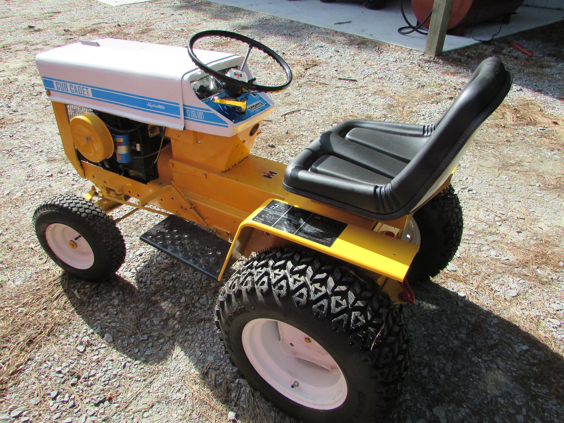

I'll dig for some pics, have done this for awhile on small equipment, just a play farmer, not a real one like many of you on this thread.
Particularly those whose plowshares gleam from active use.
Personally, I just hate rust. Don't want termites in my wood or rust on my metal.

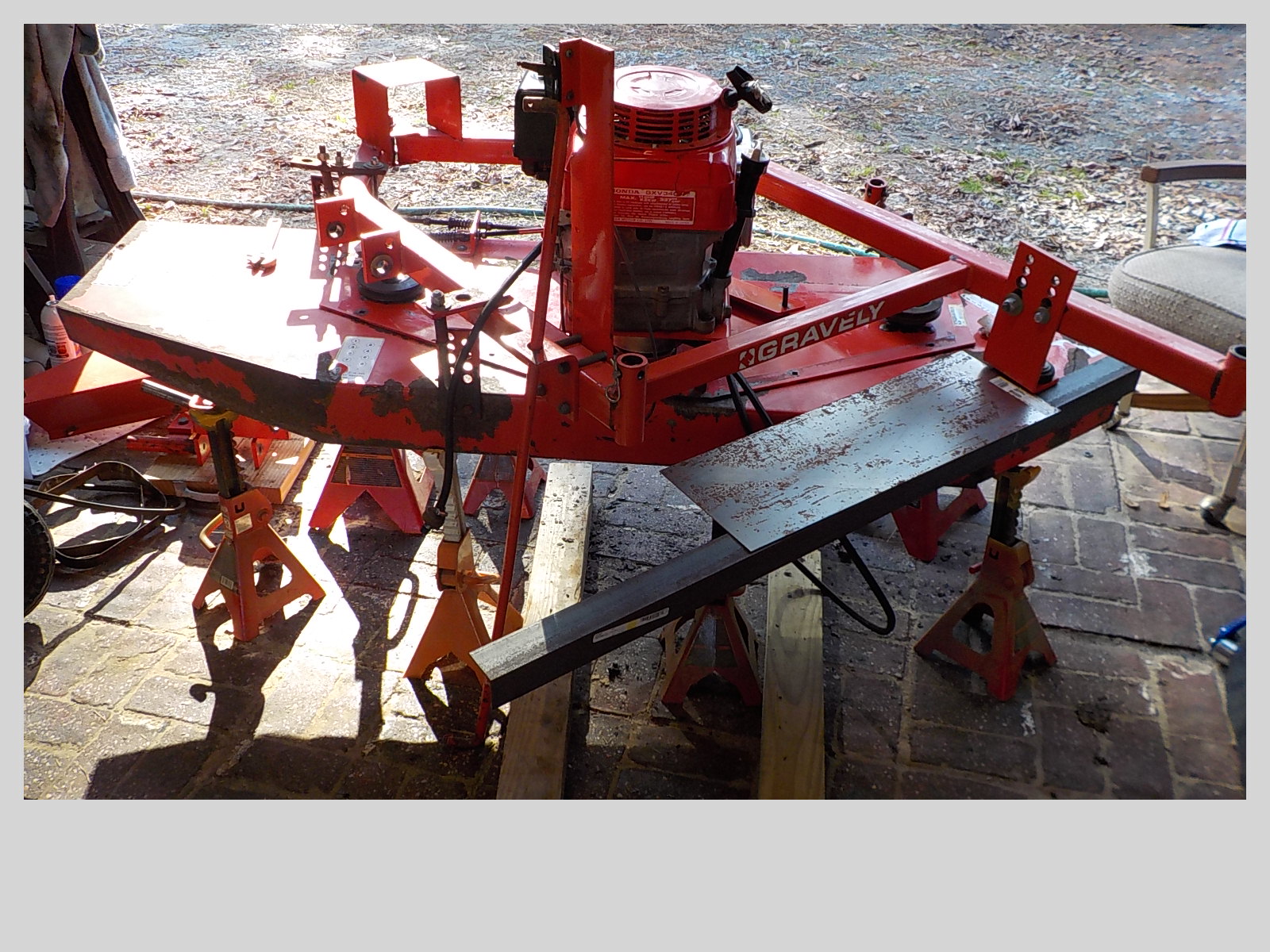

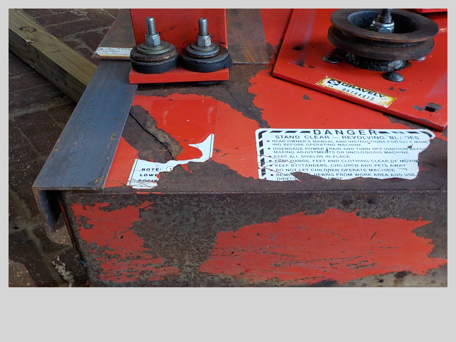

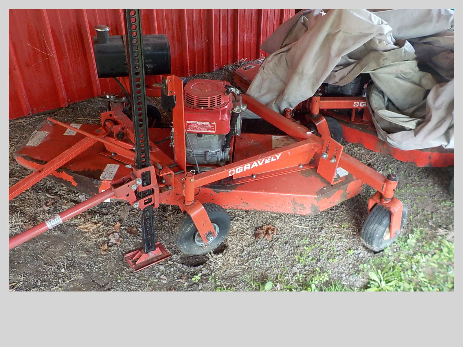

Am working on a rather rare Gravely wing mower right now. Thread in the Gravely/Ariens section.
Still unbolting and nowhere near refinishing. First I have to learn how to weld. In no rush, have two of these wing mowers, and will do
each one in my spare time. Which I now have plenty of, but my barn isn't heated, except for the wood shop, so when it gets below 50, with my arthritis, I have to wait. And for sure, outside painting, have screwed up way too many paint jobs when the air was 70 and the steel was 55 due to overnight temps. And you know what happens when drying paint is too cold...so now I IR temp gun all metal before I paint.

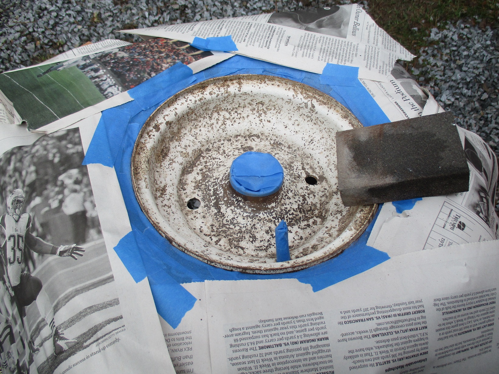

recent projects included a 1968 IH CC 125. And we could have a whole thread on the different ways to paint wheels. I'm an old blue tape guy
but I know others have different methods that work too. And decal issues apply to everyone. Do you really need to replace ALL of them?...

daugen--two comments from me. On painting wheels, I no longer mask them. It takes too long and doesn't work anyway. Instead, I use a HVLP Harbor Freight gravity sprayer and carefully paint the wheel. It will leave the edge of the rim unpainted. I paint that with a brush and no one has ever known the difference. if a whisker of overspray gets on the tires, remove with solvent. If you get any more than a very minor wisp of spray on the tires, you are doing it wrong.
On painting in the cold, the real answer is don't do it. But, I once had to paint at 40 degrees. What I learned was that the PAINT has to be the same temp as what you are painting to make it work. I thinned with acetone--a lot if I recall and sprayed away. It wasn't the best job ever but it wasn't bad either. As well, I did not use cr@p farm store paint but rather quality OEM Kubota acrylic enamel paint. No one ever knew by looking that I painted the items--big wheels and weights--that cold.
