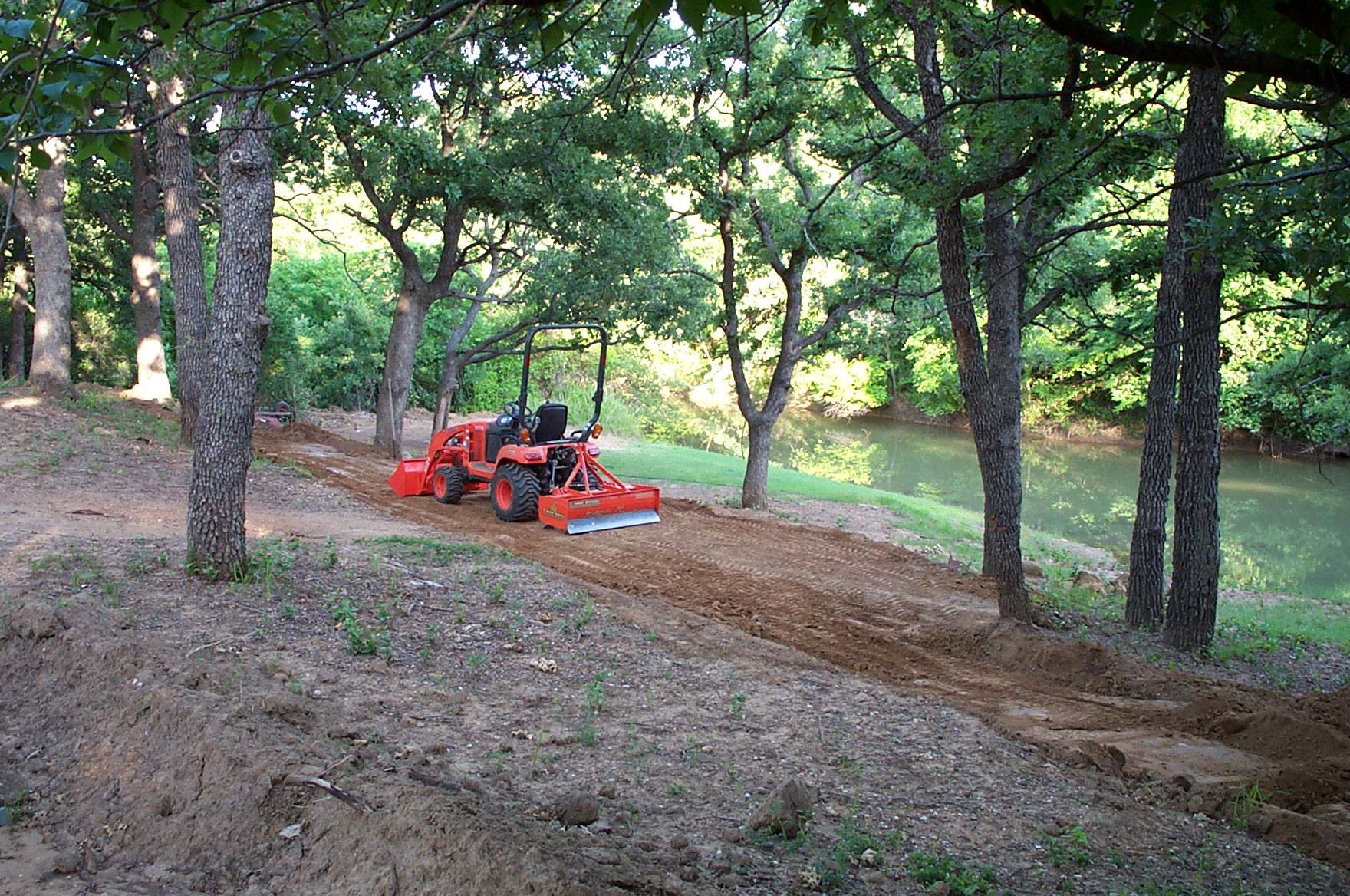

Thanks guys. I think I will do the blocks. I will get to free up some time during the summer when my wife is off(teacher) and she will watch the little one(17months) in the mornings before work. I start work at noon, so that can give me three hours every morning or so.
My plan is to pull some of the big rocks out, as they will serve well in the landscaping. The three big guys are rouchly 4'x2'x3'. The BX couldn't lift them, so i dragged and pushed them into position. Otherwise I will clean up the lower portion of the wall to dig a trench and set the first course below grade. The block I saw have the rear cleat, so I hope that's enough to hold. Not really crazy about pouring concrete, but I bet it's an easy way to set that first course level. I figure it would be a little under 2 yard, so I would probably form out any other concrete work that I want to redo and have one of those mix on the spot guys to come.
