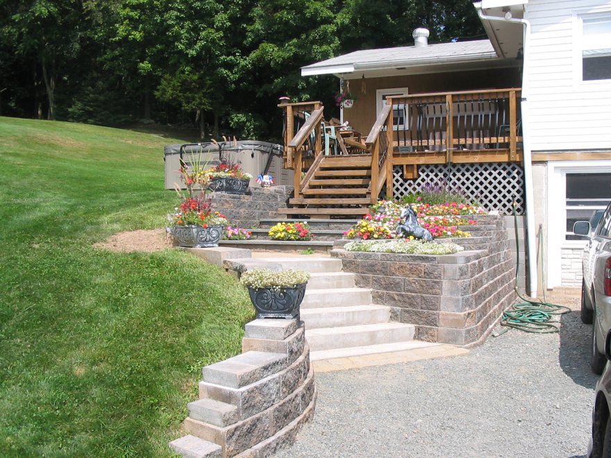

Gizmo2, don't kid yourself ....that looks really nice !
I had hope for using a similar block, but I'm cheap and went with a lower cost system.
The corners and steps 'bout ate my lunch, yours look clean ....Good job !

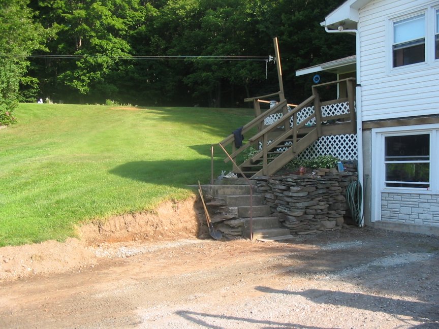

Thanks BX, Took us about 3 days to do the one corner cut block, put up, take down, cut more block, put up, take down I guess you already know. I sent a picture of the wall and steps before it was finished to Anchor Block (manufacture of the block) and asked for two hats, one for me and one for my wife. They sent me all kinds of stuff, including two hats. A year later the picture showed up in one of their brochures. I know what it took for me and my wife to complete our wall and I cannot imagine the work that went into yours. Doing a wall like ours at 53 years old really kicked our butts. The block weigh in at about 75 lbs per. One thing that touches me is the fact that you refer to your project as "The Wall" as we did. People would ask what I have been up to and I would say, working on The Wall.
Before

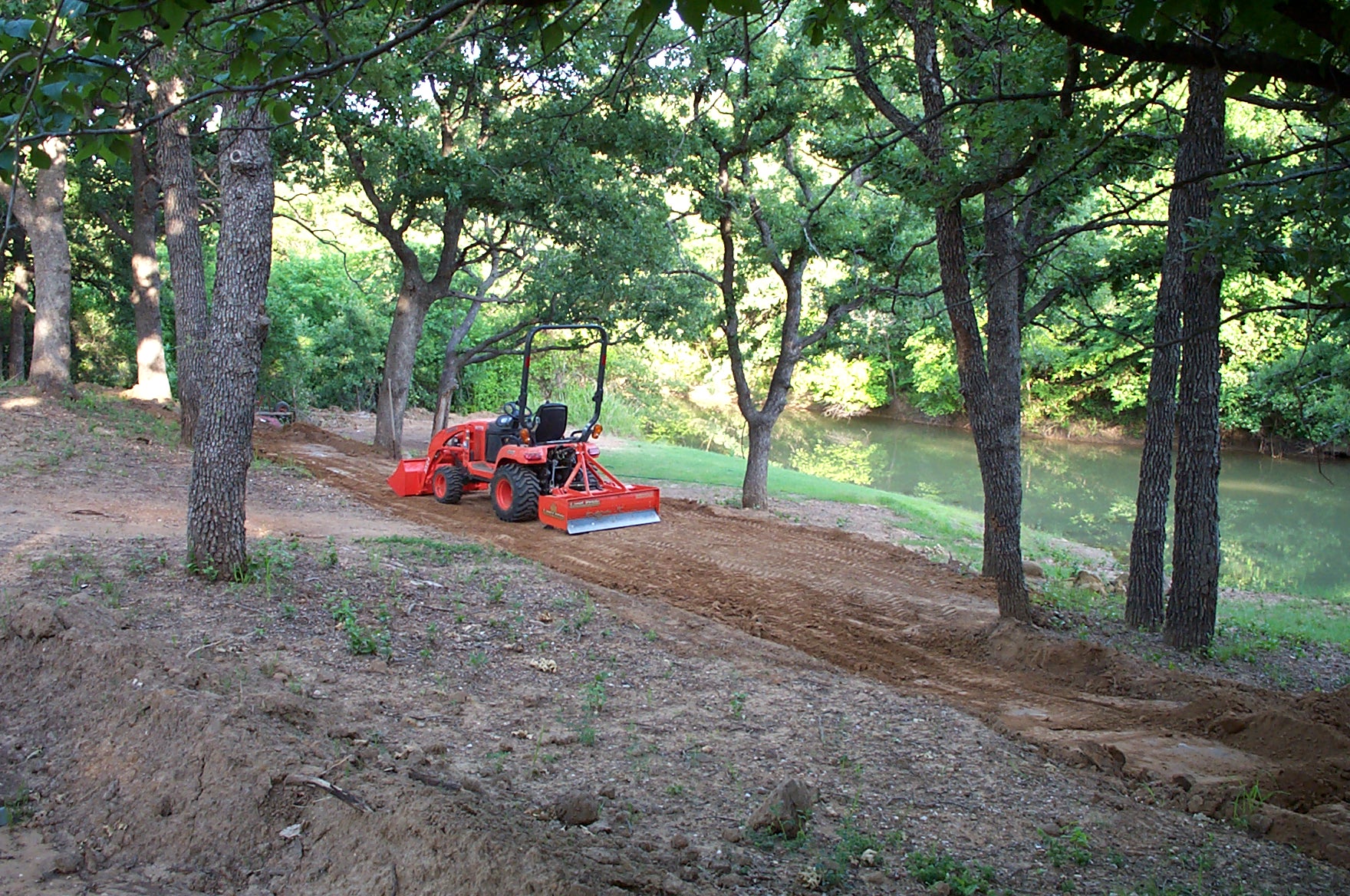

So the whole thing with the BX? I think I remember a backhoe?
So what was your dirt cutting techniques, especially with the slope.
It is really impressive work, especially considering you did it yourself. I am not sure I am capable of such a project, although I dream of it. I would be too impatient to take all summer.... Product of the instant gratification generation I guess....
Yep, just me and little 'ol BX spent from mid May to end of November. Let me tell ya, after getting the upper wall done, I wasn't feeling that ambitious anymore :eek:, but there weren't no stopping now, I was committed. I think another 3 or 4 of weekends and I'll be able to say "Mission Accomplished"
I had an narrow area on one end that was somewhat level, at least level enough that I could get the BX turned across the slope without fear of tipping over.
Once I got the BX positioned I used the box blade (moving in reverse) to cut off a little at a time and piled the spoils on the downhill side building up a larger area where I could safely maneuver the BX ... kept working across the slope till I reach the other end. After that, I could work in either direction and benefit from the box blades scarifiers to break the hard ground loose. The level area I created with the spoils ended up extending out about 15', which gave ample room to maneuver as I continued to scrape dirt until I had it to the grade I needed. The backhoe's role was mostly for straightening up the area that established the walls' boundary. On the lower tier it looks like I really dug into the existing ground a good depth with the backhoe, but in reality that is mostly the excess dirt from my scraping technique.

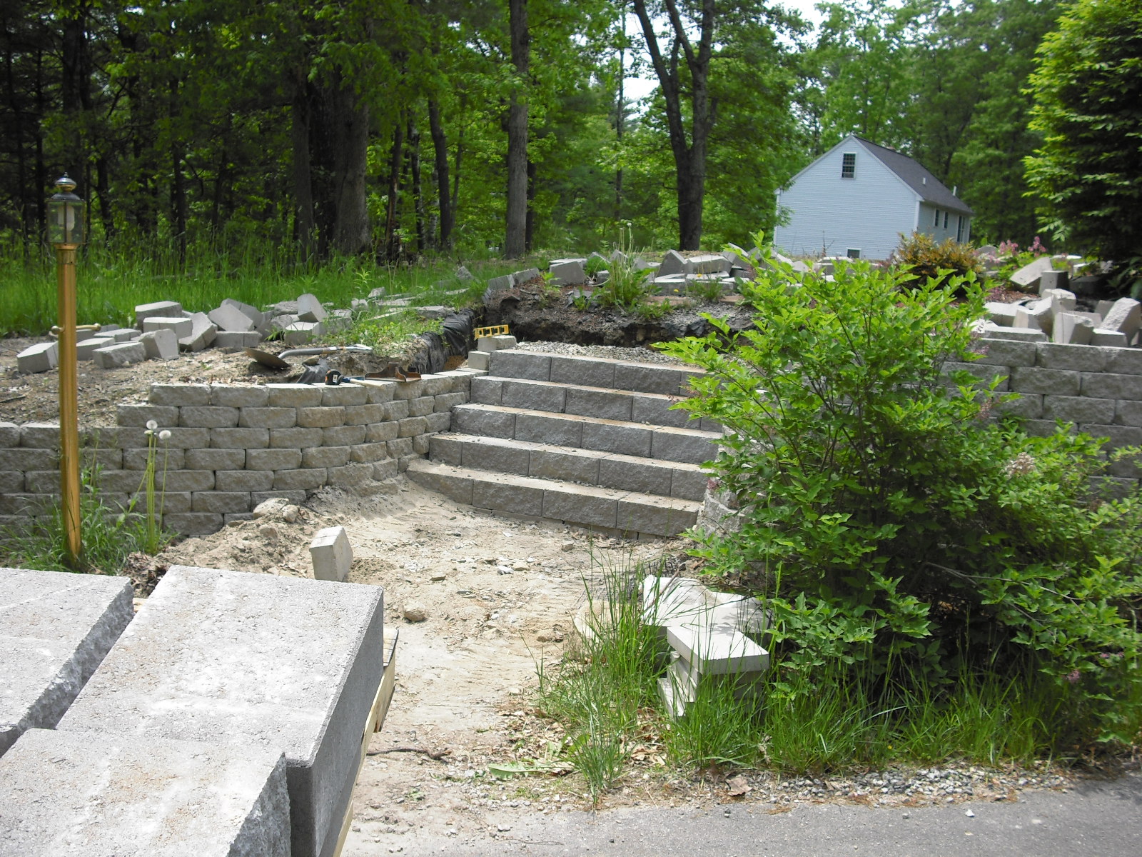

I used a little over 900 blocks @ $4.62 ea. and 200 caps @ $3.82 ea.
I can't say that I got any discount for volume but the price is about what I expected if not a bit less.
The blocks Anchor Brighton Stone came from Pavestone Company and I had my local lumberyard order them for me.
They weren't the block I really wanted to use, but they were more than a dollar cheaper.... plus my guy let me store them at his yard and would load me 2 pallets on my trailer every weekend (while I was at work). Beside the price difference, the blocks I first wanted covered less area, which meant more blocks, higher price.:eek:
I thinks these look just fine ;)
Were these blocks about 74 lbs each and the caps a bit heavier? They look like the same blocks I used for a retaining all. It nearly makes my back sore to look at the wall I built.
Good job, hope it lasts forever.
Pat

Very nice wall BX, what part of Texas is this? Kinda looks like the Frio River behind you where I learned to swim. Hope those blocks don't swim down stream when that river rises. :(
/ Retaining wall
#28
Quite a ways from your 'ol swimming hole ..... Lake Nocona in Montague County, just below the Texas/Oklahoma border (Red River).
patrick_g, these blocks are 52 lbs .... caps are less.

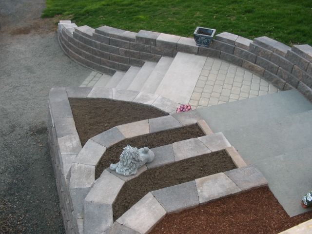

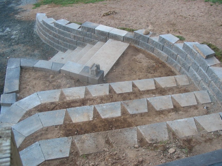

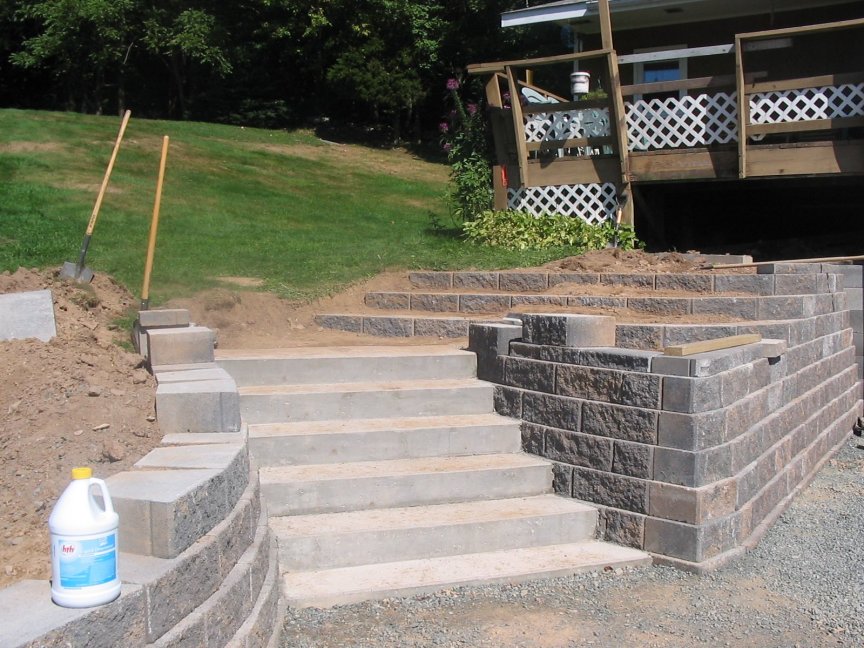

Fell on this thread, I spen the day installing steps (7, I think I'll add one more, the picture is at 5 or 6) in my retaining wall.
The wall is between 4.5 and 3 foot, I used 4 inch block (cheap and available at HD) for the wall and 8 inch step blocks (100lbs each) for the steps.
I used geogrid half way up the call on the 4.5 foot sections, weathered an intense winter without budging, I've got at least 6 inches of crushed stone under and behind everything with landscape fabric behind the crushed stone.
I went through somewhere around 1000 blocks plus.
This was the project where I brought home three pallets of block in my tri-axle, with one pallet being solid block and I ripped the trailer hitch off of my truck trying to back up into the driveway.
I now do a pallet at a time in the bed of my F250.
Here's a picture of the steps in progress and my homemade forks with around 1100 lbs on them.
Will be great when this project is done.
Joel

I have to say I cheated on my steps, poured the concrete. I could not get the step blocks as level as I wanted. Found out later I should have poured a level concrete floor for the steps and then stacked the blocks on that. I had blue stone cut to fit for the top 3 steps. A topic like this is good just a little late for me. The "WALL" topic. Between BX Tex and JoelD I am looking more the rookie by each post.:eek:
/ Retaining wall #33
Gizmo, you've got it nailed, mine looks amaturish compared.
I thought about pouring, bit I think in the long run, with enough crushed stone it was just easier using the block.
You did an amazing job at laying your work out.
Really looks nice, there is no comparison to what was there originally.
Congratulations on a job your future generations will continue to get enjoyment from.
Joel

JoelD, make sure you post pictures of the finished project. I've got two pallets of step blocks sitting here collecting dust and I would have much rather had the steps you and BX have. I also wanted to have blue stone where I have the cobblestone but the guy wanted $600.00 for the custom cut triangular piece and that was over budget.

It took me almost as long to build my steps as it did for the straight run on the walls. Might have been better if I'd used a block specifically for steps, but doubt that it would have easy.
You guys' did a fantastic job !
