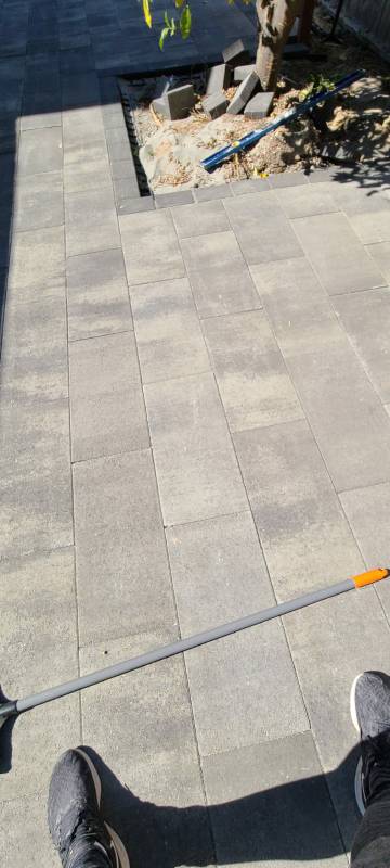

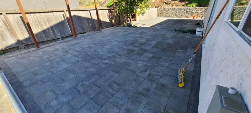

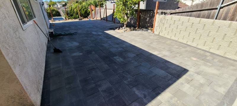

I think the patio is... done. Lighting isn't that good in the sun today but the poly sand is in and we're moving on to the fence next week. IMG-20210206-WA0005.jpegIMG-20210206-WA0004.jpegIMG-20210206-WA0002.jpeg

Lesson learned: these 12x24 pavers do NOT like to be tamped. We broke about 12 pavers while compacting due to any minor uneven spots in the sand base.
   / Retaining walls and patio #185
that's why I like the 4 x 8 pavers. You can vibrate the heck out of them.
   / Retaining walls and patio #186
I've never installed them that big. Looks like they would cover a lot of ground quickly!!!

Yes but they're really heavy and as we learned, not as forgiving.
   / Retaining walls and patio #188
Wish you spoke up sooner. Concrete piling gets driven wearing plywood hat. Same idea works on pavers.
Saw picture of new TBN fence truck, looks good.
#189
Was thinking of that... we just compacted once, paid our dues, and threw the sand down.

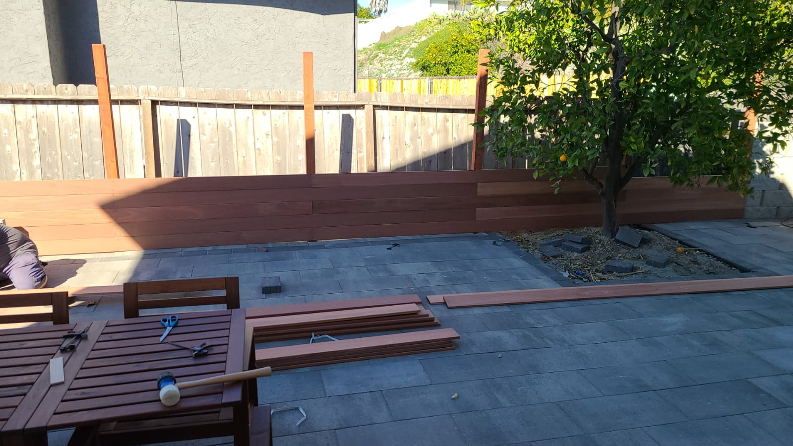

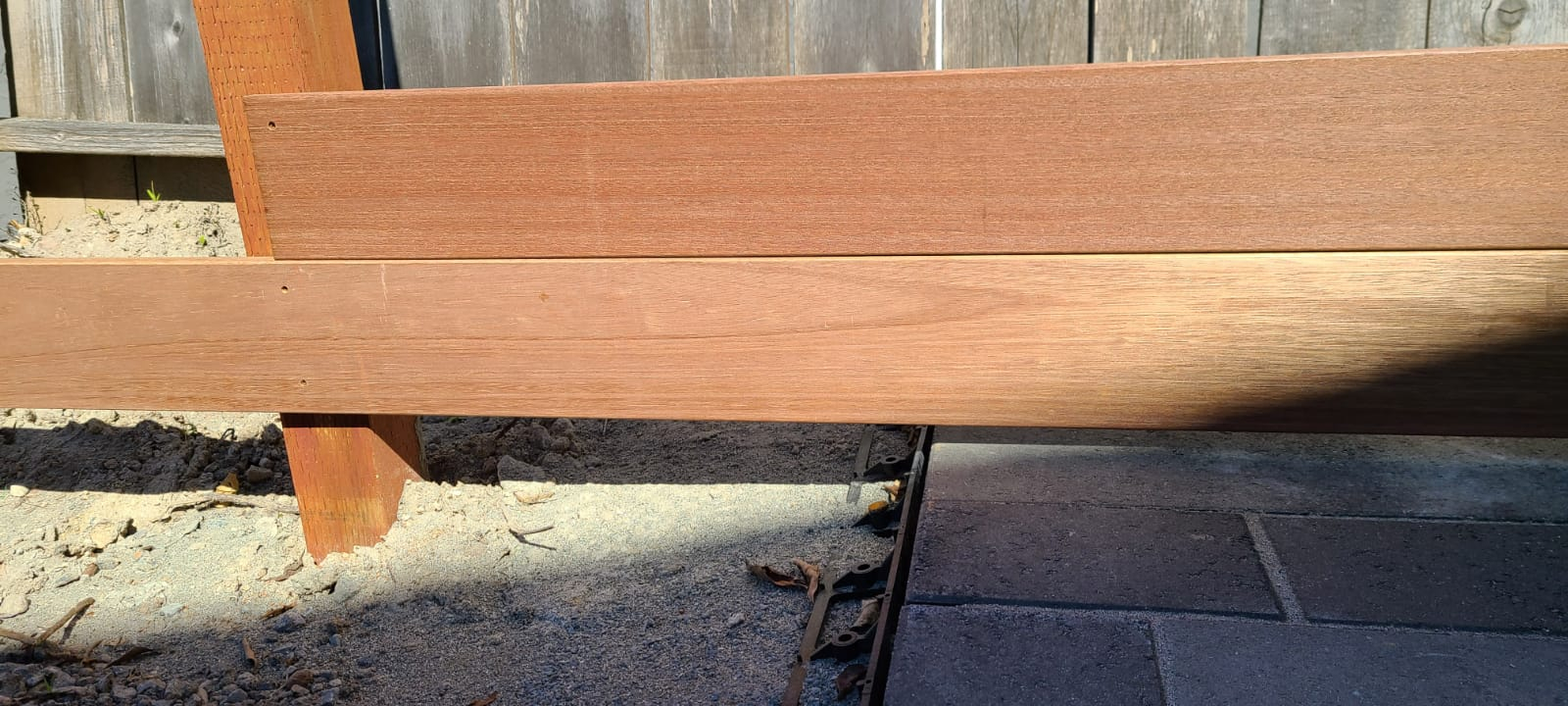

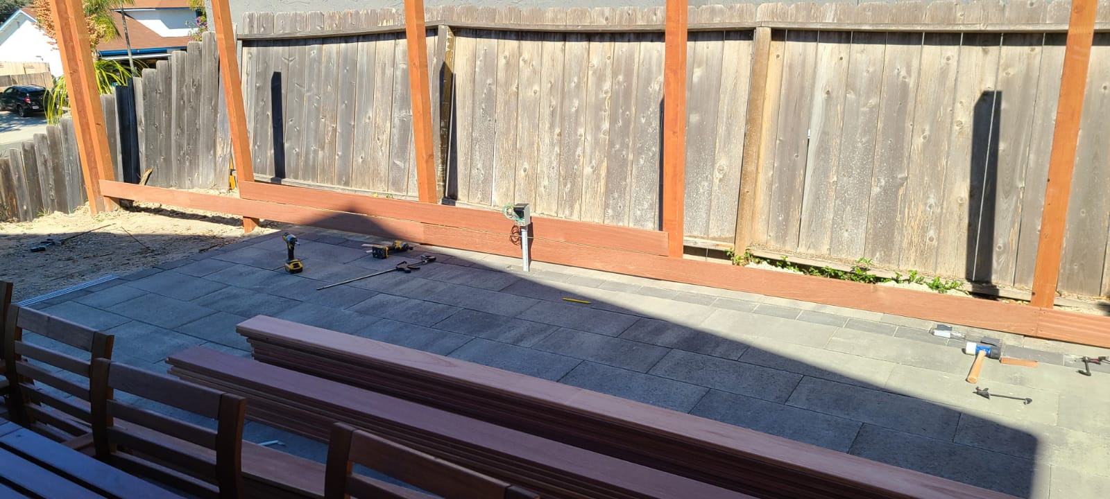

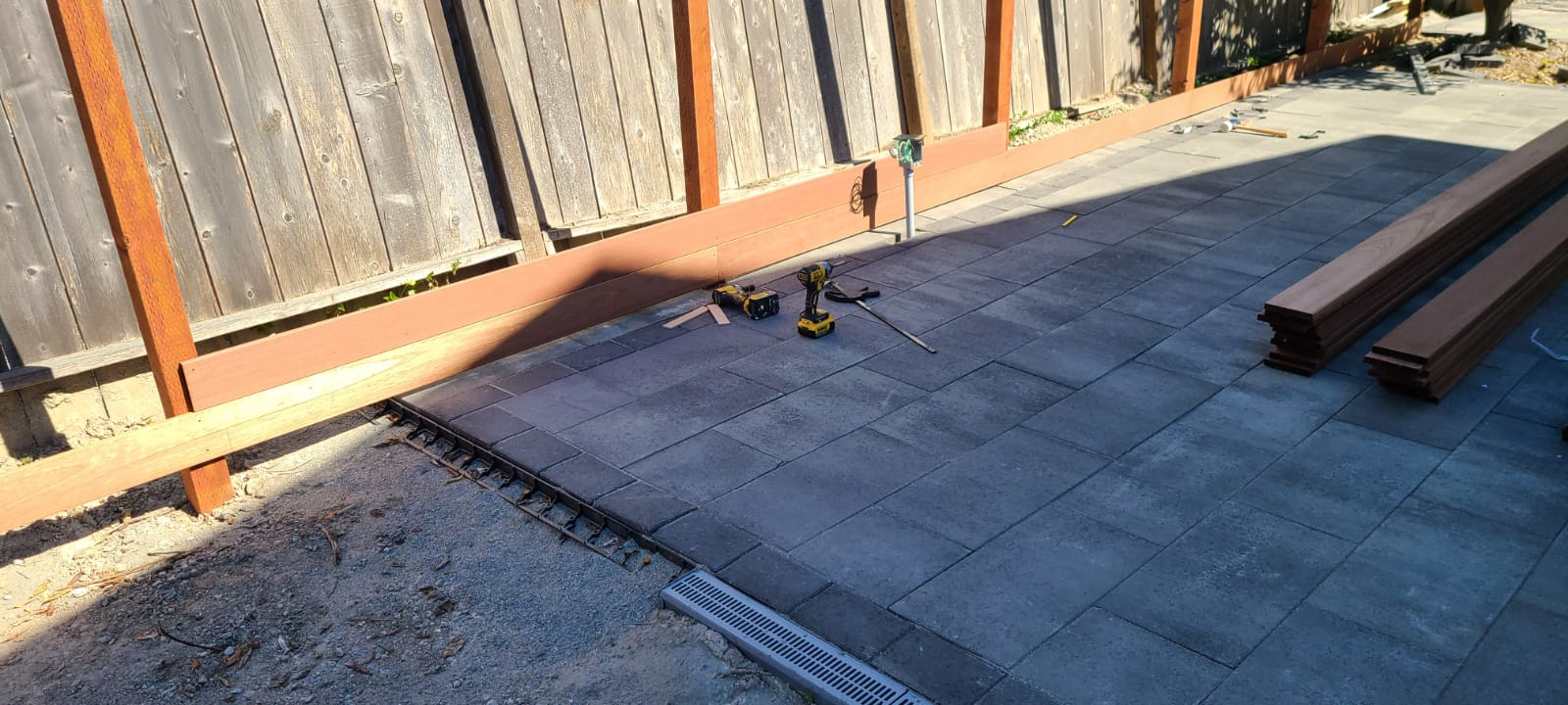

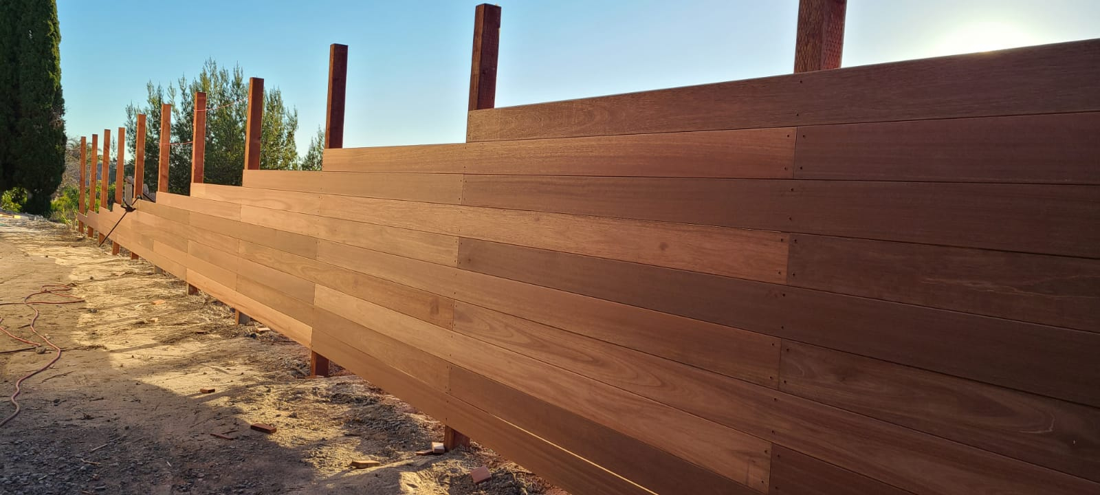

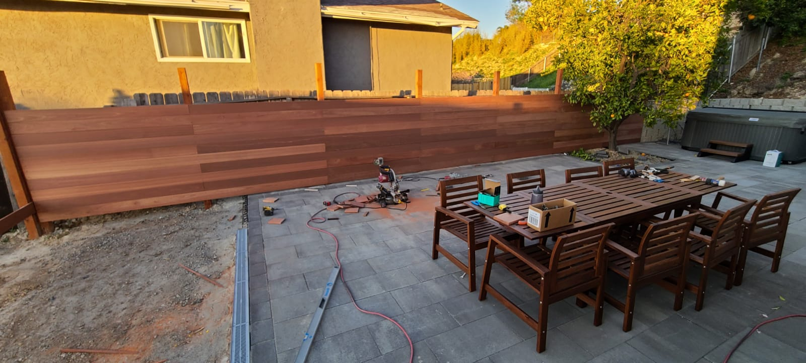

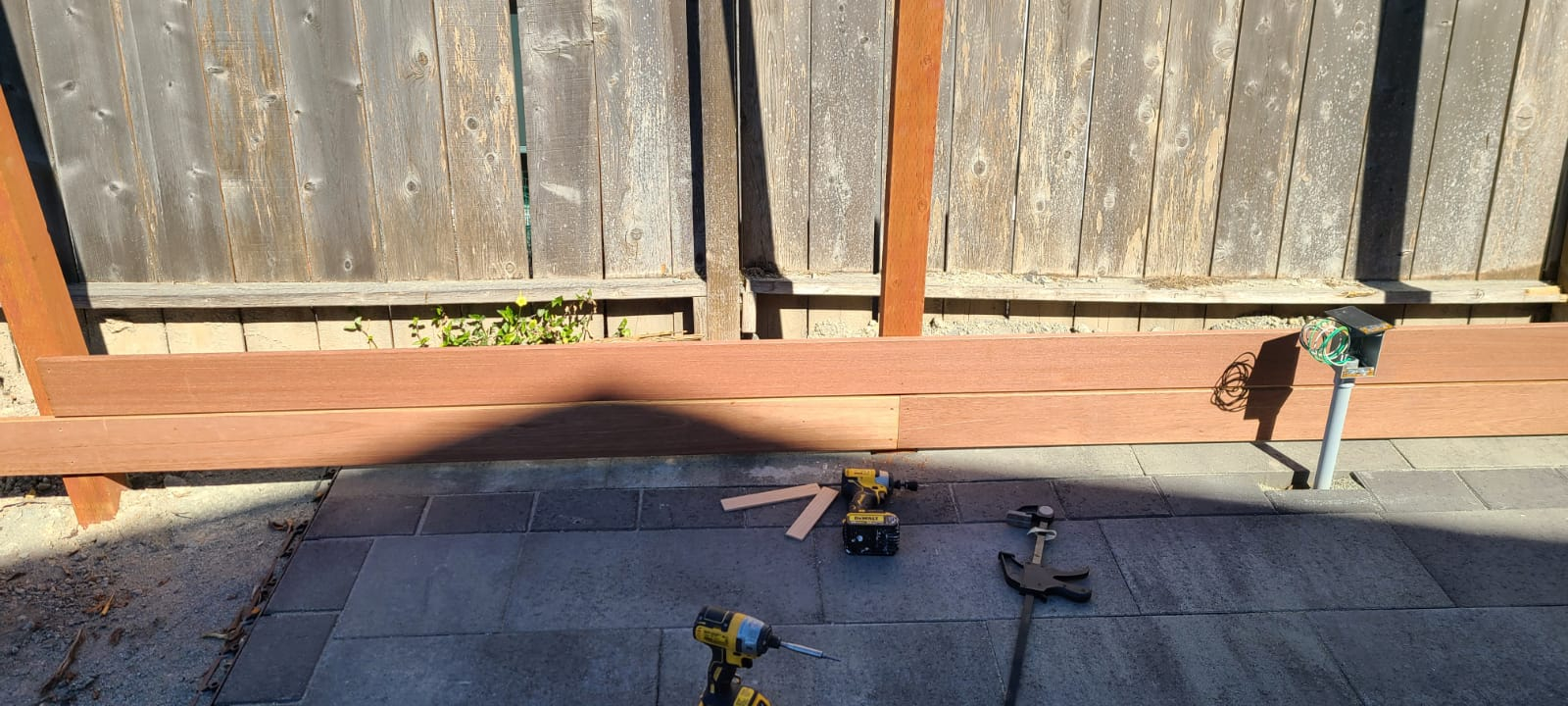

Though I ignored the thread, this project has continued. Now in its second year.

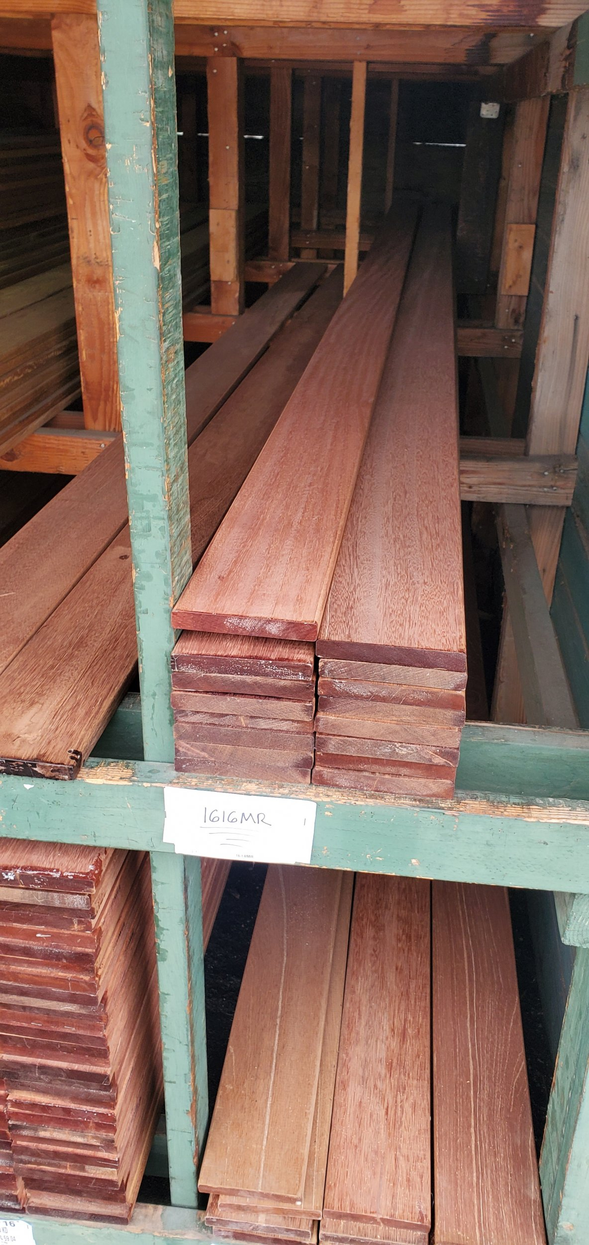

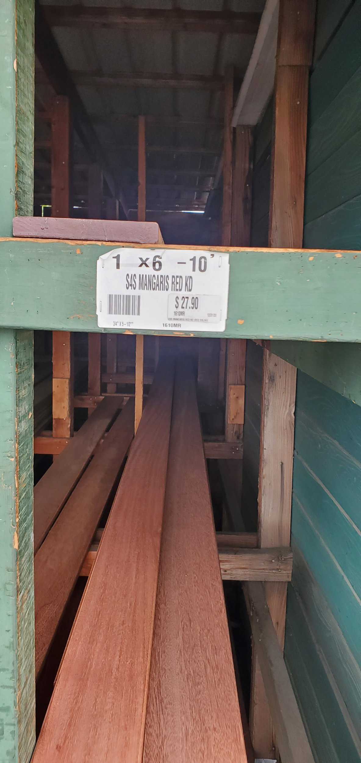

Last update had the pavers down and since then the only completed task was the fence. We used 1x6 mangaris, and a lot of it. Turned out really nice. Lumber costs had not skyrocketed so it wasn't really too crazy compared to redwood. But supply was limited and we bought out the local supplier who had just barely enough to get the fence done
