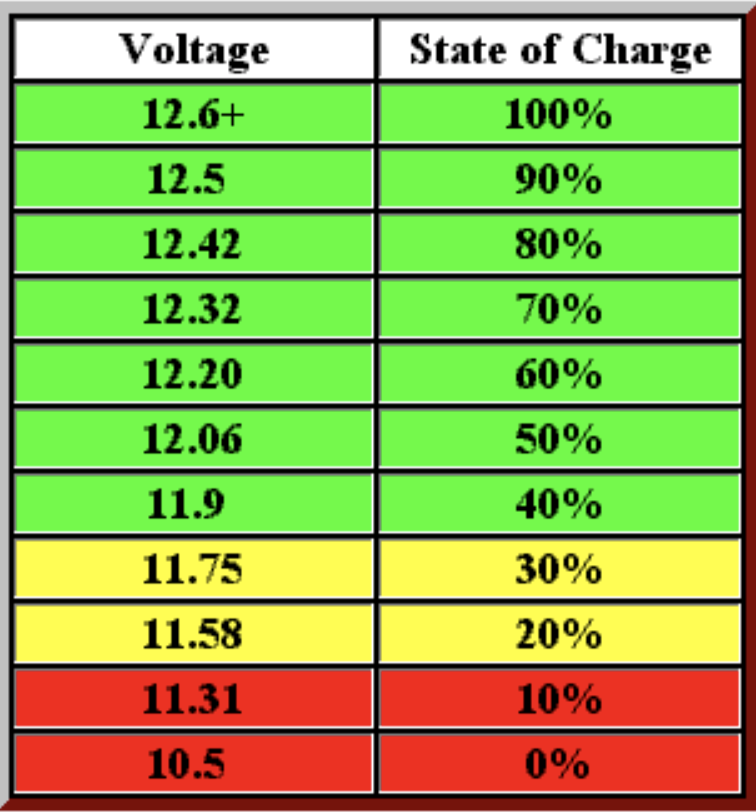

They’re tryin to tell me 12V and 700CCA on a 900CCA battery is considered “good”.
When the tractor is not running, I see 12V.
When the tractor is (jump) started, I see 12.7 then 12.9, then 13.1, then 13.4, etc.
The Napa dealer is blowing smoke. 12V is not "good" on a 12 V battery at rest. That's actually close to a 50% depth of discharge for a standard flooded lead-acid battery. Most battery manufacturers consider that fully discharged, since they don't recommend running it below 50% DOD.
One of Napa's own articles states "If the voltmeter reads between 12.65 volts and 12.77 volts, then the battery is fully charged. Anything less than a full charge means you need to continue to look for an answer."
My suggestion: remove the battery from your tractor and charge it fully. Disconnect the charge, let it sit for a day then check the resting voltage. A flooded lead acid battery should be somewhere at least 12.6 volts. (an AGM battery should be higher). The reason for removing it from your tractor is to eliminate the possibility that something in your tractor is draining the battery even when it's off. A battery will naturally self discharge over time, but that should be a matter of weeks or months, not days. If it's dropping noticeably each day, you have a battery problem. If the battery is holding steady, you probably have a problem with the tractor.
BTW: leaving a battery in a partially discharged state is a great way to kill the battery prematurely through a process known as "sulfation". You may be able to resurrect the battery using a smart charger with a desulfation feature. However, heavily sulfated batteries seldom come back.
I have their little printouts from Napas battery tester, but misplaced them. If I find them, I will share the printouts, but the batteries were a little over 12V after full charging, but the printout said “ok”.
I always thought 12V was too low.
