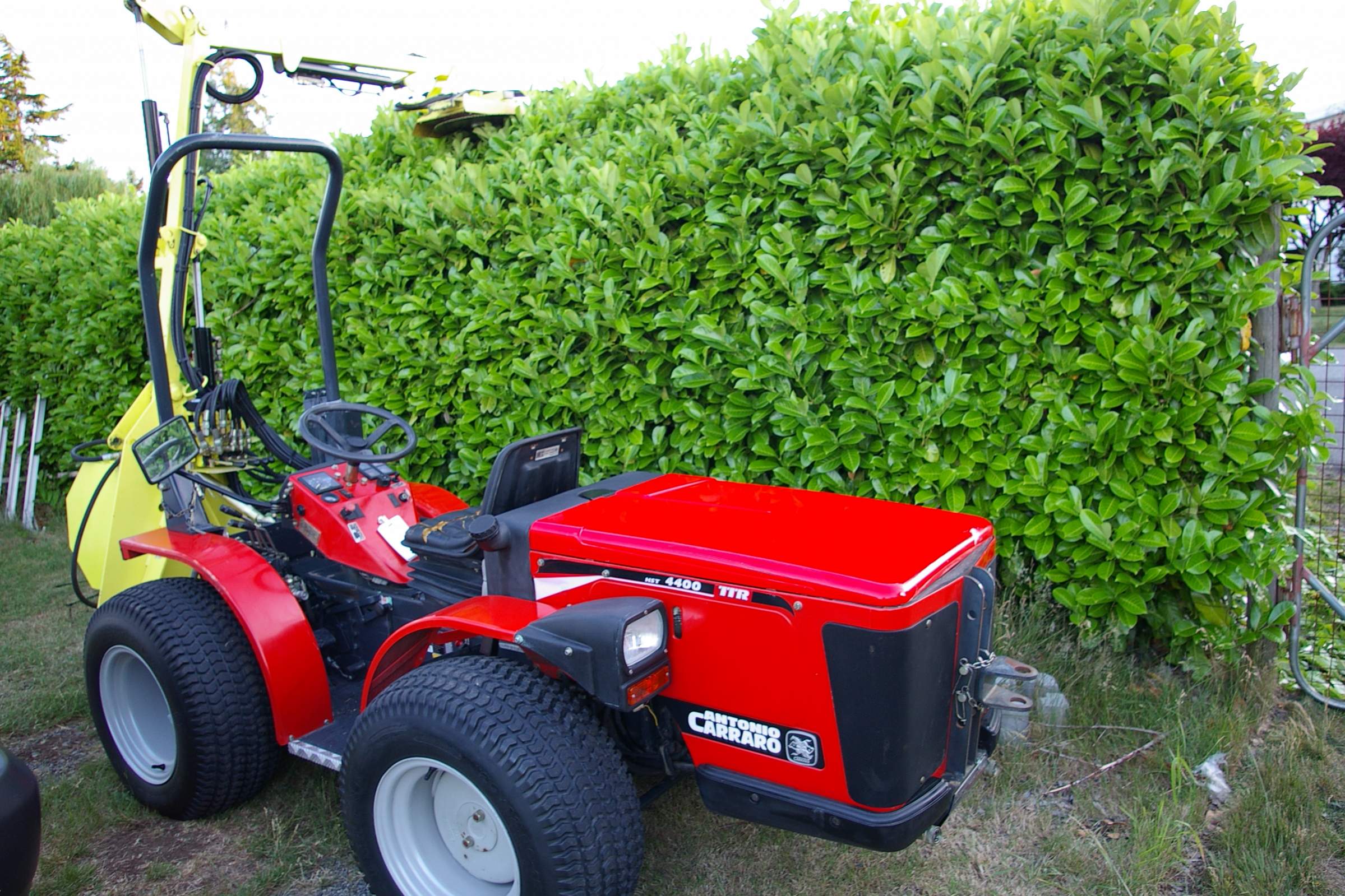

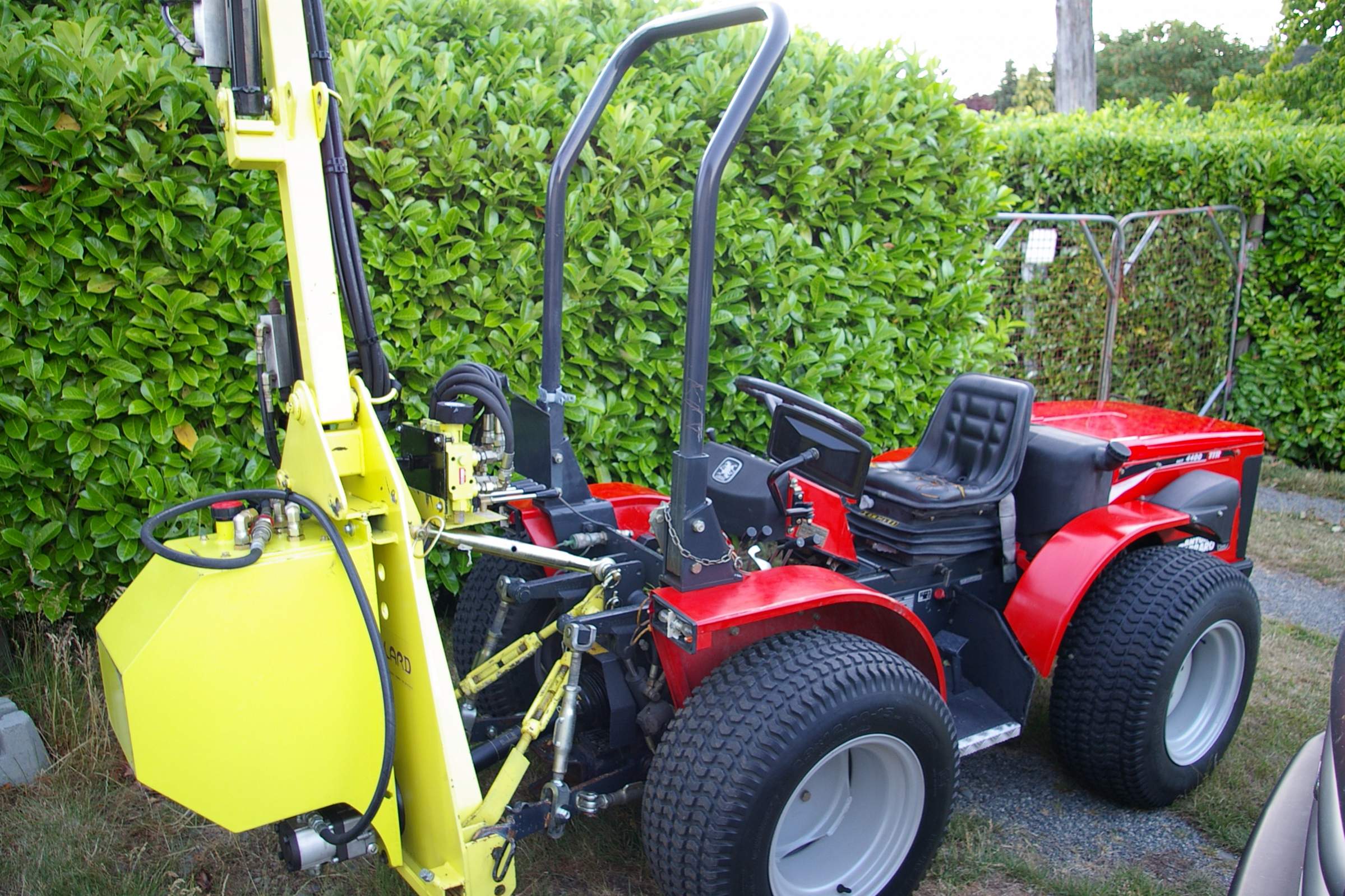

I have just aquired my first tractor. I want to put a finishing mower on it ,But the tractor is an Antonio Carrero TTR4400. The whole machine is reversable, I thought it would be better for steering and visability if I could drive with the mower first. All the finish mowers I have seen are rear discharge. I was thinking a side discharge would work better? Anyone have any thoughts or experience with this matter?

Very cool machine. I like your hedge trimmer.
There are a lot of front mount mowers out there. Kubota F-series are one, and I think that the JD model #'s also start with F.
You could probably get a deck for one of them, and modify it to use with your machine.

Nice Tractor. Does the seat/steering wheel platform turn around to the other direction??

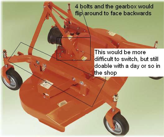

you should be able to get a side discharge one, reverse the mounting brackets and the gearbox and mount it on your tractor (assuming that the PTO shaft spins the the same direction)
Below is an example, the only problem is that it is a rear discharge model, but the idea is the same.
