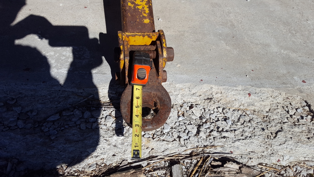

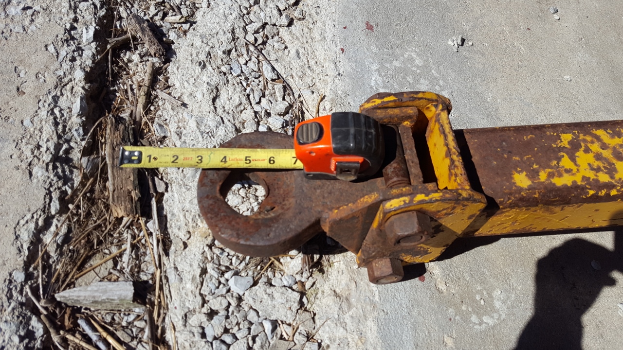

Here's some pics of my scraper hitch.

Is your drawbar strong enough to handle the equipment? The hitch on two pieces of equipment look well built .

1 1/4" x 2 1/2" drawbar steel. I believe the reason the first broke was because I was stressing it 'out of spec' with the rigid hitch connection in conjunction with the angle I pulled against when the blade stuck.
