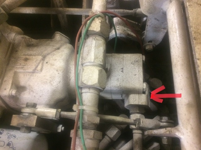

If you look at the side pintle (swash plate adjustment), the TA15 has 2 mounting screws, the TA19 has 4. Thinking you have the TA15

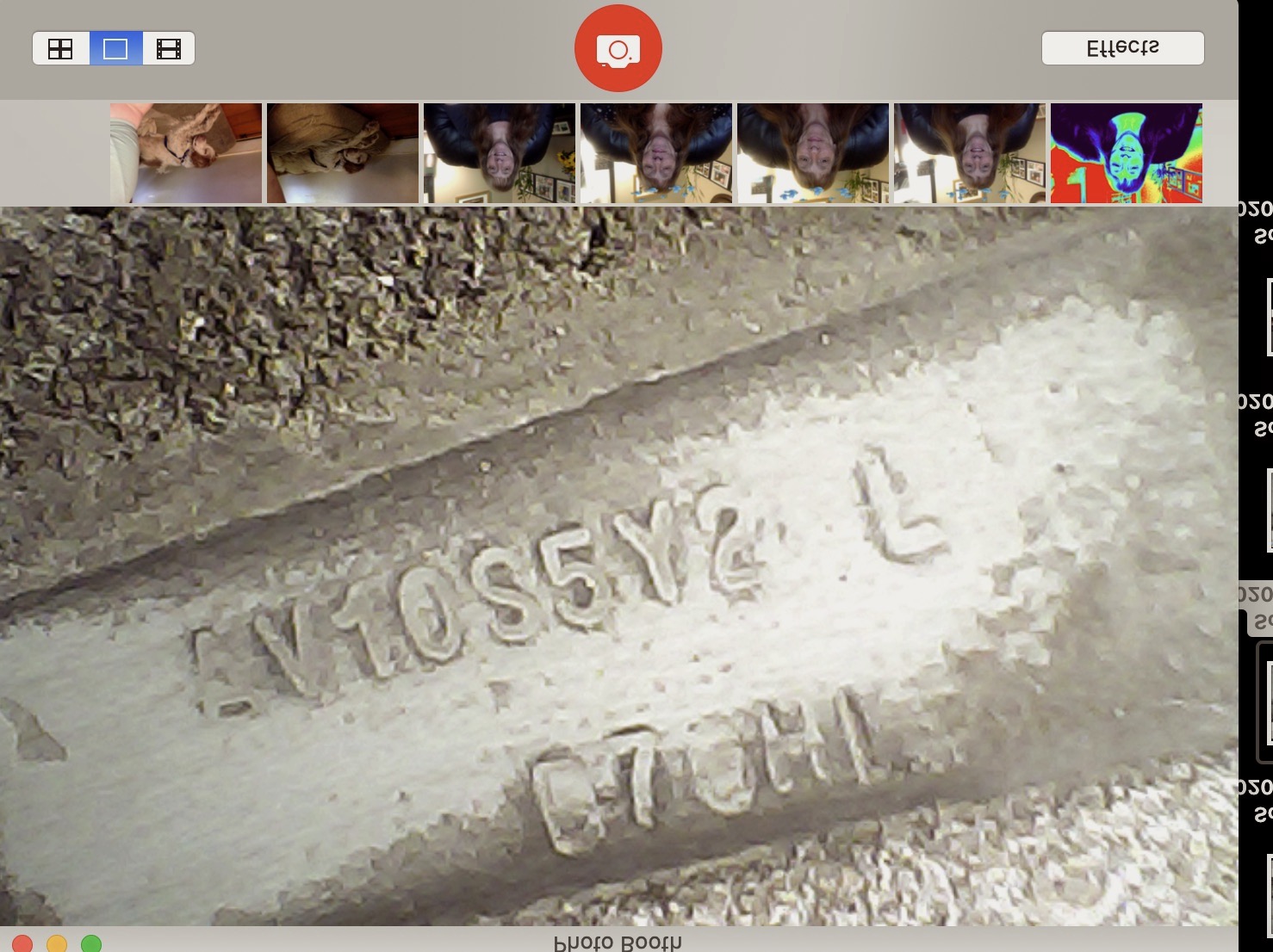

The numbers you’ll find stamped on the flat spot on the small cover on the aux vane pum.

In looking at the parts breakdown that Sundown posted for the TA1515 it does appear that central port block is common for either CW or CCW rotation so should only have to change vane pump.
Been 20+ years since I did that job. Not difficult but I don稚 remember the exact process.

#27
found numbers but they don't seem to do me much good.
