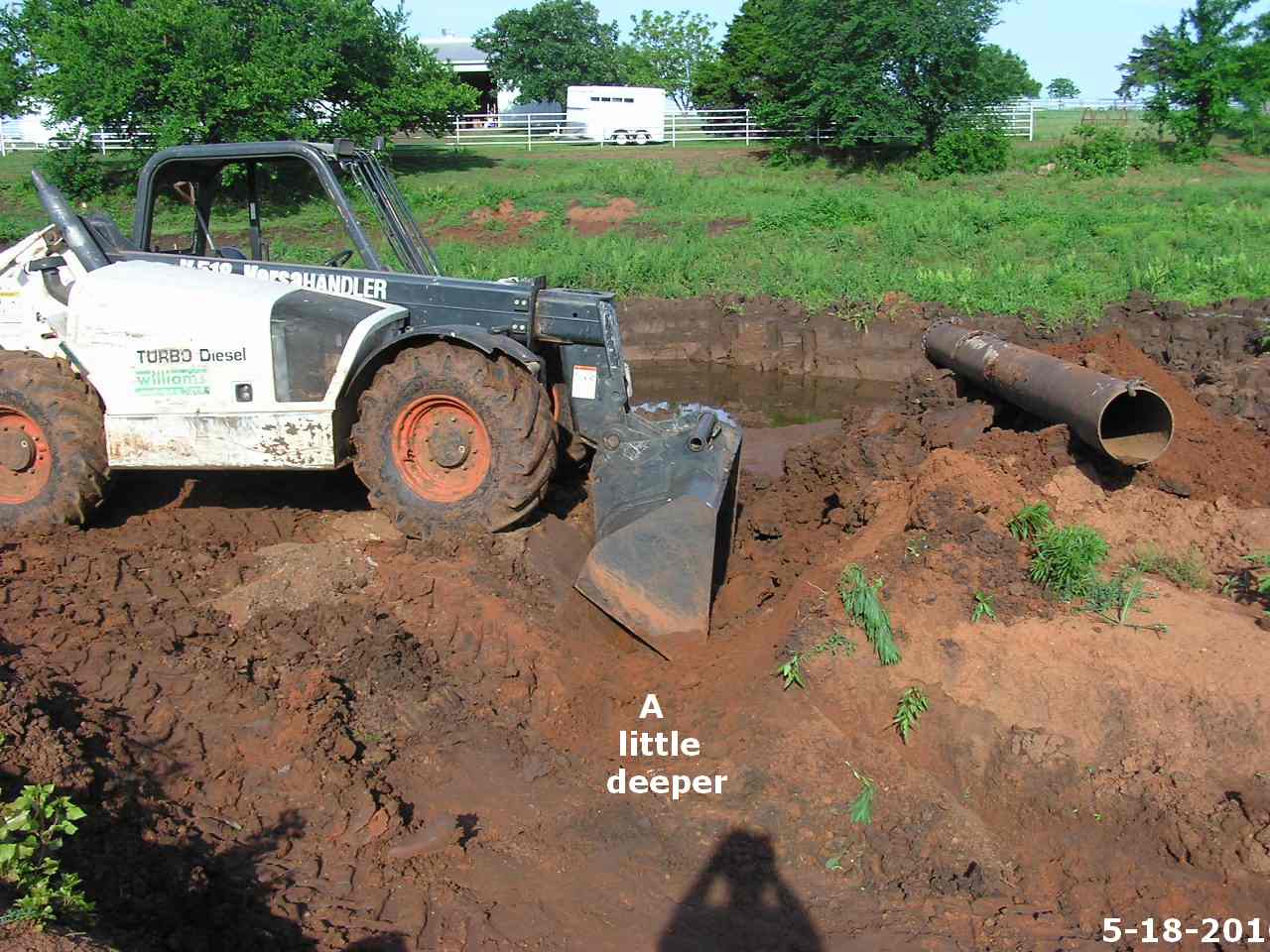

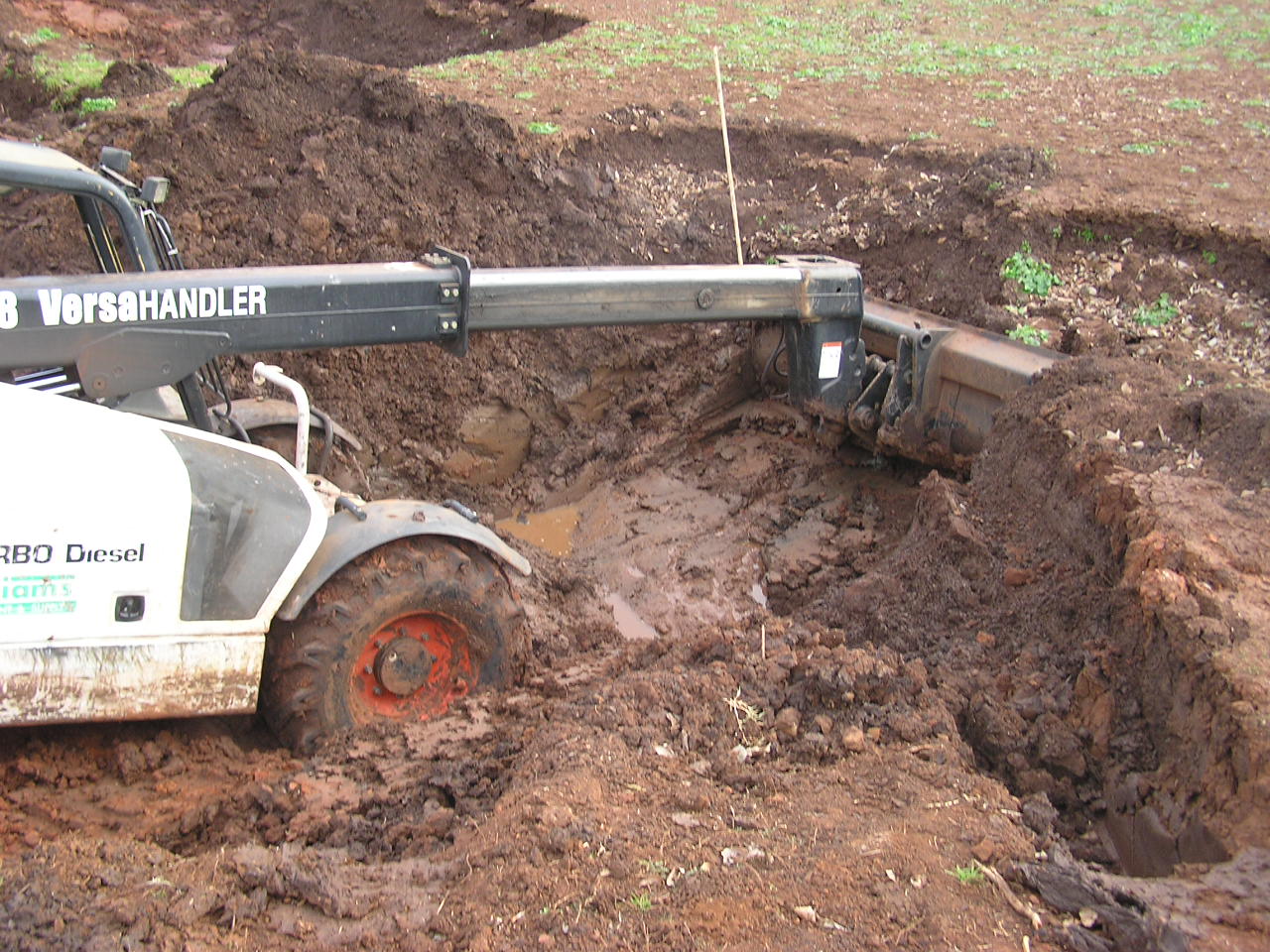

It worked well for me, I could really tell the difference. It is easy to do, just raise the back, support it securely, unfasten one wheel, roll it to the other side, unfasten that side roll it to the first side and fasten them on, That is it, reversed!
I had to do it on the front, but same result. I was working in some sloppy stuff!
