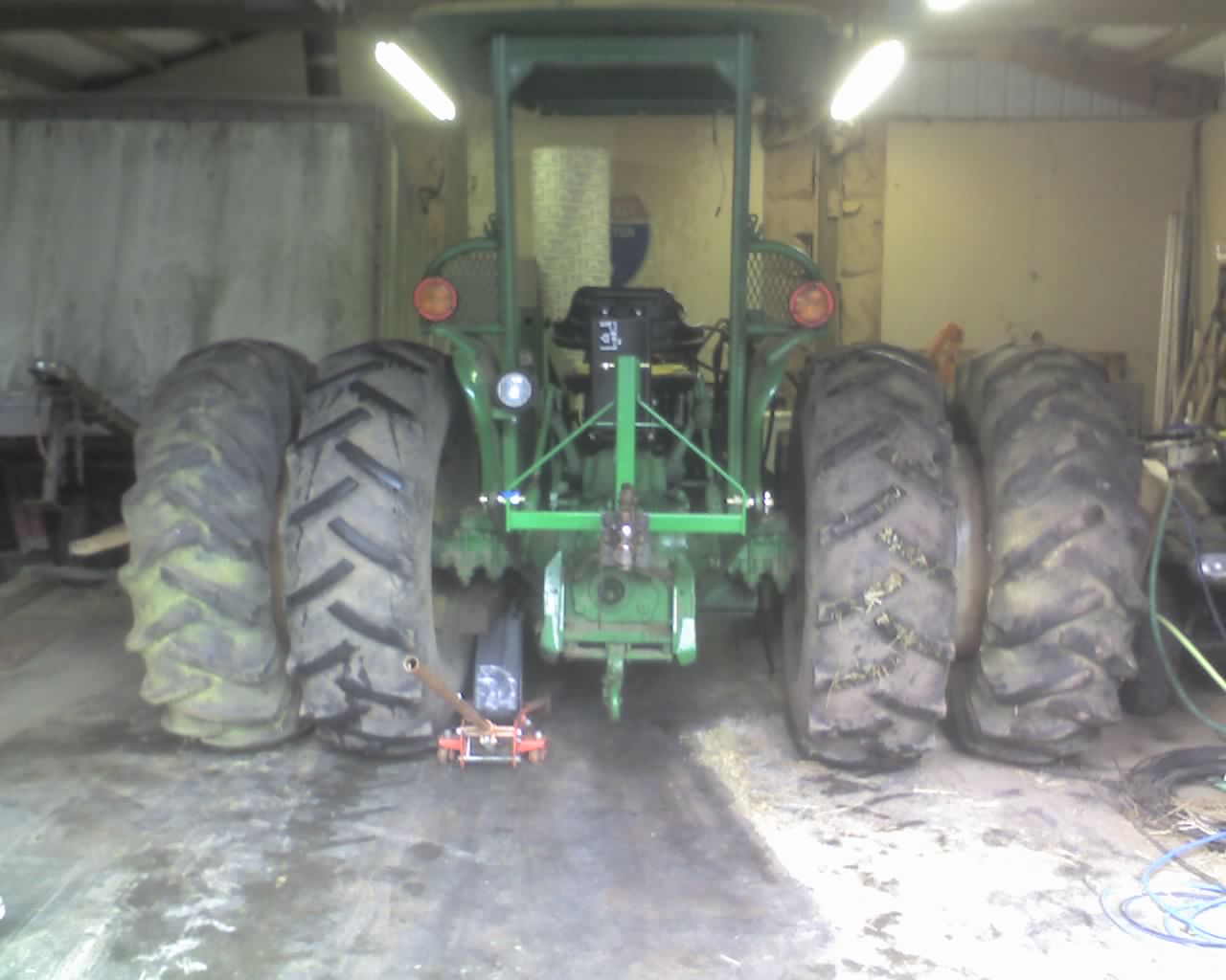

I'm getting ready to do this as to gain some width. I have a couple of dumb questions.
1) What are you guys using to jack and support the rear end to do the swap? All my jack stands are too short. Did you buy the taller ones (expensive) or rig something up to get the both back wheels off the ground?
2) I have a farm jack, (and several auto jacks) what is the best jack point on the back to get both sides off the ground at the same time?
3) what is the weight of the 28" R-4 wheel assembly? Can I do this myself or will I need some help?
TIA for the help!
This was how I lifted mine. I needed to add the 4x4 on top of the jack to even reach the axle.

Done! Used two 2x12's under each jack stand and positioned them on the flat plate on each axle. Jacked it up and went at it. The track is much wider and looks a ton better. Also much more room under the back for service. Took 30 min for the whole job. Thanks all for the insight and I'm looking forward to the extra stability!
