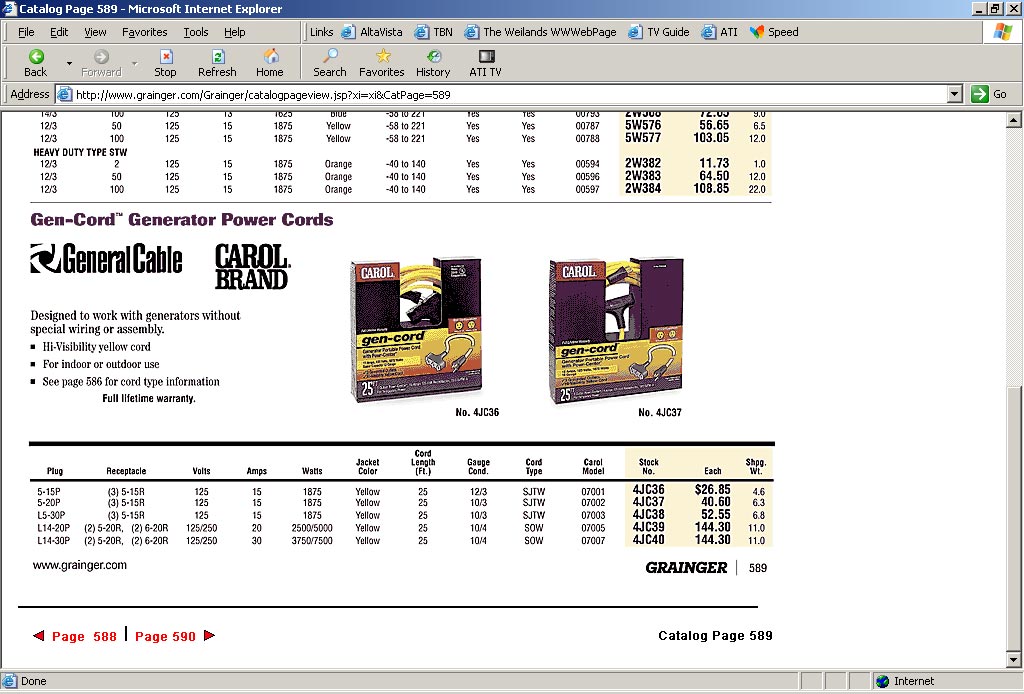

Trev, Carol brand (division of General Cable) makes what they call "Gen-Cords". Their 220 volt version has a twist lock on one end to plug into your generator and then they have a box on the other end that has both 110 volt and 220 volt outlets in it. Grainger sells them but at a high price. I have attached a picture from Graingers website to show you what I am talking about.

Here are the specs for the various Gen-Cords that Grainger sells.
