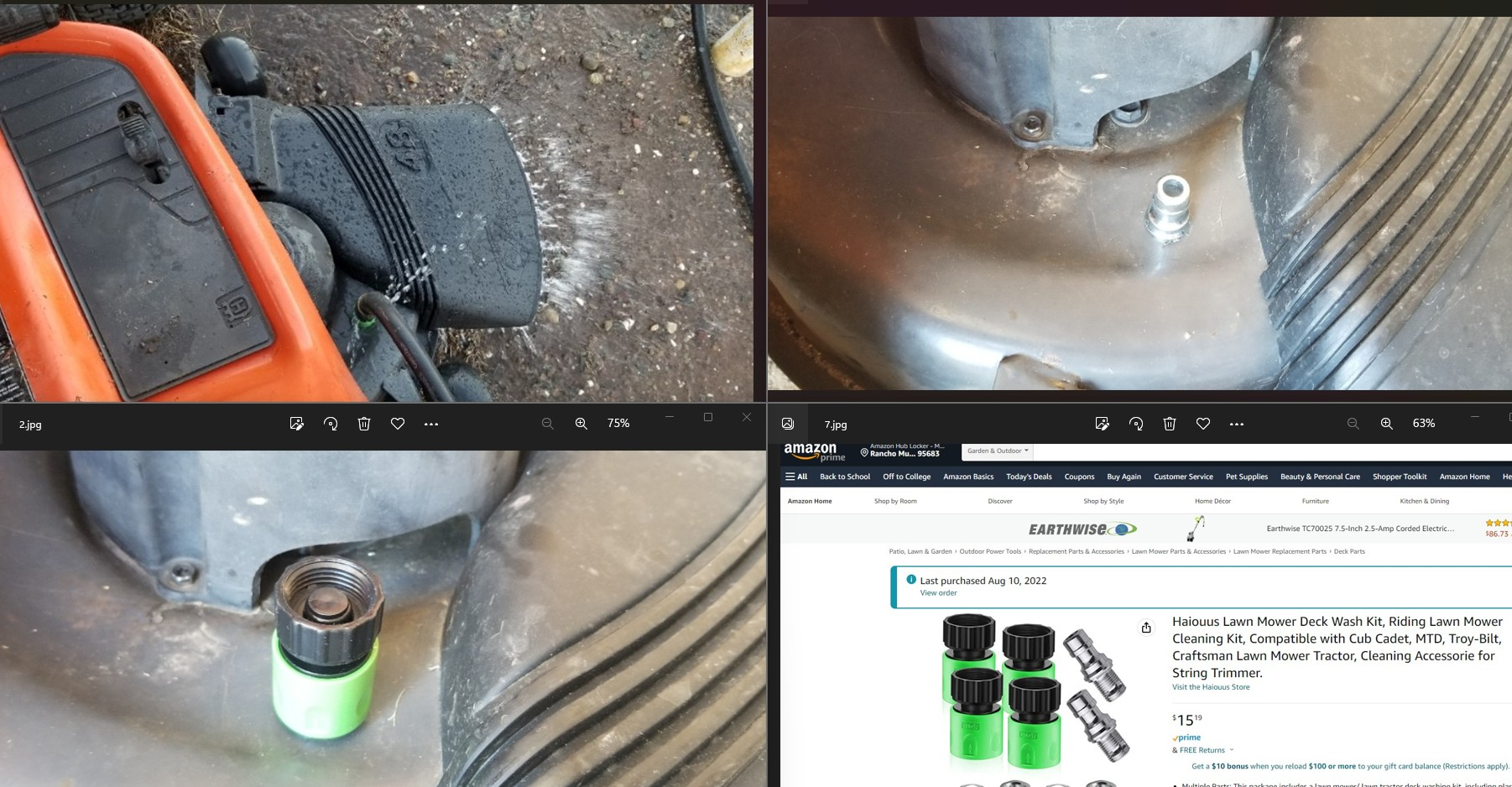

Installed a deck wash port purchased from Amazon.
Needed a 5/8" drill bit and 24mm wrench socket for drilling the hole and tightening up.
It took less than 10 minutes.
It makes easy cleaning the deck
Jkk
