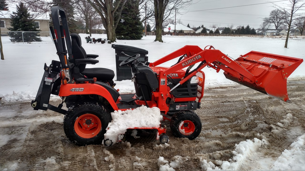

I have a BX2350 with a 54"mmm and a front mount snowblower. Different model than the new 2816, but similar. I put the mmm on in the spring and it stays on all summer. I also have the FEL which I use occasionally and the mmm stays on when I use it. In the fall I take the mmm off and mount the snowblower and it stays on for the winter. I wouldn't have it any other way. But, I don't have fields and forests to travel through with the mmm mounted, that might be a problem. Another note though. I have ordered a new BX2380 with the same equipment except, I ordered the new "roll Over Mower". It is supposed to be easier and quicker to remove and remount. Just a side note about that, the mower seems to be very hard to get. My dealer has been trying to get one for 3 weeks.

I've used my BX-23 with the 60" MMM for 12 years now (roughly 950 hrs). I leave the MMM on close to 11 months of the year. If I use the FEL or BH, I leave the MMM deck on and just raise it up high. If I use the 3 point hitch (for the 72" rake or 4 ft box), I leave the MMM on, raise it up to the max and lock it in place using the cutting height dial, so I can raise/lower the 3 PH as needed. In the highest position, I have 5 7/8" of ground clearance to the lowest point of the MMM.
At least annually, I'll take the MMM off to grease, check the oil, sharpen the blades. I usually put it back on since it gives me ~300 pounds of extra weight.
Here in Northern Alabama, I don't get much snow, e.g., no need for a blower or brush, though I have used the FEL to push snow/ice and I just raised up the MMM when I did.
I always mow using the high gear range and probably go around 7 MPH, which is plenty fast for me. Don't know why anyone would mow in low range - maybe if there were hills - my land is flat.
The MMM is heavy to move around by hand. I can get it off or on in 5-10 minutes. Getting the drive shaft re-attached to the mid-PTO can be challenging;e.g., making sure the ball detents are locked in the PTO shaft groove can take a few minutes.
