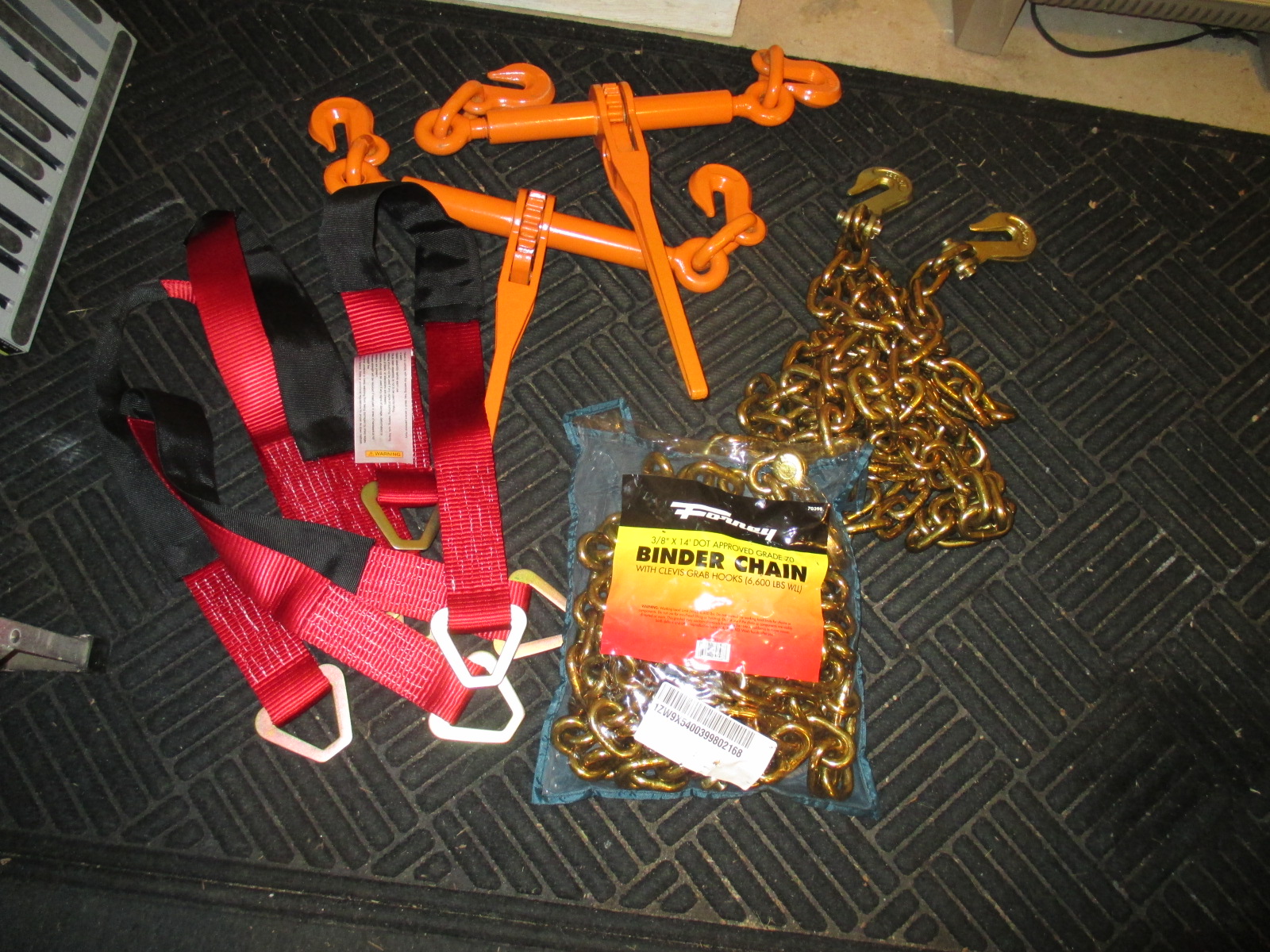

Ok, I'm going to do it the conservative way. Even though my Kubota is well under 10K weight, I will get two more chains and binders and go out from each corner, trying to connect to the tractor at a 45 degree angle. As low as possible. Then a strap over top of any implement in front or the rear, looped around somewhere, and make sure nothing can go side to side or more straps. I imagine when I'm done it will look like a Lilliputian holiday.
thanks very much for the link. I looked, but did not find it before I started.
I think I'm doing ok. I have the axle/attachment straps, i learned to drop the chain hook down the hole, out the side and then back on top, where it will rest "facing down" on the top edge, where even if it gets loose it won't fall off. All kinds of nifty things to learn here.
and yes, when I'm done, the very, very best thing to do is take a bunch of pics and post them here, and then ask the group to comment.
3/8 chain is overkill for me now, but if I buy a 8-10,000 pound tractor later, I'll need it.
Need to get some of those heavy duty fabric straps, have one but it's awfully long. Most of my runs won't exceed six feet...

btw, every last item in that beginning picture has a made in China tag on it. Amazon. However...beautifully finished chain, nice chafe protection on the straps, four for twenty bucks..., but somewhere in the back of my mind is the persistent concern over things not being what they are. Like chain that may say DOT but maybe only talked the talk. That's why I went a size higher than I likely needed.
In the other thread is a pic of a pretty neat improved functionality binder that was only about five bucks more than the basic ones I bought. Which came highly recommended...I rarely buy anything from Amazon that has not been reviewed by many people. The same forty dollar chain at my door is sixty plus tax and gas at my local Kubota dealer. I buy so much stuff on Amazon for convenience and savings that I also need to wander into the Kubota parts dept, which has not changed since I think they opened eighty years ago, and I know where everything is. Well, the part outside the counter of course. I know where the chain is, I know where the binders are, just wasn't sure what to get. Have a better idea now, and thanks sincerely for all the education. besides, one less chain or part of it hopefully that won't come through your windshield... loop that hook. loop that hook. assuming the head fits through the hole. I'm sure the big rental trailers have plenty of good attachment points. The local Sunbelt rental place uses a top brand trailer (Hudson) which impressed me.
with permission I should download the pic of a nice JD with FEL that was properly tied down; well of course there were suggestions.
I looked at it carefully, and thought, I can do that...
No matter what, I think a rear camera watching over things would be a nice addition to the cab.
