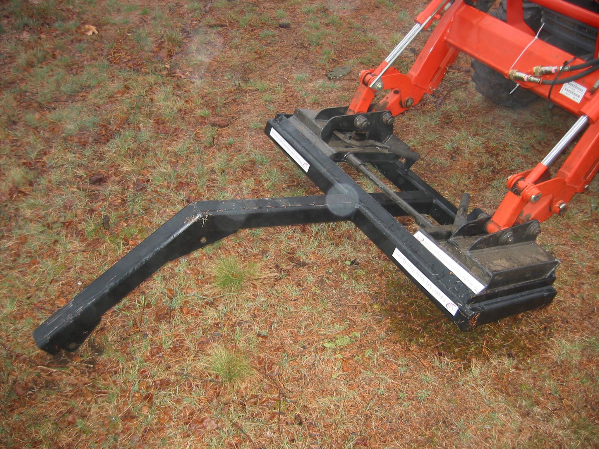

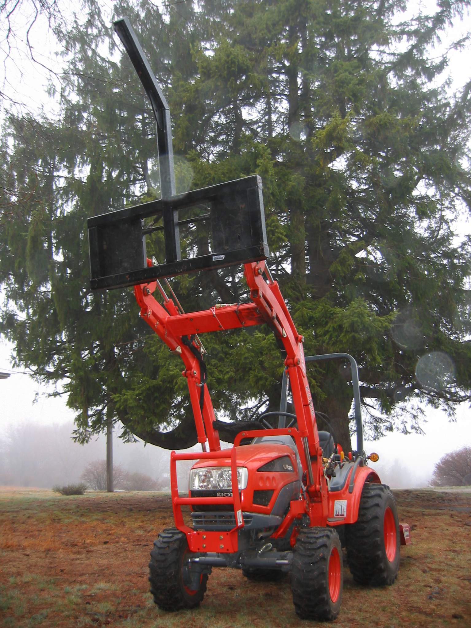

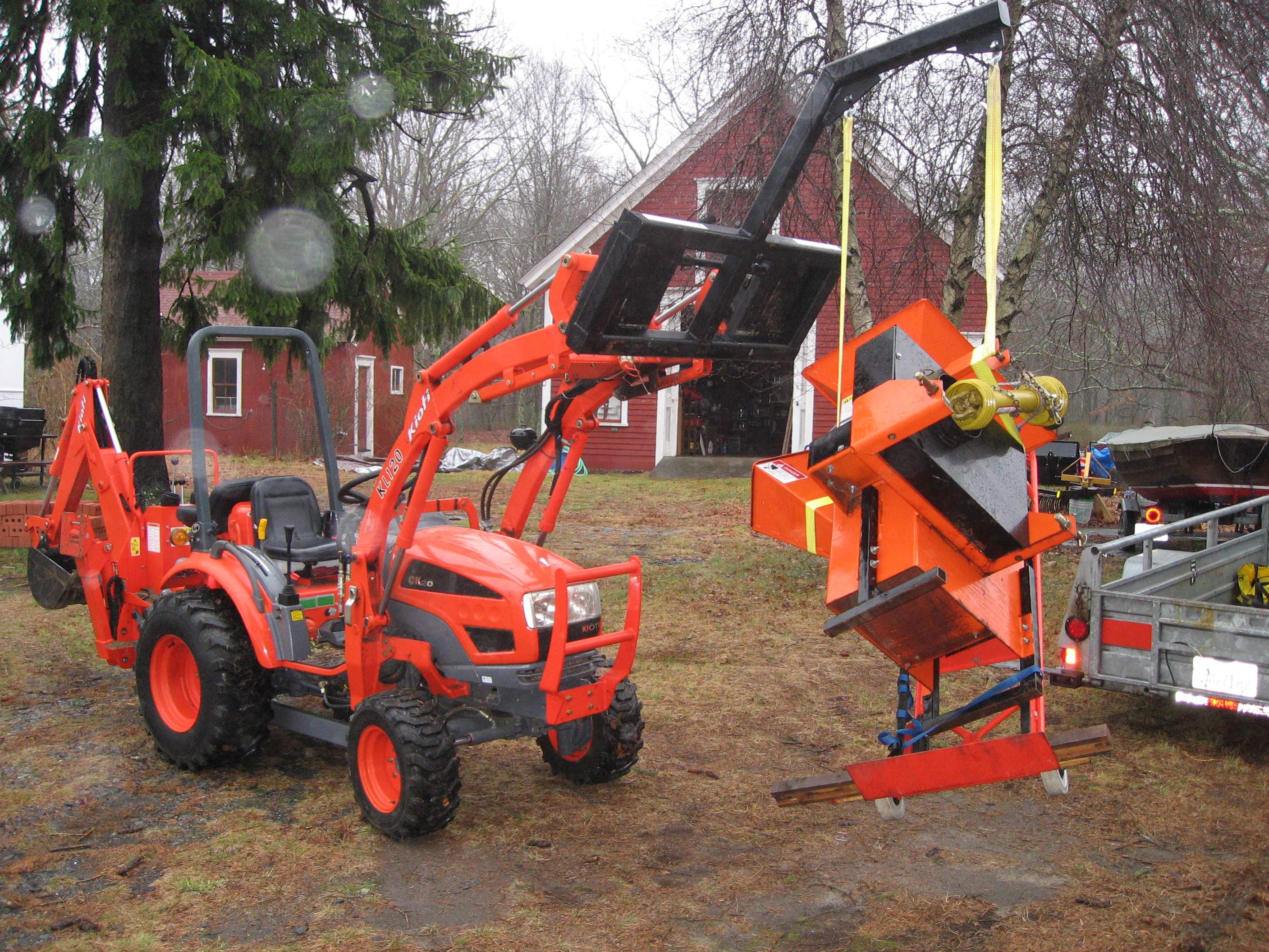

I still think a tree boom would be a safe and effective way of lowering a heavy object down a set of bulkhead stairs so long as the tractor can drive up to the bulkhead. Just do a good job of strapping or chaining the stove.
