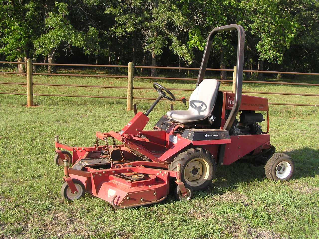

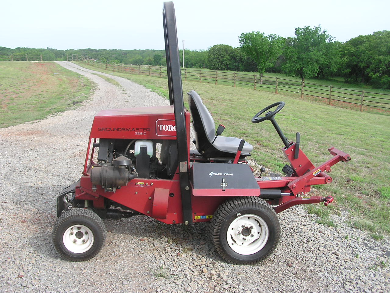

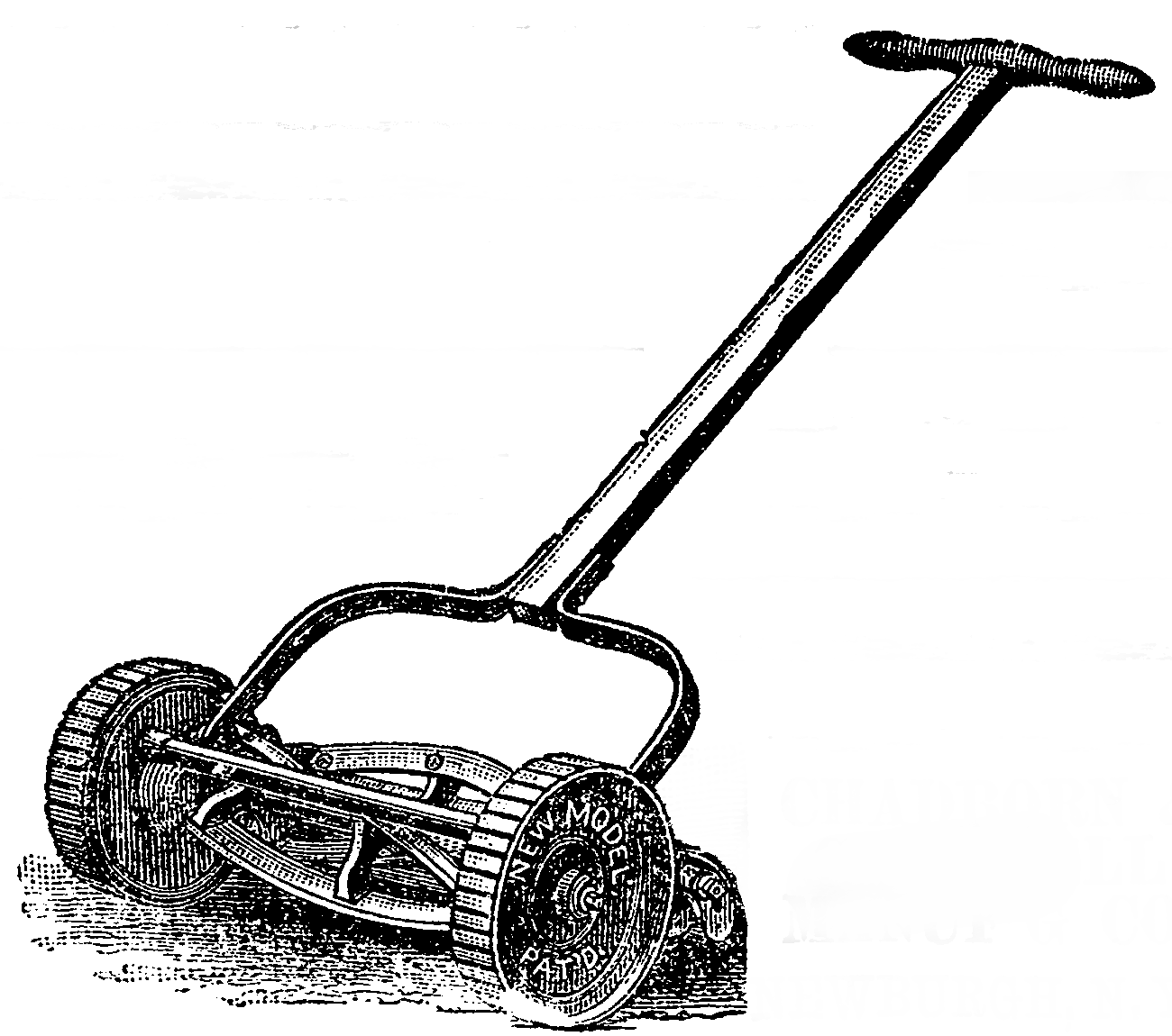

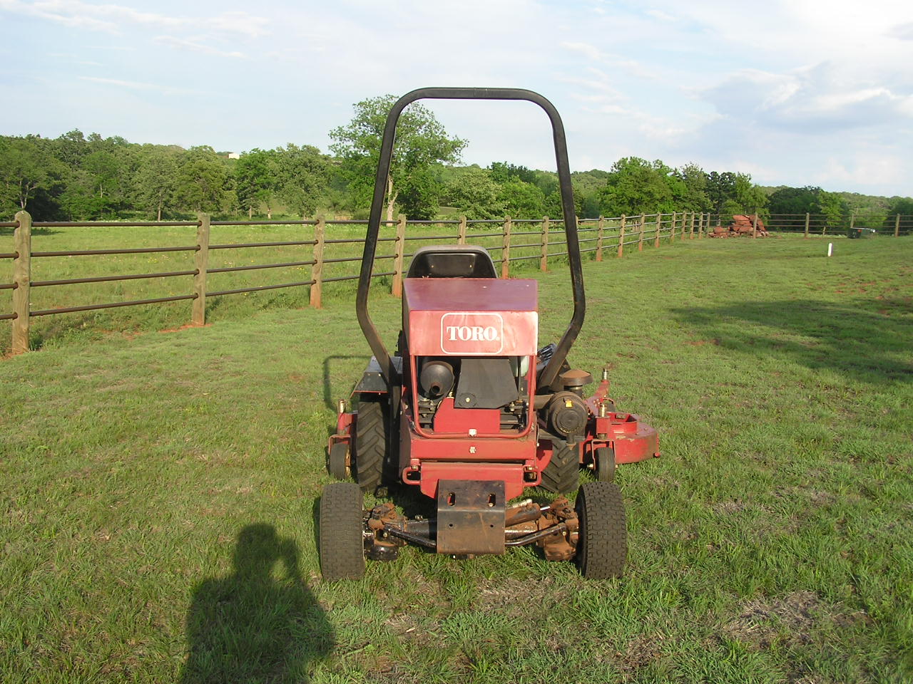

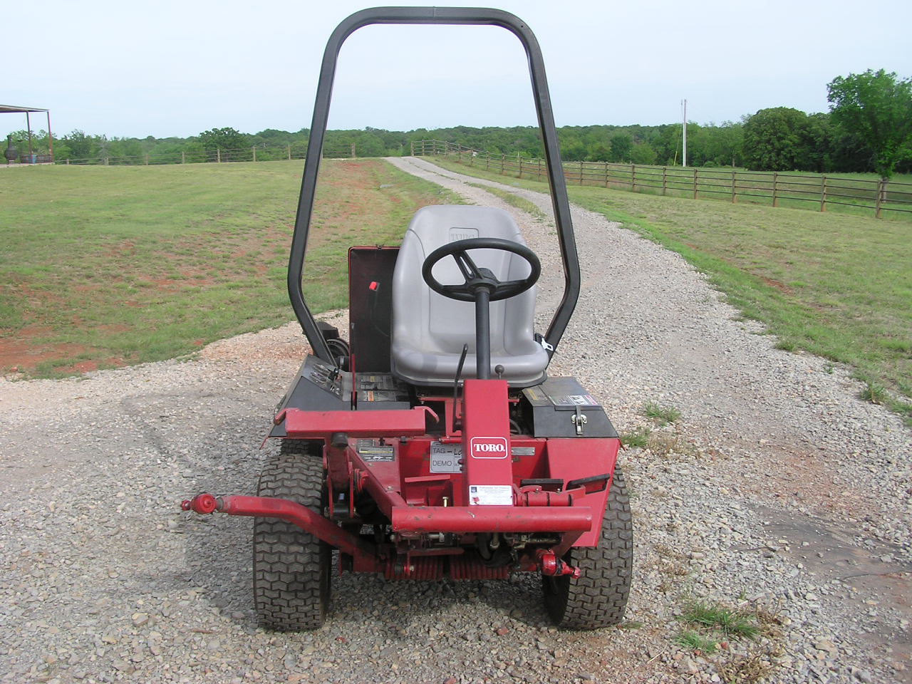

Well since nobody has mentioned them, I will post my preference. In my lifetime I have mowed with every type made, including Ferris IS ZTR.
Starting with these.
And this.
But for my needs now, the front deck with a suspension seat is the best. :thumbsup:
4WD, Hydrostat, 28 hp Kubota diesel, 6' recycle deck.
