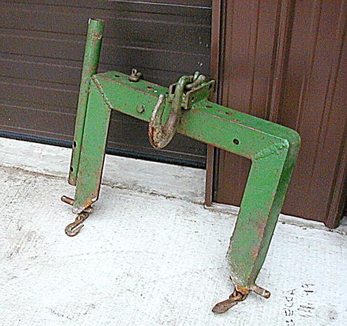

i do have a 9' backhoe. Should I be using that to skid logs? I was thinking it wouldn't be good for the backhoe. Found a picture of this log puller. I think I am going to make something similiar this weekend. I think this is much simpler than some of the other ones I've seen. I would add more hooks.

The nice thing about the backhoe is that you don't have to get the tractor as close to the log. You can reach out away from the trail to attach the log and can move the log around to get it lined up correctly.
Just make sure that you have the back hoe pulled up tight to the tractor when skidding.

For about $80 at Harbor Freight you can get a quick hitch that is very close to that. A little reinforcement and yould be good to go. You should not pull from the BH boom using tractor power. This can bend the rams on the boom control cyls.

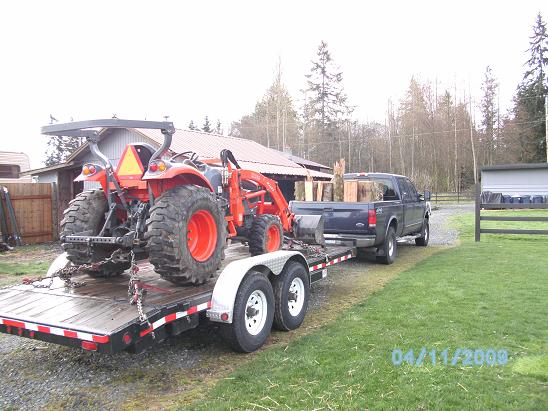

Here's my "skidder" that I used this last weekend to drag several trees to a deck for firewood. I was dragging red alder logs that were at least 12" at the stump end. The deal is that you set the tow bar low and attach the chain, then lift up so that the butt end is off of the ground, then try and drag it. If it won't drag then go back and cut the log shorter. Repeat until you can drag it away. Some trees are light and skinny and can be 40' long and some are fat and heavy and can only be 15'. No biggy. I could drag three stems at a time with my 30HP.
The little tow bar deal is super cheap. Like less than 20$. The hook is a grab hook and can hold more than one 5/16" chain.
