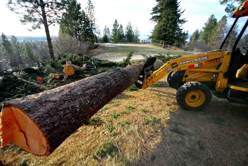

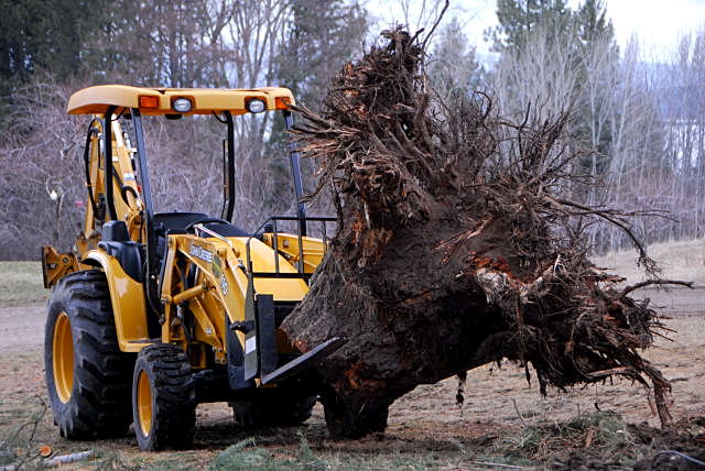

You may be surprised at what front forks can do...
