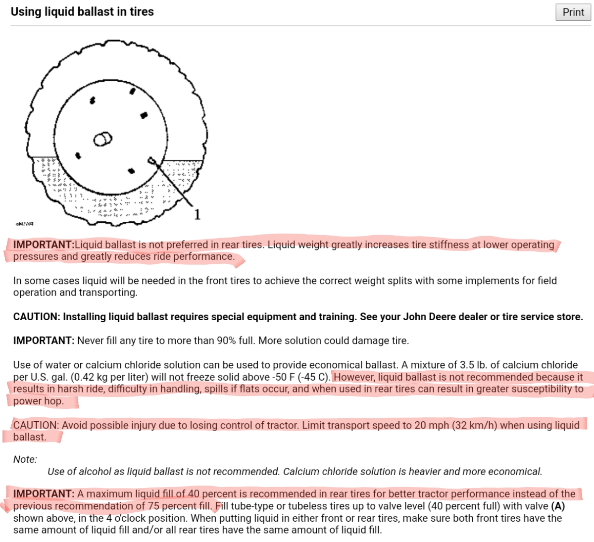

Using liquid ballast in tractor tires.
I can’t help but think liquid ballast works better than nothing, but the downsides of using it, as described above, are not a long term, reliable or practical method.
   / Rim Guard and punctures #28
Multiple manufactures quietly recommended only 40% liquid fill. They do this at a low level because they know their dealers are still filling at the 75% old standard.
For someone with 350 pounds liquid per tire this takes it down to 190 pounds.
   / Rim Guard and punctures #29
So what do they do with the tubeless Calcium Chloride fills. Supposedly it doesn't corrode the rims if the rims are completely submerged and can't interact with the air.
Supposedly is a real big word,
I have seen a few of the rims which were run tubeless and filled over the top of the rim,
it still corroded quite badly
If this works it is a link to a pdf of the amount of calcium chloride per gallon of water and its slush and solid freeze points;
https://www2.gov.bc.ca/assets/gov/farming-natural-resources-and-industry/agriculture-and-seafood/farm-management/structures-and-mechanization/200-series/210104-1_calcium-water_table_for_tractor_tires.pdf
edited to add,
when you do a 90% fill your ride quality is dismal and if large enough rocks are hit with sufficient force you can actually split a tire open.
