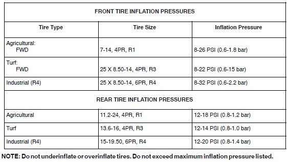

The following is the guidelines for the tire pressures for my New Holland TC33D:
