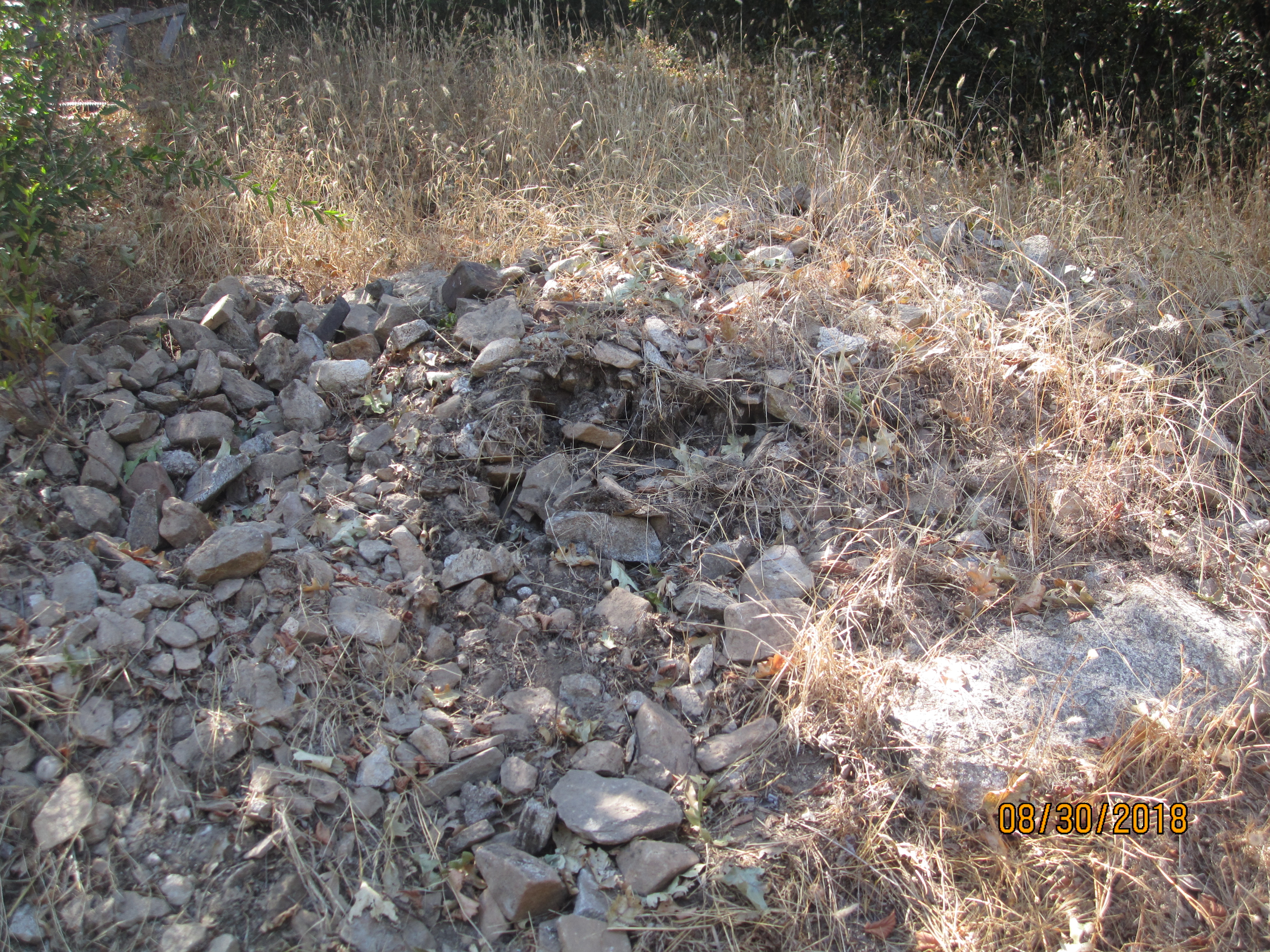

Being property owners we all have these - piles of stuff be it rocks or pipe or whatever. Whoever put it there at some point we may want to clean it up. I don't want to do this by hand at my age with a pick and bar. The BX is pretty small though and experience with gravity weight alone on the box blade has not been too impressive. I am looking for ideas for something to attach to the 3-point that will tear piles of stuff like this up so we can get the mess cleaned up. Anyone sell a single ripper claw attachment for a BX?

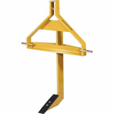

Not sure a subsoiler (single rear tine for 3 pth) would fit a BX...

I have a tooth bar. Both that and the rippers on the box blade are simply not heavy enough - not enough down force or front force with this size tractor. This was just an example pile. Want i want to with it is consolidate into one mountain instead of a ridge to get access on one side. But I have several piles of buried junk around - fence posts, pipe, old gutter ,etc, half buried in the ground and trying to find a way that the small BX can help out.

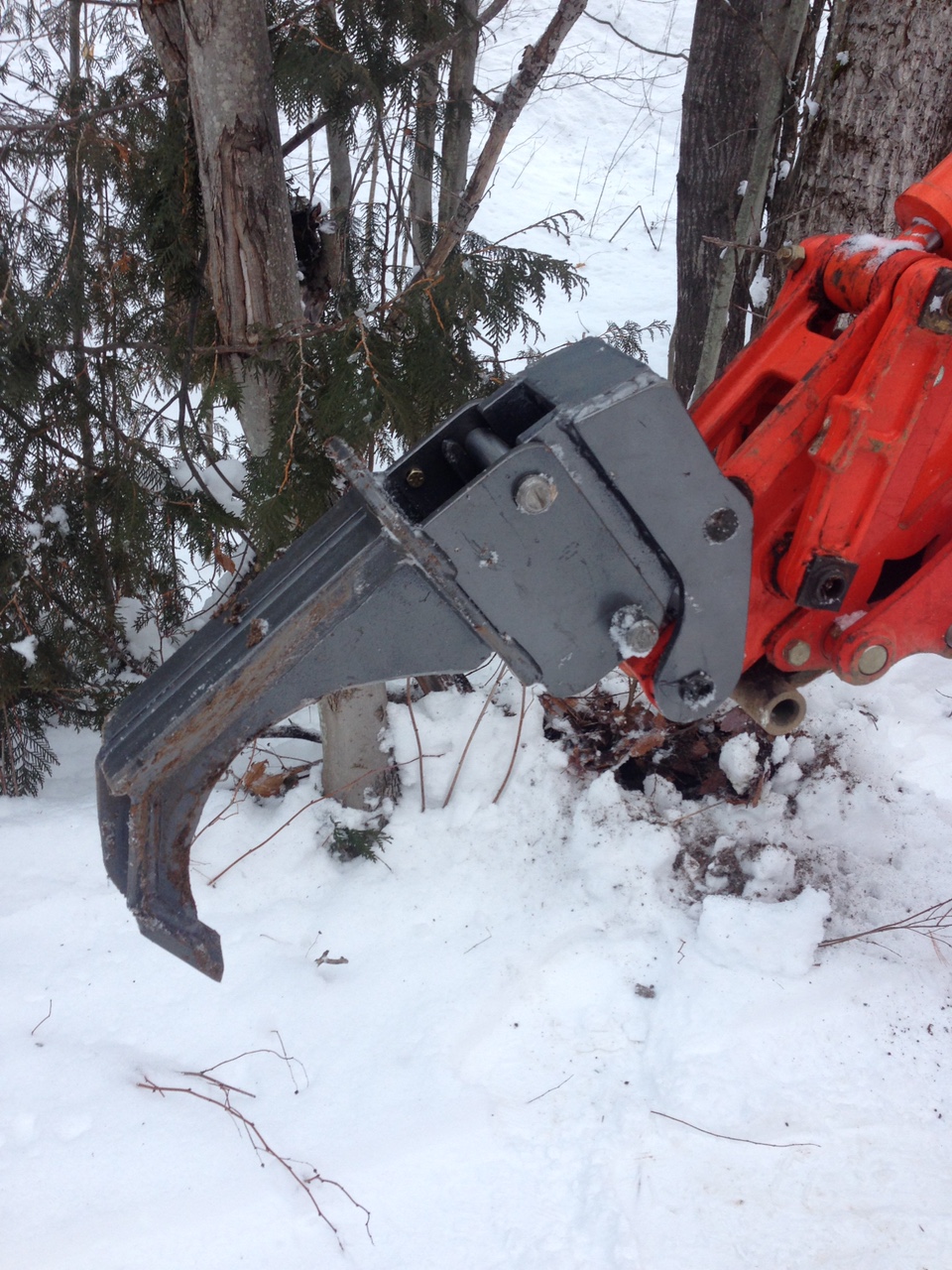

There are no claws for the 3-point for the 2370 on BXpanded (have their tooth bar and skid plate already though; tool box looks good). I see ripper claws for the backhoe . . .
OK looks like two box blade claws is what we have to work with - no readily available single claw. Single claw will be lighter than the box blade anyway. Perhaps a larger claw attached to the box blade is what I need. I'll think about that one. thanks guys.

To answer some of the above - no I can't drive over the entire pile. but I can back up to it and engage with the box blade. I think what I'll try is a fabricated double claw I can bolt on to the box that is longer than the stock rippers. Even though i have to pay for some welding it'll cost less than a new implement and I can utilize the box blade weight - which I may add too somehow. it simply is length of claw and weight. thanks for the ideas. Yes a bigger tractor would help - but my gates and house yard obstacle sizes preclude that.

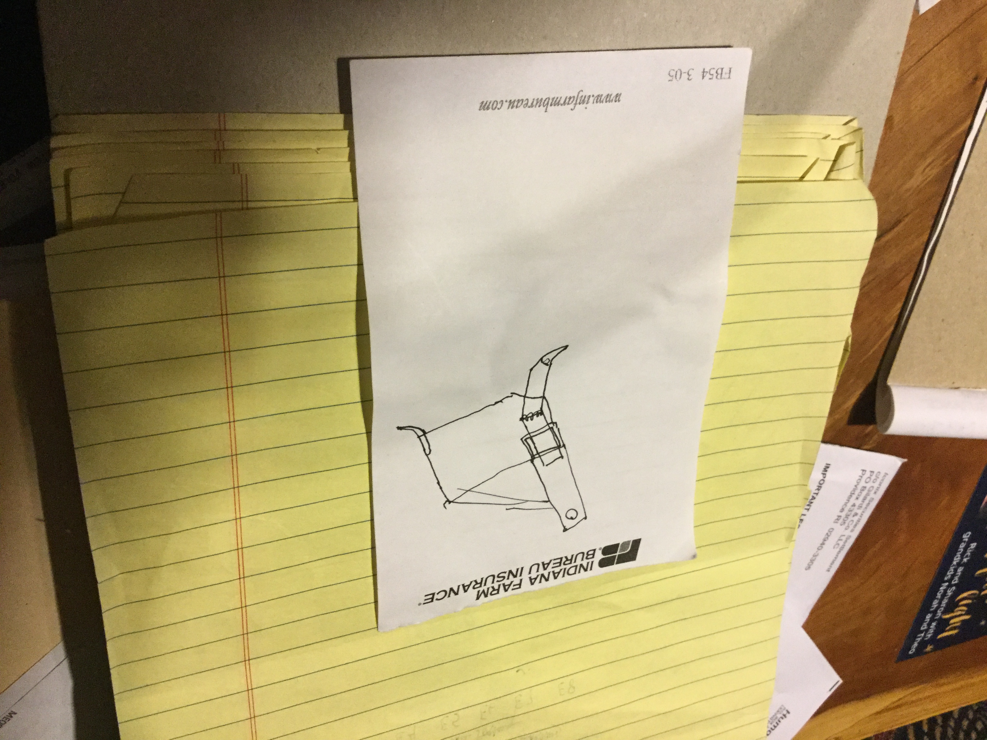

I don't think those box blade replacement scarfiers are expensive. Buy two, cut the shank off one and butt weld it to the shank on the intact one to extend the length.
For deep digging on mine, I tilt the box way forward so the scarfiers stick down more. With a custom scarfier,
you could butt weld it at an angle so it's more vertical when the box is tilted.
