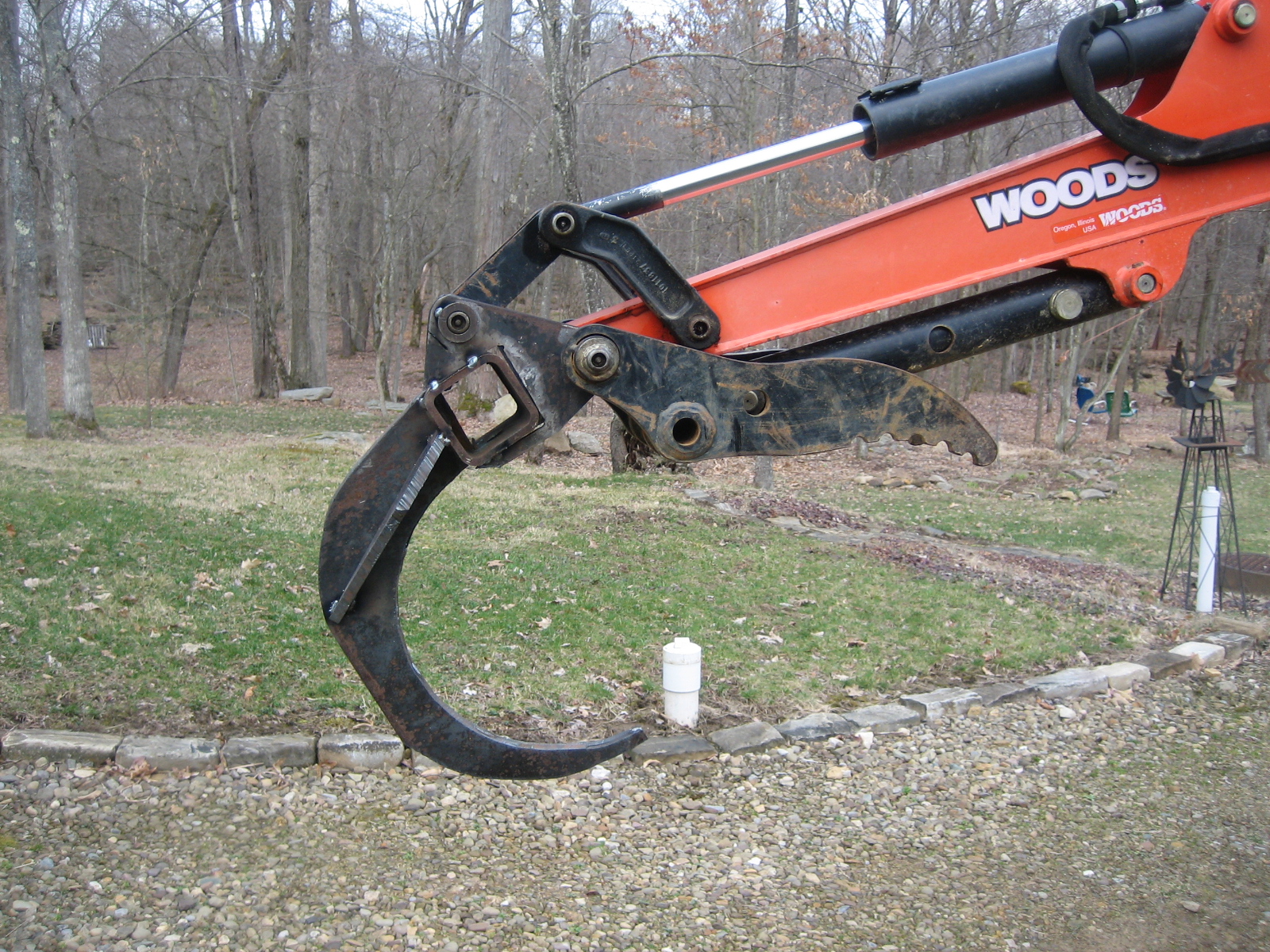

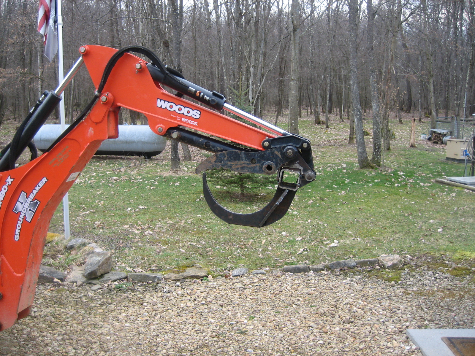

I built mine last year, may add teeth.
JW5875
   / Ripper Claw #36
took an idea from the bxpanded company for my bigger backhoe. 3/4 inch plate cut with a plasma cutter on an angle to achieve a pretty sharp edge. Finished it with a grinder and stuffed it in my wood boiler to get it hot then dunked it in oil. I beat it to DEATH trying to break it. No luck, didn't even bend. Very pleased with the results.
What grade of steel are you using that you can heat it and dunk it in oil? I see you're using 3/4" for the toothm what about the rest of the implement? Are you heating the whole thing prior to welding?

I used 3/4 for the tooth its self. Then 1/2 inch on the back plate with a 3/8 plate behind it attaching to the mounting brackets. I welded it all up and put it all in the fire then oil. I buy 99% of my steel as "throwaway" or scrap. Just mild steel stuff. I figured if it broke it broke. But surprisingly it is holding up quite well. Considering no steel company will actually tell you what steel can handle I am just finding out my own way. My plasma cutter only will cut up to 7/8 so this was about as big as I could do since I was cutting on an angle.
