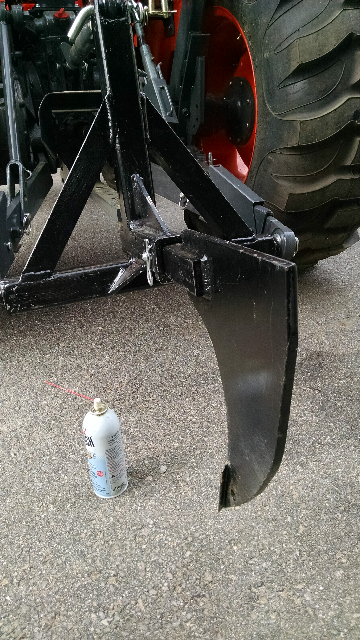

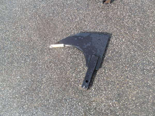

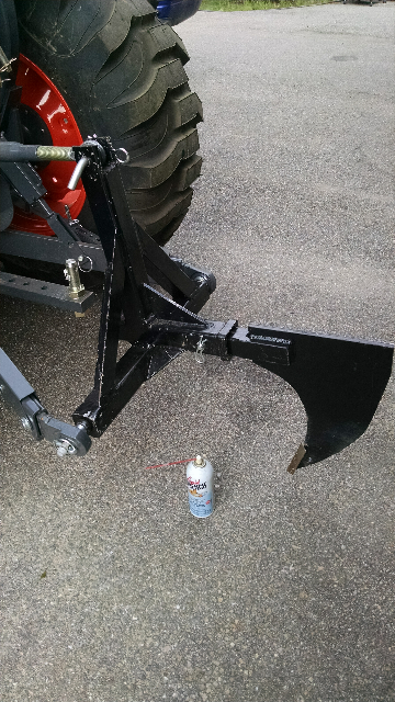

So I have a new Kubota MX4800 and a Bradco Jaws tree and post puller. It works amazingly well but the biggest hardwood I can pull is 6 or 7 inches in diameter. I can use my subsoiler to loosen the soil around larger trees to get them out but it tend to get hung-up on lager roots.
I have been thinking about making a pointed blade for the subsoiler to cut the roots better. But i came across a homemade ripper on Craigslist for less than i could buy the metal.
I'm going to go look at it (buy it) in the morning. I was wondering what some of the more experienced implement fabricators thought of it. Any chance it will work or will I rip it to shreds?
   / ripper for roots? #2
I think you should have fun trying it out. I've no idea if it is up to the task or not. If inexpensive enough certainly worth the try.
   / ripper for roots? #3
Plan on the resistance of the root equal to trying to split wood 'cross grain". 20 ton is just enough ;-)
Sharpen that blade, and peck away !

It work ok. A lager blade might actually be better. Haven't torn it up yet. Largest hardwood root that i know I've cut was about 3.5" diameter. Also it would be better if it were set further away from the tractor making it easier to back up to a tree and make a cut on either side of it.
I also posted a video of the tree puller in action. Did not need the ripper for those trees. Search for "tree puller" in the titles.
