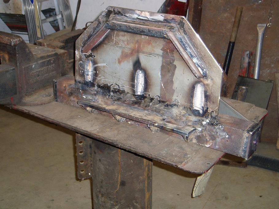

I am building a ripper out of an old plow beam. I thought you all might want to see some pics. As they say a pic is worth 1000 words. This is of how I built the plate.

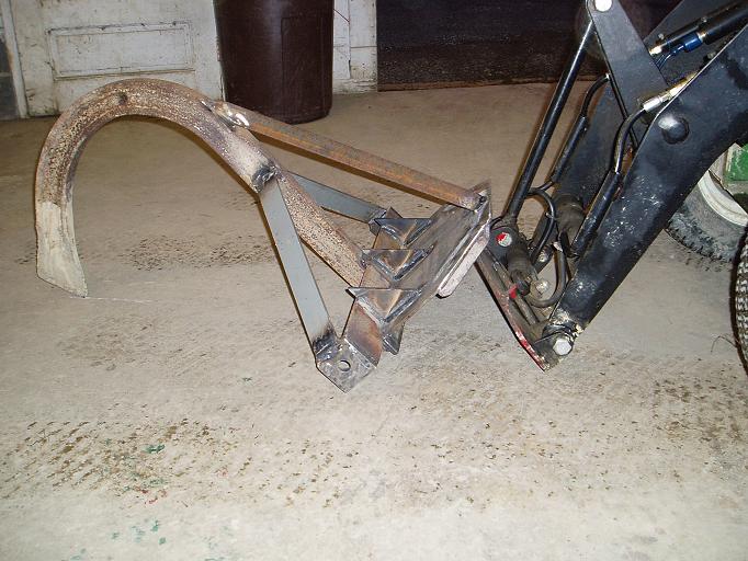

This is how you can attach it to the tractor without handling it. It will lie on the floor and you just tilt the lift into it.

As you can see here I still need to attach the plow sheer and paint it.

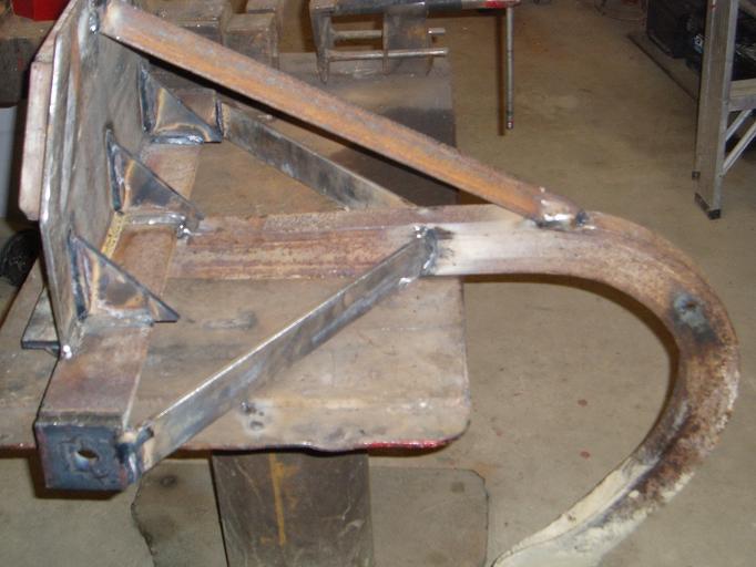

This ripper is built so you can add pins to the side and weld uprights to it for a 3 point hitch hook up.

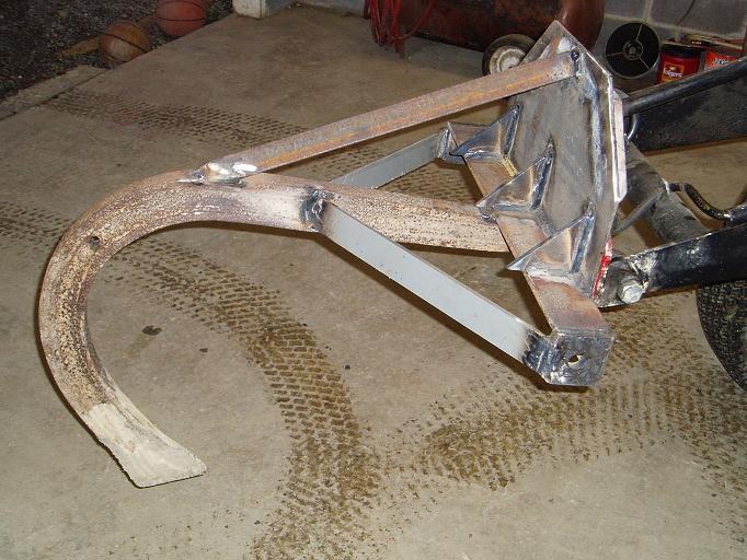

Finished the Ripper.

Yes 14. I think that the potato plow would put more power in its bite because the digging point is closer to the PT. I would recomend to anyone building one that they stick close to the PT design. I built mine like I did because my dad wanted it that way. It was mostly for him. (But it does work well)
