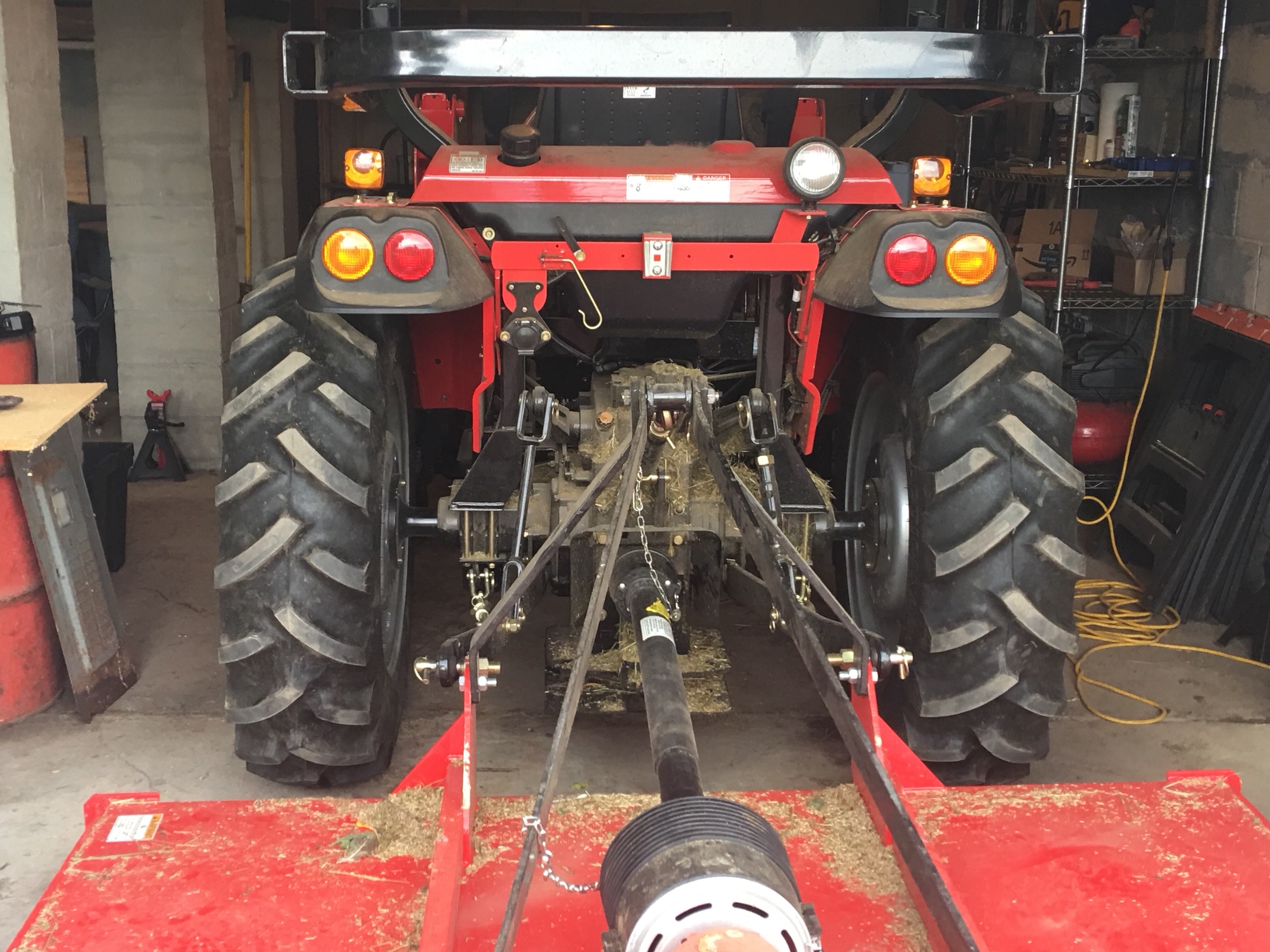

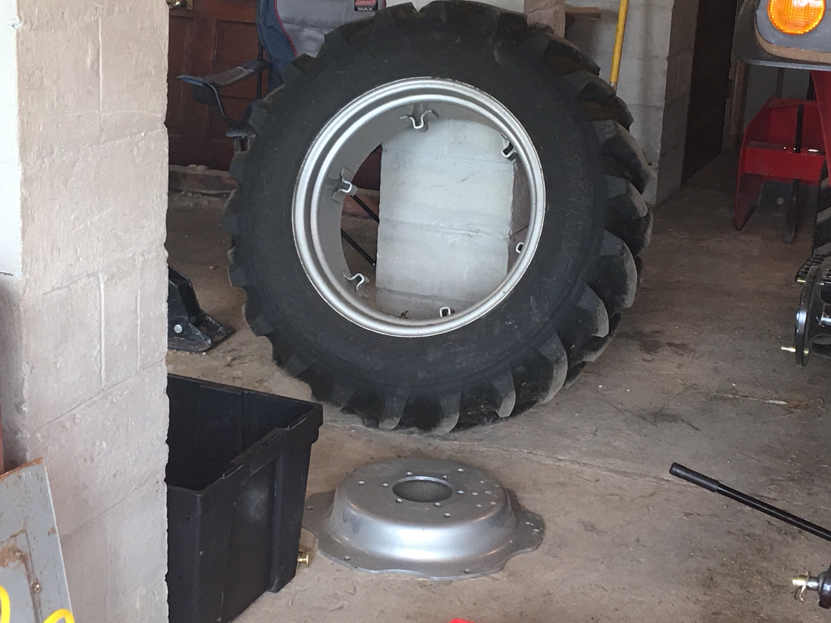

Figured I壇 post these pictures in case anyone was interested. I ordered my 37 with R1痴 and it came with the wheels spaced all the way in. Got a buddy to stop by and help me wrestle them around today so we could get them set out to their widest setting.
Gained close to 6 inches per side.
View attachment 561408View attachment 561409View attachment 561410View attachment 561411View attachment 561412View attachment 561413
I知 going to order my Rk37 in widest configuration. Is yours wider than 5 bushhog?
   / RK 37 wheel spacing
#13
The pictures above are with a 6ft cutter. I can get you an exact measurement next weekend if it would help.
   / RK 37 wheel spacing #14
I ordered mine yesterday. Just trying to figure out what size implements I will need...was thing 5’ cutter as I’m in woods and mountains thinking it might make It easier to maneuver ...if ifs no big deal I’d appreciate the measurement...thanks
