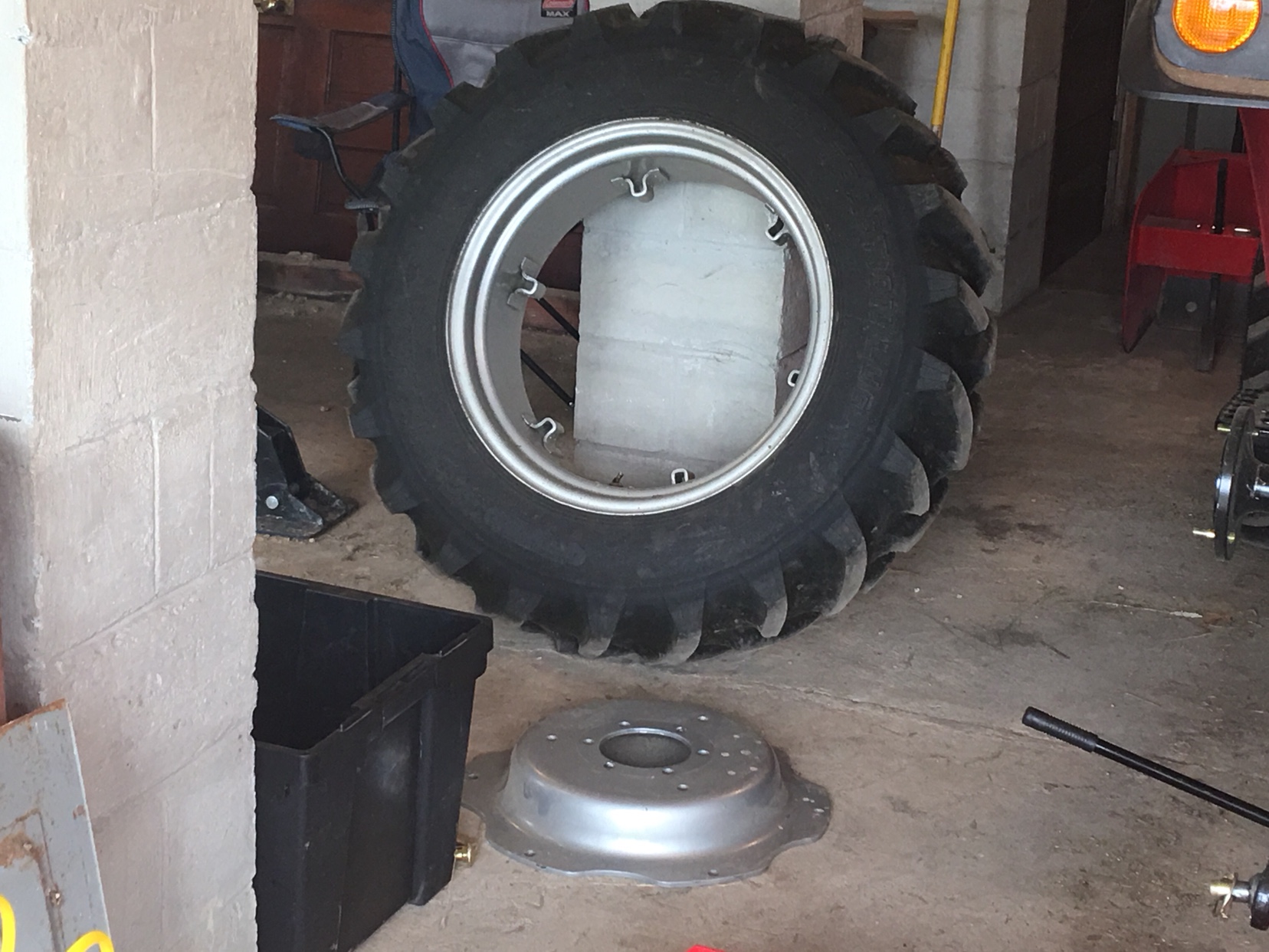

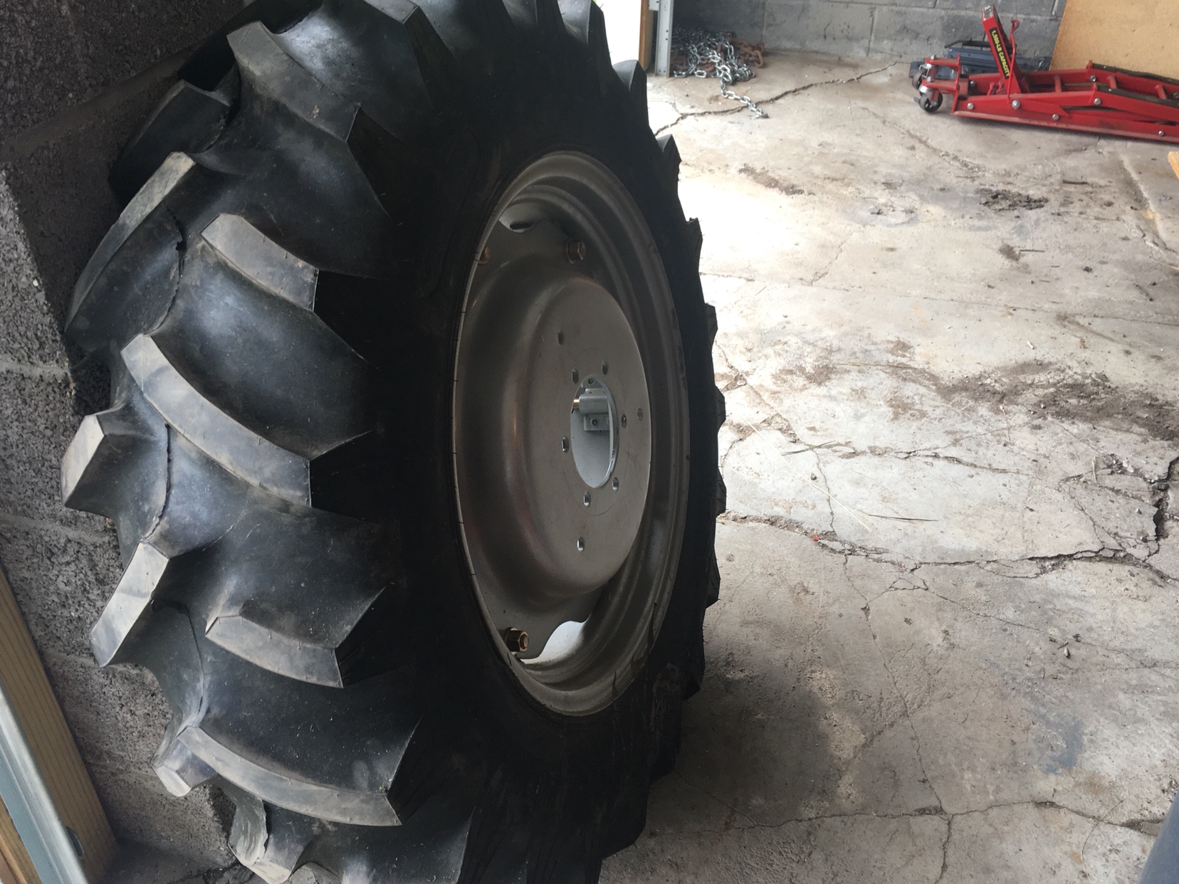

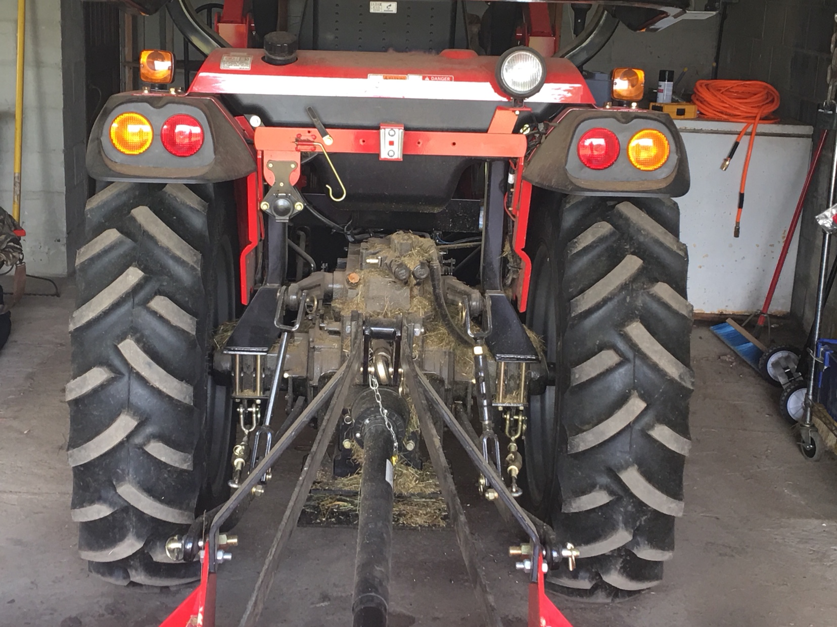

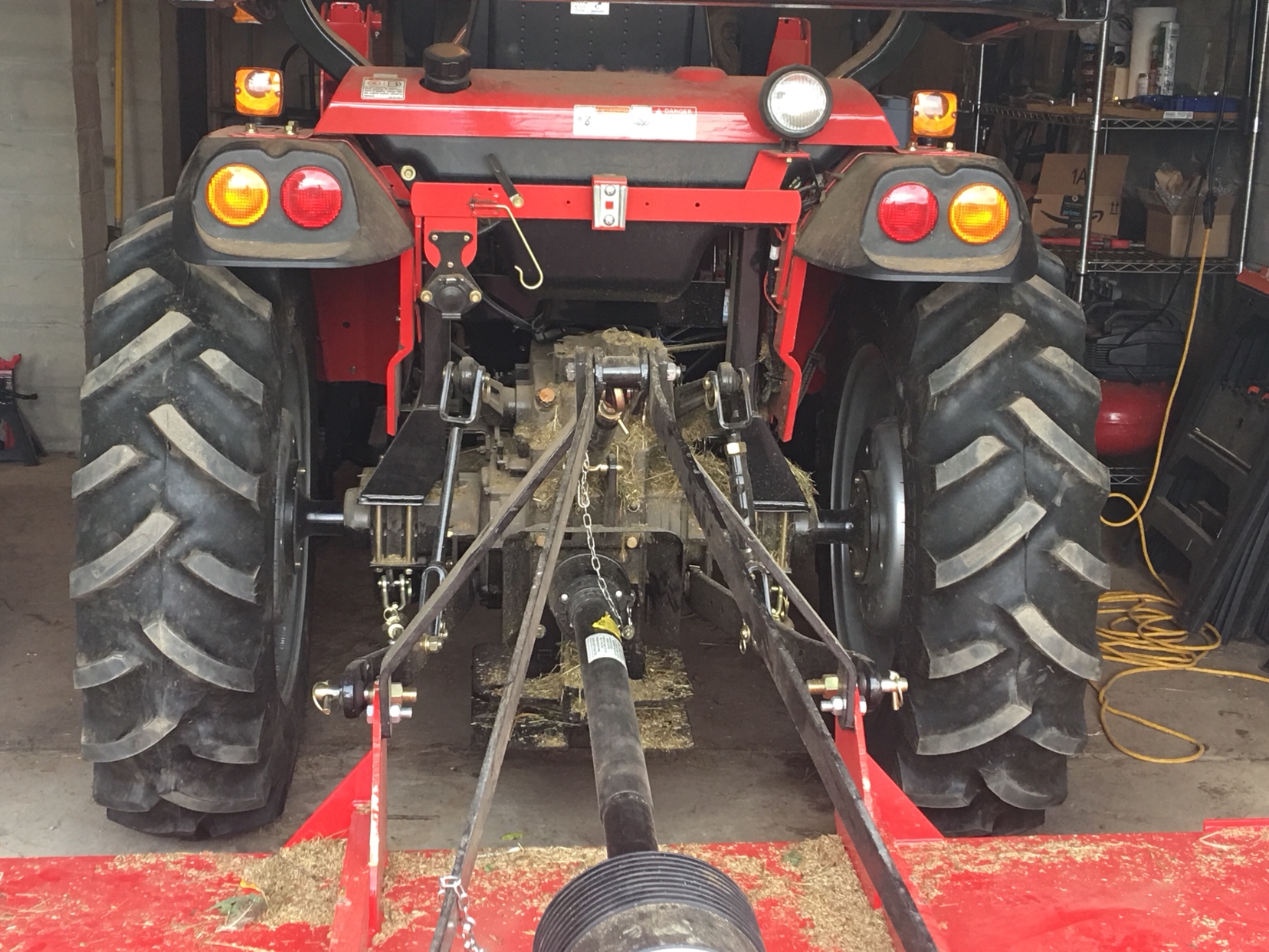

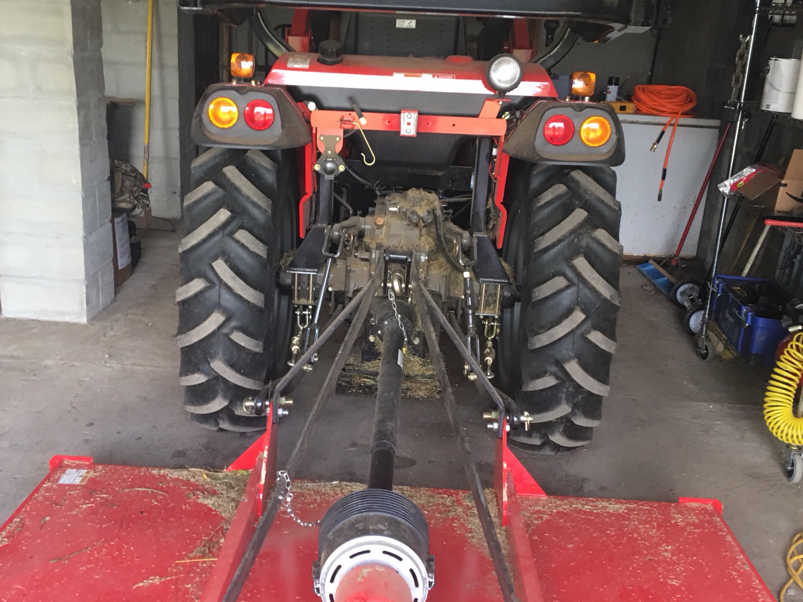

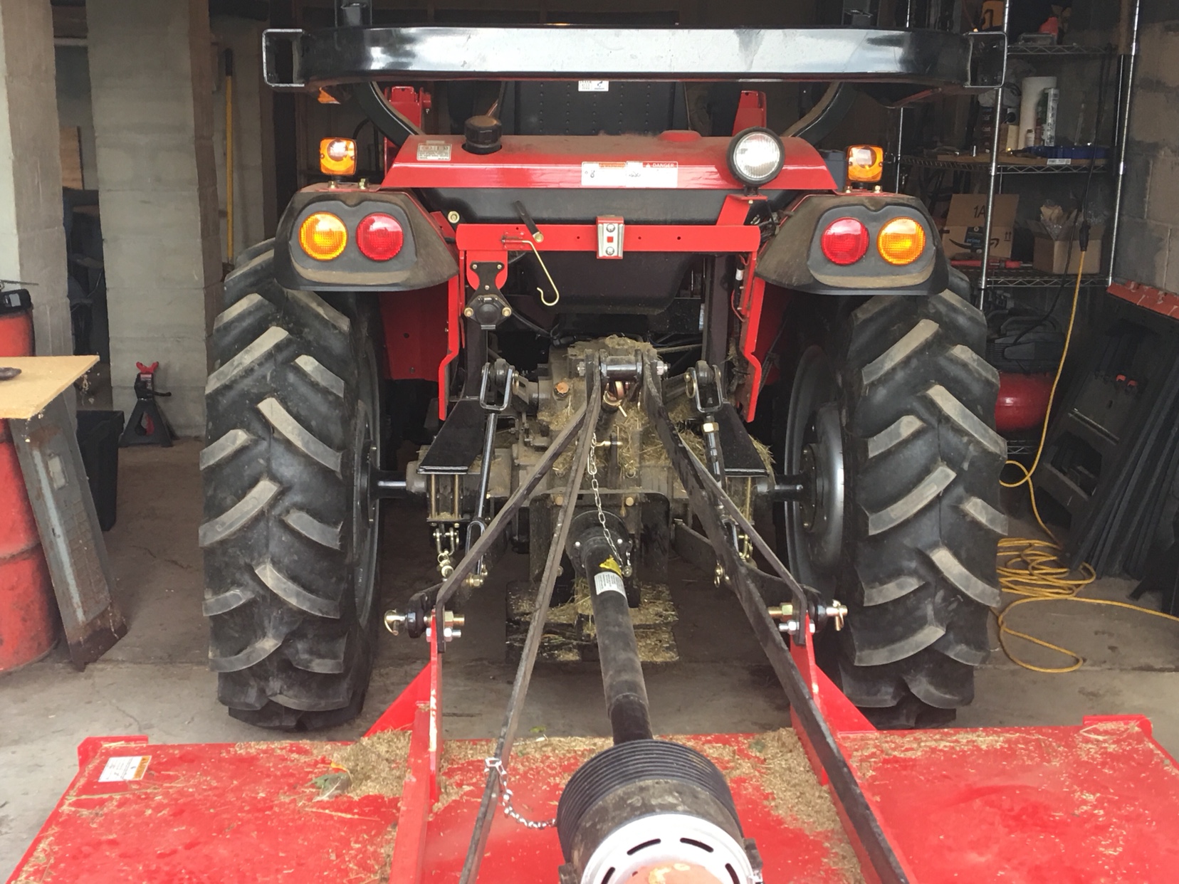

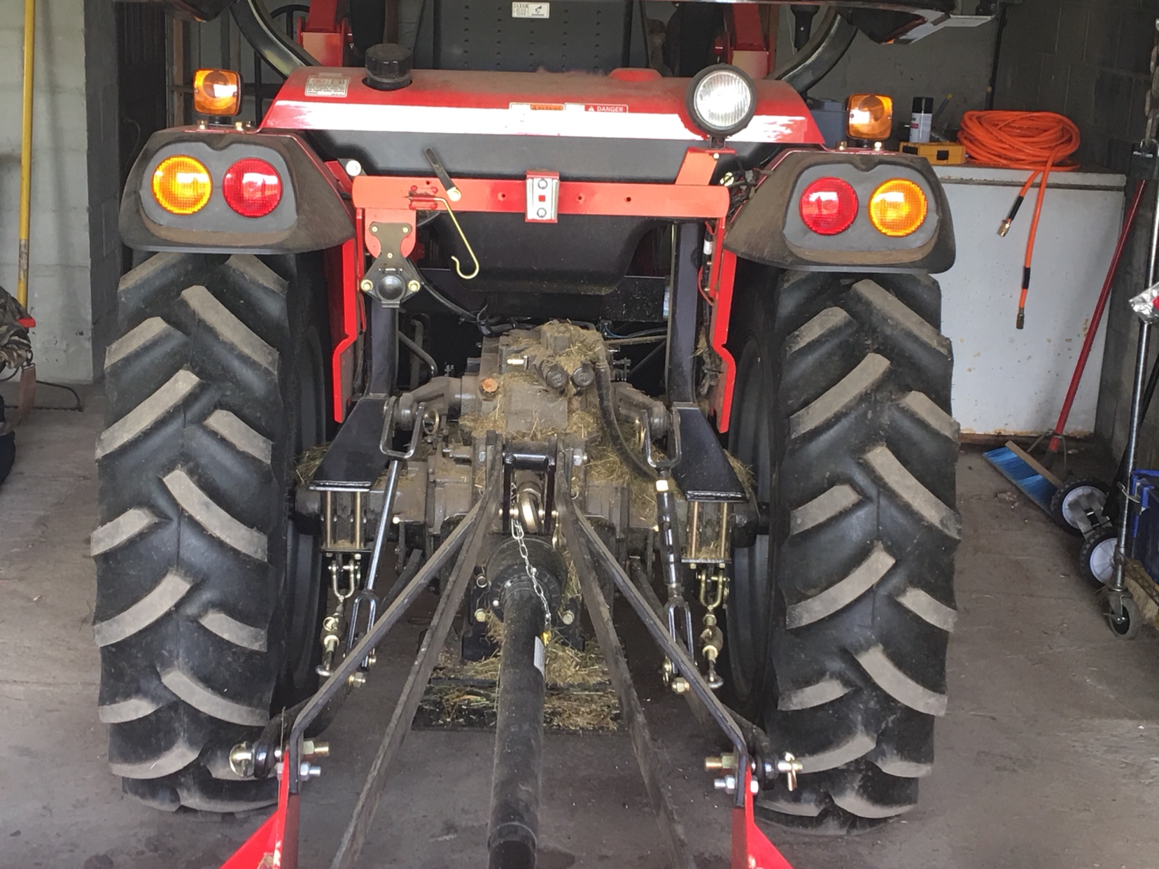

Figured I’d post these pictures in case anyone was interested. I ordered my 37 with R1’s and it came with the wheels spaced all the way in. Got a buddy to stop by and help me wrestle them around today so we could get them set out to their widest setting.
Gained close to 6 inches per side.

Nice job. I bet it was not fun moving the loaded tires. The rears on my Ford 1920 are all the way out too and are loaded. They are too wide for some of my narrow gates, so I will be moving them in a little soon

Sorry that you had to turn the wheels after you received it. Most customer preference is standard mounting. We routinely build wide when the customer requests that when they order the tractor. Hope that you get many years of reliable service from your RK37!

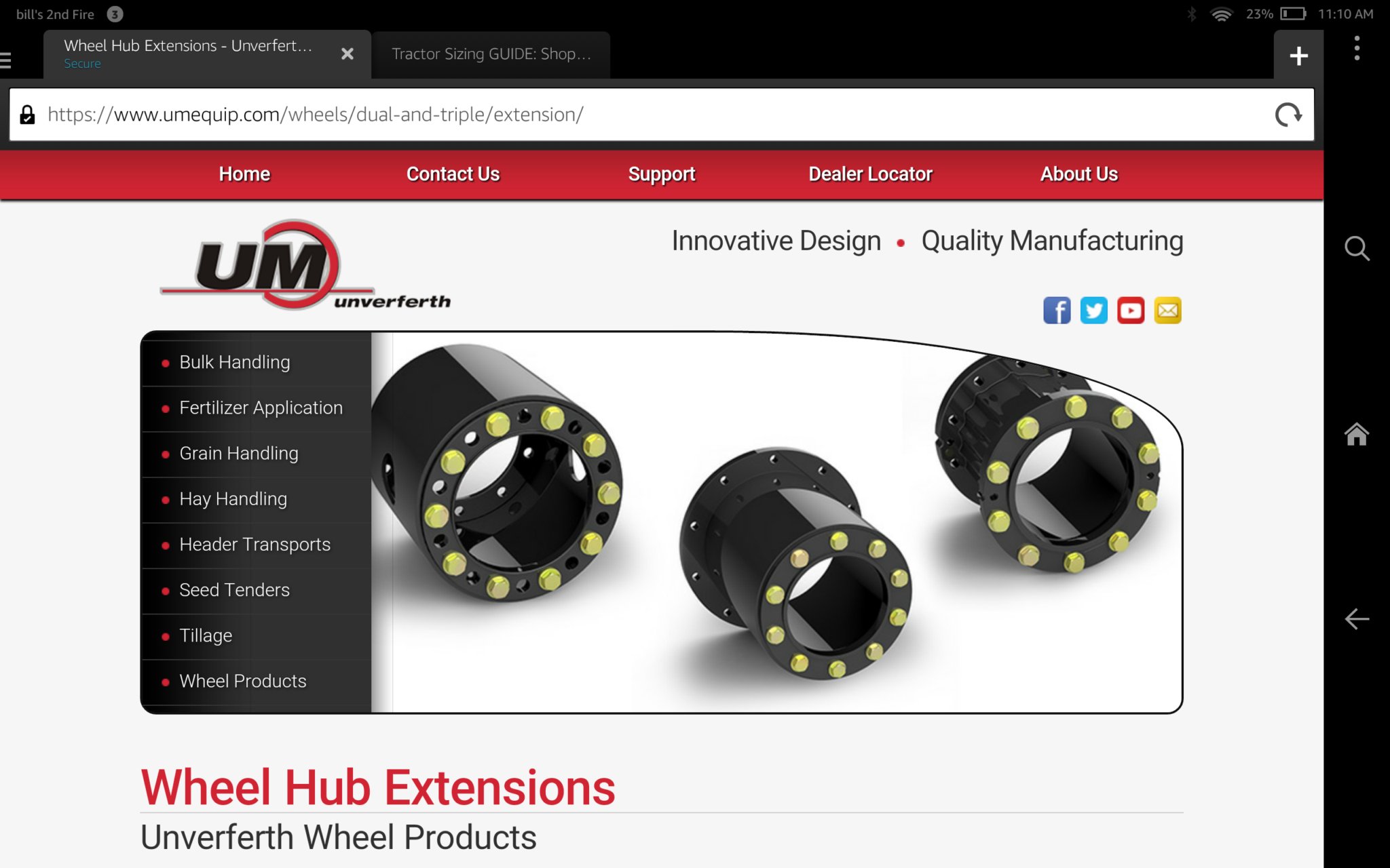

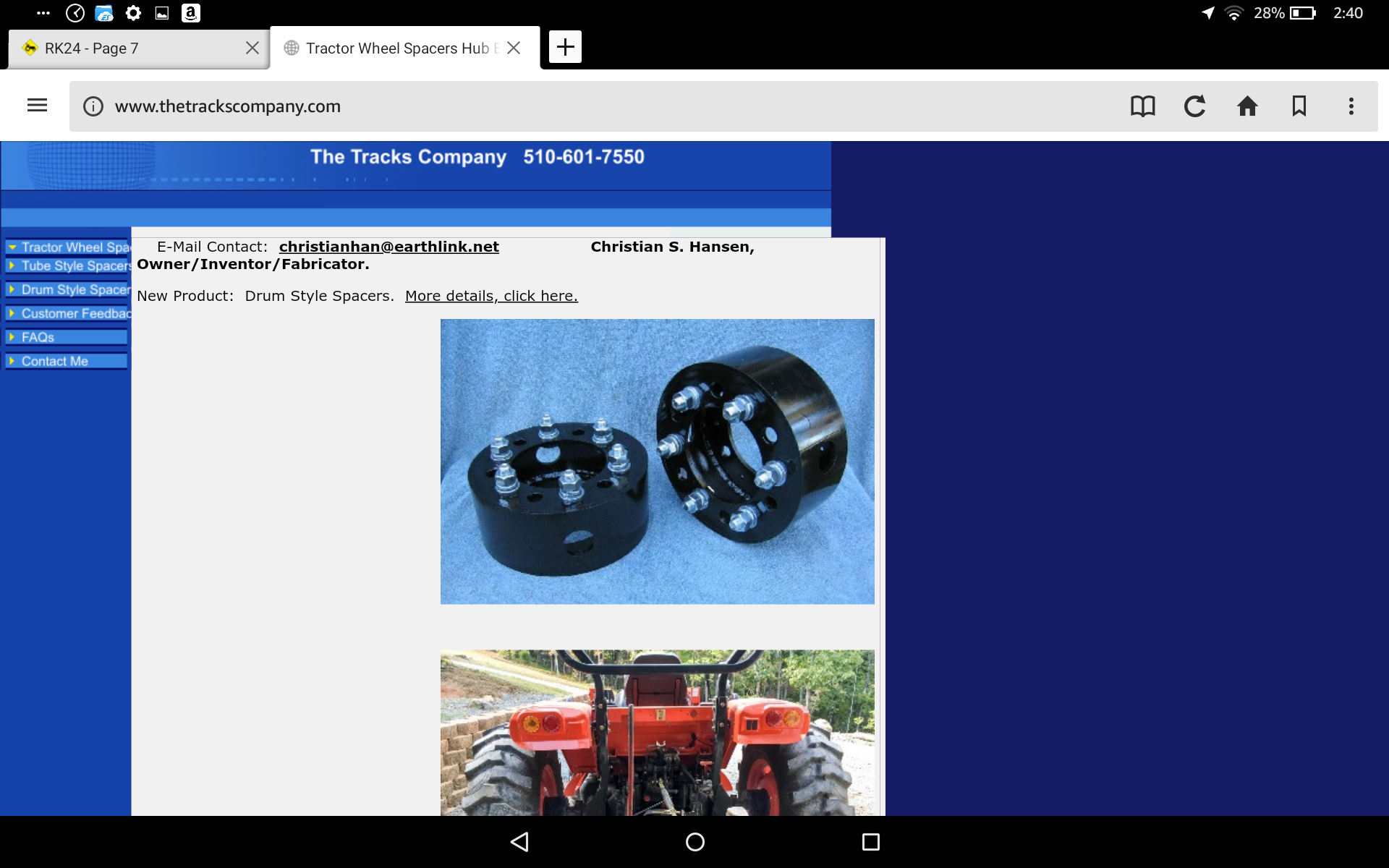

No worries. I didn’t know it was an option until after taking delivery and reading the manual. I wouldn’t mind making it even wider to help deal with my steep terrain but I’m coming up blank with all the wheel spacer manufactures. I’m not sure if anyone knows if the RK’s use a specific lug/wheel pattern that spacer manufactures could reference?
Any ideas would be appreciated.

This may help? The Tracks Company Website is Extensive, spacers for ALL brands.

The pictures above are with a 6ft cutter. I can get you an exact measurement next weekend if it would help.
