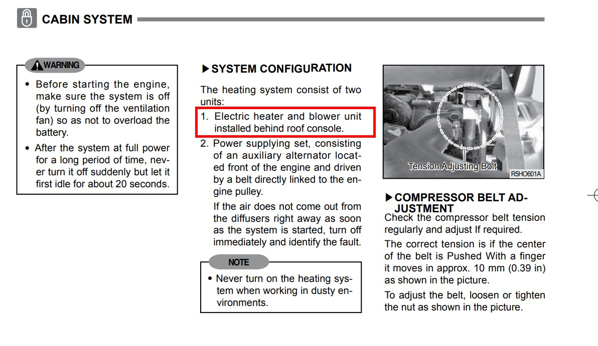

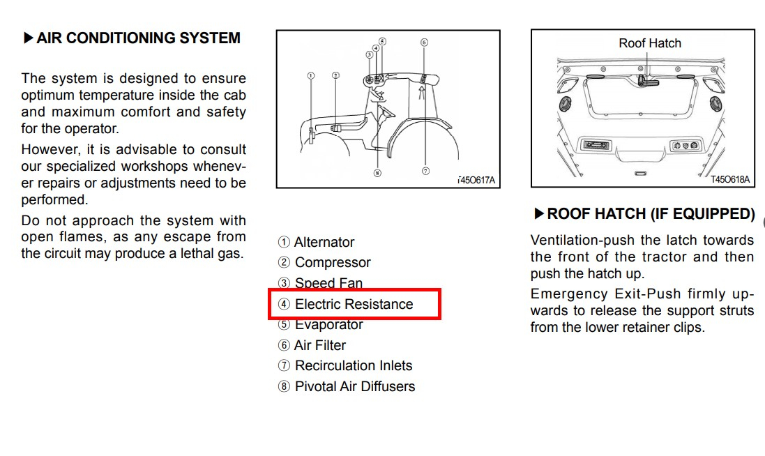

Melancholy, I have the factory repair manual and will see what it says tonight regarding the A/C system. As far as repair manuals go it’s pretty crappy, but it may have some useful info for you.
Thanks. I'd be curious to know how many kg of 134a the system takes in case I do need to charge it myself.
I always clean the radiator and condenser screens, but if I can figure out how to get the screens off without disassembling the entire engine bay framework, I will clean the condenser coils with air and water. I'm hoping that's it.
(It's crazy how hard it is to remove those screens, particularly with a front-end loader in the way.)
