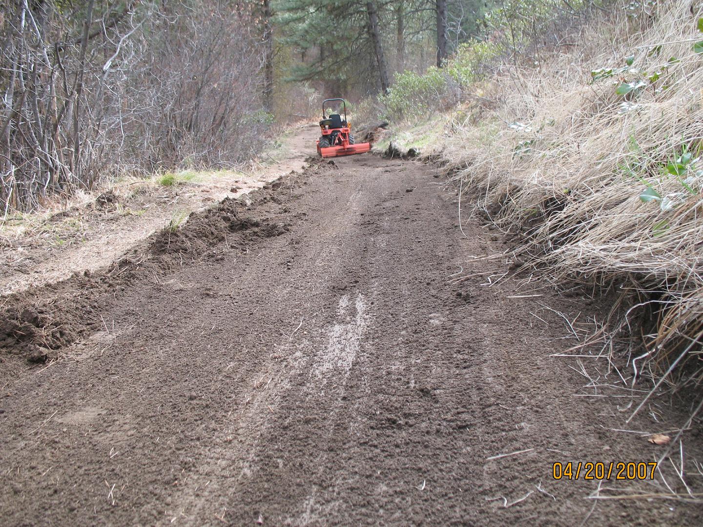

Before I bought my 96" landscape rake with flip down blade and guage wheels I spent lots of time reading all the road maintenance threads here in TBN. I found a TON of useful info - including reasons to start with a box scraper, a back blade, pull-behind road grader and a landscape rake - clear as mud.... :D
In any case, I was just re-reading your original post in this thread and it occured to me that you may be in the same situation as I am whereby you need to maintain a nicely built road with a good top coat of gravel (I assume this is what was implied by a new road "built to county specs..."..).
I have found the rake with blade to be real easy to use. I can get a good crown (or re-crown as the case may be) by cranking down the right top link. I start by using the blade to cut in and drag gravel in from the sides (angled). Then I flip the balde up and make a few passes with the rake. The last pass is with the guage wheels down. I also find that it's easy to scrape gravel up and then back up and push material back into low spots with the rake. I also like the visibility of the rake - you can easily see the material you are working with.
The only problem with this setup is cost - but if your road is good enough you could skip the fancy models with the blade option and add wheels later. Also the rake and blade are not going to rip down into hard packed material like scarifiers on a box scraper do. So ultimately you'll want both I'm sure.
