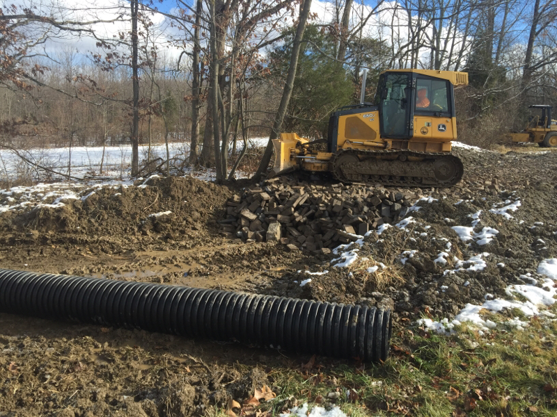

Is this enough base for a driveway?
FYI, it's not just deep for the culvert. There's places along the driveway that are much deeper because of the soil.
