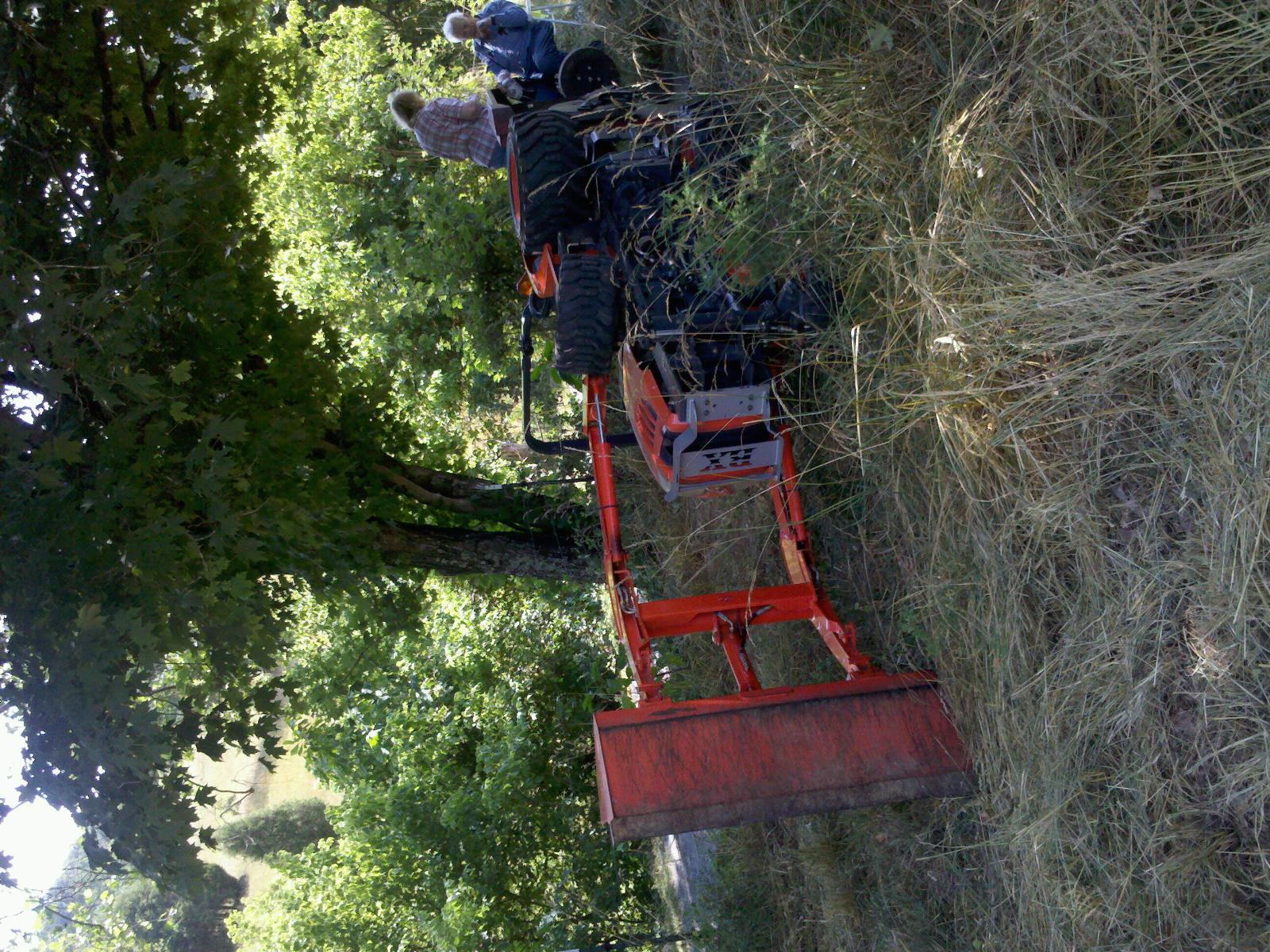

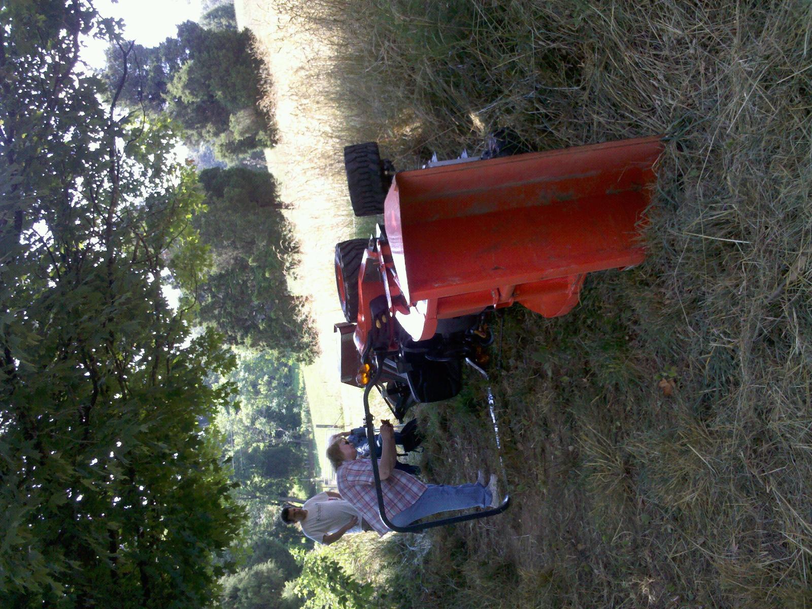

Careful on the slopes. My Dad just turned over my BX24 on not much of a slope. He was wearing his seatbelt and the rollbar was up. Or...he'd be dead now. Kubota1.jpgKubota2.jpg

Glad you dad is OK Beemer, hope he learned from his mistake as second chances are hard to come by. Keep that bucket down at all cost.

Careful on the slopes. My Dad just turned over my BX24 on not much of a slope. He was wearing his seatbelt and the rollbar was up. Or...he'd be dead now.View attachment 272665View attachment 272666
By the way the pics looked the bucket was up a little high. That is one thing you learn in the big equipment is to carry the bucket low, it doesn't take muck to turn it over.
Good thing is nobody got hurt.
