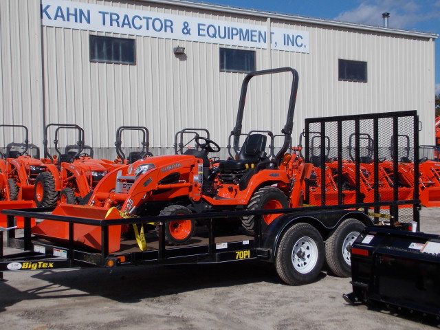

At a minimum, you could get by with a 14-foot trailer. However, a 16-footer, is not that much more money--about $200. And a 16-footer would give you more options for carrying more stuff.

Definitely don't get a single axle trailer, as you have nearly zero tolerance to adjust tongue weight (it will be what it will be, whether or not it's safe or your tow vehicle can handle it). I'd get a tandem axle landscape trailer, probably 16', though 14' would be plenty long for a BX and some implements.

I would love to see a picture of a BX with BH on a 14ft tandem. I borrowed a 12ft single axle to get my tractor to the dealer and back but I had to remove the BH and the FEL hung over the front. I went slow and wasn't comfortable but it worked just for the short trip. I have a tight turn around and I doubt the 16ft tandem will fit. 14ft tandem will be a squeeze but I sure like the idea of being able to haul the tractor with rear implement on with a tandem and surge brakes. I had that tandem and surge for my 22ft boat and that worked great over mountain passes, etc.
