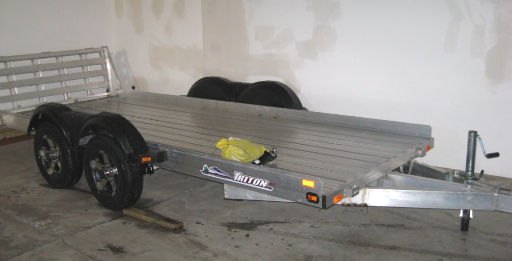

I have a BX1500, loader, mower.... I bought a Triton, aluminum, 14 foot, dual axle, electric brakes and think it's ideal for the BX. You could fit a BX on a 12 foot, but the 14 just makes it easier to balance.

Don't go out of your way but if you do have a loaded pic that would be great! I am really interested in the shortest tandem that will properly hold my BX25 with a rear implement (BH, or blade). I have a tough turnaround situation.
   / Road trailer for BX2350 w/FEL and MMM? #29
Here is a photo of the trailer, I could not find one with the tractor loaded. If you have rear attachments I don't think you would want anything shorter than 14 foot.
