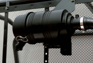

The rpm drop got to be a real problem on the return trip. 2 hours to go 9 miles. 6 miles of the trip run by a river and the only significant climb is to cross a railroad overpass. Very gradual 1/8 mile. After the first ~2 miles rpm's dropped, I eased the hydro pedal and they recovered. There's no doubt this was on the flat. Zero incline
But now it got interesting. At first I thought the hydro was doing something strange so I pulled into a lot and checked everything - oil levels good, confirmed not in 4wd, parking brake ok. Everything was ok. Coolant temp on the gauge never left the mid-point. Restarted the journey and it got progessively worse to the point where I had to stop and let the engine recover, but as the trip continued the engine would 'hunt' - rpm's would recover to 2800 then drop to as low as 800 then back to 2800 - during these rest phases.
I kept moving since I wasn't going to leave the tractor by the road overnight and it got to the point where the engine would stall during the rest phase. It restarted immediately but this was really frustrating since by now I was making 100ft legs on the last couple of miles. Well, really short runs.
Finally made it home and with my neighbor's help we deduced what we think was the problem. Ruled out hydro becasue of the hunt while standing in neutral with clutch in. Had to be either fuel or air. Fuel seemed unlikely since the engine would restart right away after stalling - no hesitation or cranking. That left air so we pulled the air cleaner for inspection which was apparently perfect, no birds, rocks, sand, dust.
Then we noticed that the actual air intake is a small diameter hole - maybe an inch - that had a rubber cone with a narrow slit for air to pass through. A shipping cone?
Yesterday was one of the hottest so far this year, mid 90's, and I think the rubber heated to the point that the engine could suck it closed, then when the rev's dropped it expanded to let more air in. I'm guessing it's an item the dealer forgot in prep.

Does the air filter look like this:
If so, the pointy thing on the bottom left (in the picture) is not the air inlet, rather it is a dust catcher and that should let you dump whatever dust it has collected without needing to open the filter

Yeah, after I posted I looked at the manual and then the tractor and it was a 'duh' moment. Kioti calls it an "evacuator". It's on the opposite end of the canister from the intake.

Dust? I think that's a drain for water. Some of us have been known to try and drown our tractors, so having a water dump on the canister keeps the engine from breathing water, since that is the lowest point on the filter canister.
Bherr it sounds to me like it could be a fuel delivery issue. Take the filter off clean it or replace it. Then dump a quart or two of Power Service in the tank. But since it's brand new, I think I would just have my dealer take a look at it.

Dealer is scheduled to look at the punch list next week. Trivial stuff except for the rpm's deal. He suspects fuel issue also. Fuel filter looks "twisted" but I'm not sure if that's normal or not. I suspect not.
