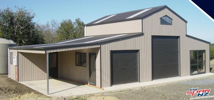

Hoping to do something similar to this in the near future. Concrete cost is the killer but you have to have it. I want a vehicle lift in the center section. shed.JPG
