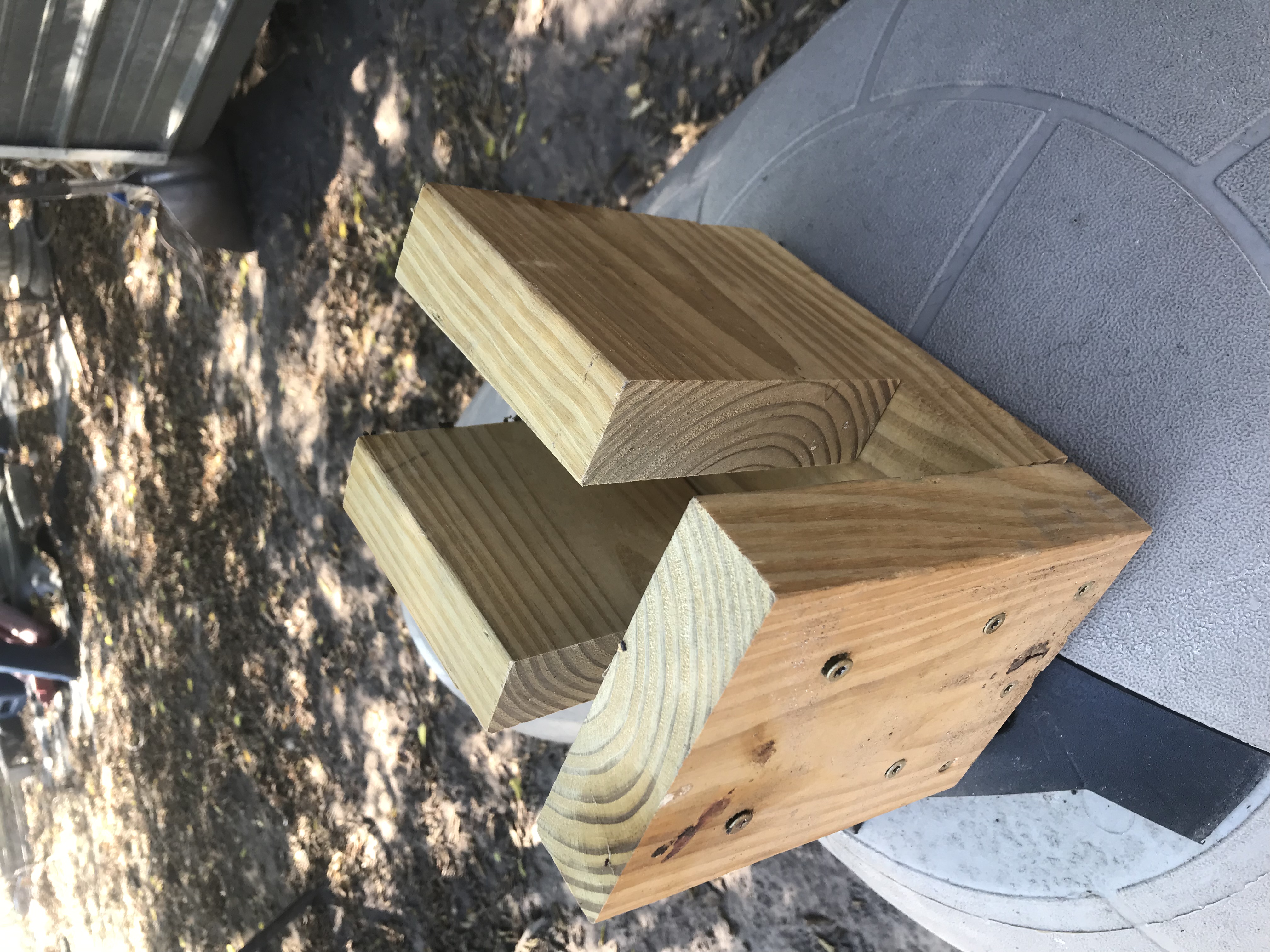

It was difficult trying to hold a 2x6 rafter up and nail it. I cut four small blocks of 2x6 and fashioned a cradle. Climb up ladder with trusty ol Ryobi impact driver and screw it to header. Slide one end of board in and nail other end up. Worked pretty good and fairly quick with the impact driver.
