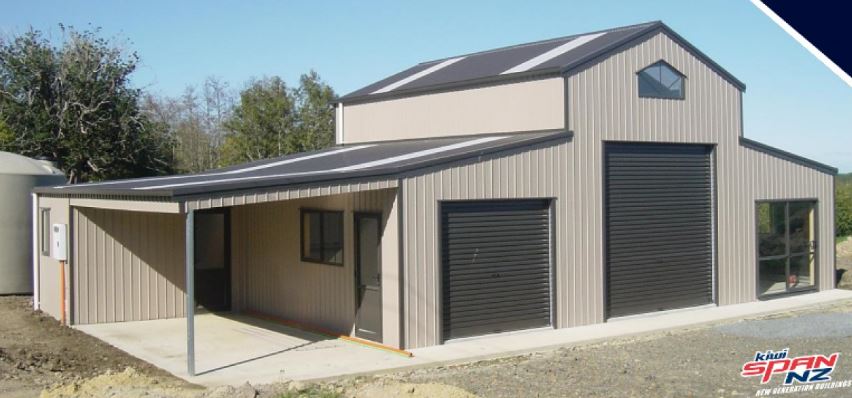

Hoping to do something similar to this in the near future. Concrete cost is the killer but you have to have it. I want a vehicle lift in the center section.View attachment 619379
When I was getting quotes last year, one of those buildings was almost the same price as getting one that was a clear span for the size of the enclosed building and the height of the center section, that would give you a lot more free space and more cubic feet under a roof.

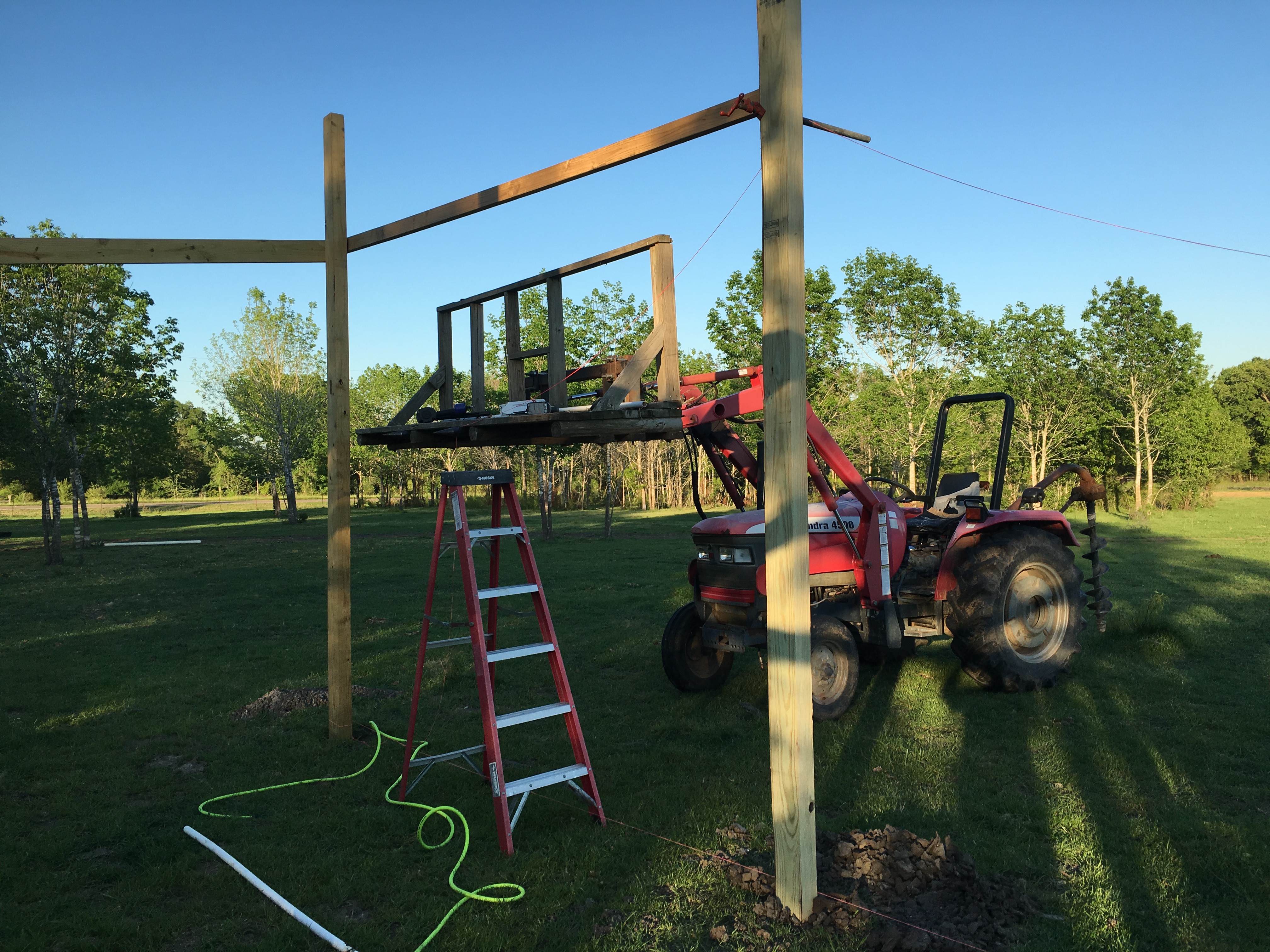

I built a shed in 2016. 4x6 posts, 2x6 rafters and frame. 40’ wide, 22’ deep. Didn’t know what I was doing, just did it by myself. Turned out ok. If memory serves I think I spent around $2500. The corrugated tin roof was free used material from my stepdad. I think if I had to purchase it the cost would be doubled. Lot of up and down a ladder and a platform on the hay forks of tractor.
