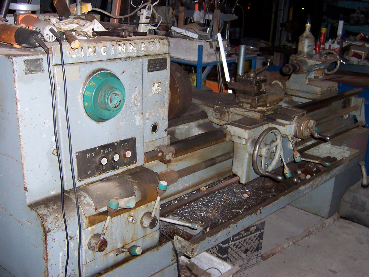

I'm running this 15' X 54" Cincinnati Hydrashift lathe (5hp) and 2 Scotchman Ironworkers (3&5hp) on a static converter that I built for $45.
3 Phase machines will use single phase for smaller electrical use items. For single phase they just use 2 legs or 1 leg and neutral for 120V.
My lathe uses 120V single for the relays that control the motor. When I first hooked it up I had the phantom leg in the wrong place and it would not work. All I had to do was shift the connections.

I have been using my converter on my lathe and Ironworkers for about 10 years with no problems! The ebay guy is mis-informed about these items.
I never run my machines wide open anyway which would cause problems.
Both my Ironworkers are hydraulic machines.
I had a Buffalo 3 ph Mechanical Ironworker which ran great also but I sold it because it was too scary! When you stepped on the peddle something was going to get cut or bent!
The 50 ton Ironworker is rated to punch a 1 1/8" hole in 3/4" steel!!! That probably won't work with the static converter.
