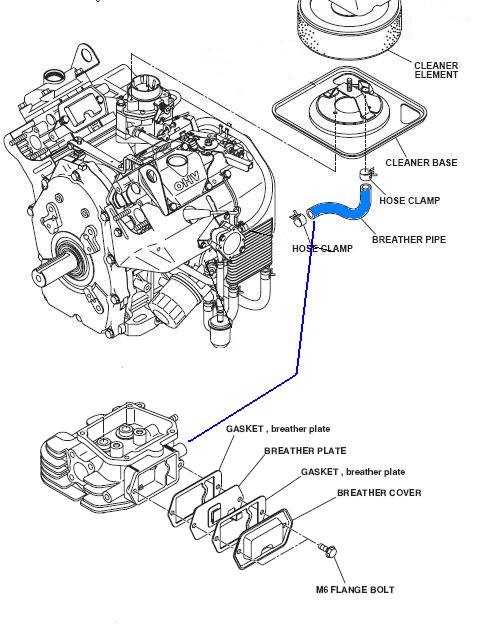

I recently (week ago) completed a tram pump replacement on a PT-425 with 500 hours on it. Got the pump back from Terry and installed it and all looked good.
Mowed with the unit for nearly 2 hours without any issues, Lots of power back on the wheel motors and everything looked good.
Mowed today and got 5 minutes in and lost engine power quickly over 1 minute time. The engine was running but skipping and popping alot. It finally quit on its own and when I tried to re-fire the engine all it will do is pop and backfire through carb really bad.
I went and checked the compression on each cylinder to see if I broke a valve or something and got very good numbers 150# plus. Exactly what I saw a month ago while I was troubleshooting power loss on wheel motors.
I have seen many post about floats sticking in the carb so I checked engine oil and level looked fine and smelled normal. I have a Quick Disconnect fitting in my fuel line so I can remove gas tank easily. So I disconnected fuel line to prevent fuel from dumping in like many others have had.
When I first pulled the air filter it had a little extra gas and oil on the metal cover. After several attempts to start I have alot of black oil now on the cover.
Any thoughts.. Where do I start ?

Oil in the air filter?
Possibly a malfunctiong PCV (positive crankcase ventilation) valve? The PCV valve allows the air intake to keep a suction on the crankcase to keep it under a vacuum during operation. This prevents gas fumes or exhaust fumes from building up in the crankcase. Robin calls this the "breather plate".
The PCV valve essentially acts as a check/float valve to keep from sucking oil out of your crankcase. If it failed, it could allow oil to spray into your air filter. If clogged, it could also possibly affect the operation of your manual fuel pump, which relies on pressure/vacuum pulsations in the crankcase (caused by the moving of the pistons up and down) to operate.
In the picture below, you can see the "breather pipe" which connects your carburator to the "breather plate" (PCV) on the cylinder head.
attachment.php

Terry had it. Even though I had 150# compression he still had me pull the valve covers. Sure enough Cylinder #2 exhaust valve rocker arm was loose....loose....loose.
The pivot bolt stud had backed out of the head. I was surprised to see it backed out and not broke off. Terry had me call Robin to confirm next step of action and Robin just said, "Apply red loctite and torque to 15 ft lb and then do valve adjustment and should be fine."
I performed those steps and started right up.
