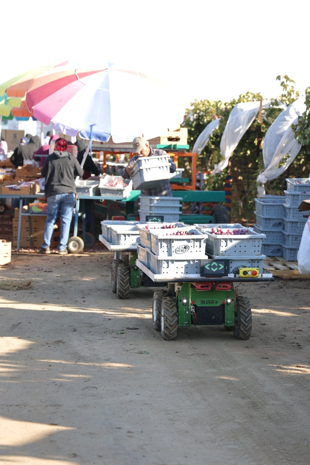

60,000 hours of operation at this point with about 100 running last year. Mostly in table grapes (moving around fruit, scouting, picking), blueberries, caneberries, and nurseries.
Now adding mowing, exploring spraying, and of course expanding autonomous picking capabilities. Will be showing our newer generation 8 machines at Booth GS6 at the World ag expo February 8-10th where we are a top 10 product for the event.
If you had a little machine that could run routes autonomously (up/down rows, in patterns, back and forth on routes) - what types of things might you want it to do? Spraying, mowing, hauling, towing, others?

rScotty, yes of course. Most fresh produce in the US is grown in California. This year, min wage has been set to 13/hour and you can work crews for 50 hours a week before you hit overtime. Next year, that clicks up to 14/hour min plus a limit of 45 hours / week before you hit 1.5X overtime. The year after (2022), that clicks up to 15/hour and just a 40 hour work week. In essence, each year by law labor gets 7 to 8% more expensive, and 10 to 11% less available.
In short, the particularly labor-intensive crops are hitting a threshold where labor renders them no-longer sustainable. This is why 80% of the worlds almonds are grown in California - it's one of the only high-value crops that can be all machine harvested. For table grapes, caneberries, stone fruit, fresh market blueberries, and many other crops, there's no mechanization available.
This is where our Burros slot in. Autonomy you can buy today (there's virtually nothing else on the market) in a people-scale platform that can later be expanded towards further automation.
We are constantly thinking about the what else to add question also. Should we add a 26 to 33 inch mower deck to mow for example? We generally look at these questions through the lens of labor - if there are a lot of people doing the work, there's likely high value via automation.
String trimmer for fence / base of trees option?

Max hours on machines are around 4000, lowest in the 500 range. This is from 1-2 seasons of use only which seems like quite a few hours.
how many hours are on your 584 IH 4WD? Over 3-4000? Having worked in the industry, and grown up around a lot of equipment, even the oldest stuff we have on my family farm (Farmall 404s) only have like 6-8000 hours and they are from the 60s…
We’re now working on a 33 inch electric deck on one, which could run for about 7-8 hours and in theory do 5-6 acres in a day - likely use would be up/down rows mowing though in our view (in grapes, berries, etc.) where the robots can easily go up/down rows sequently to get through a full block.
When you say string trimmer you mean to get up against perimeter stuff?

500-1000 hours = one season of use 6 days a week 5-8 months of the Year. Max machines have 2 of that and are working well.
What seems to matter most to people from what I’ve seen is primarily fhow well an autonomy stack handles variable situations - i.e. how many miles or hours can a machine run while driving the way it should drive in a very variable world. A CNC Machine does a repeated task in a fixed environment - a robot driving on farm does a repeated task in an unconstrained dynamic environment that changes Hour by hour day by day Etc. That seems to be the hard part...

AGM is base option - most growers have been going for LFPs which are supposed to be good for about 4000 cycles, are much lighter/higher powered, and still reasonably priced.
