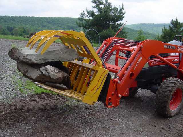

I had the same concern with my L3830 w/LA723, so did my dealer. Here is the solution he came up with. Not nice for the fine stuff, but it does'nt eat up to much payload.
