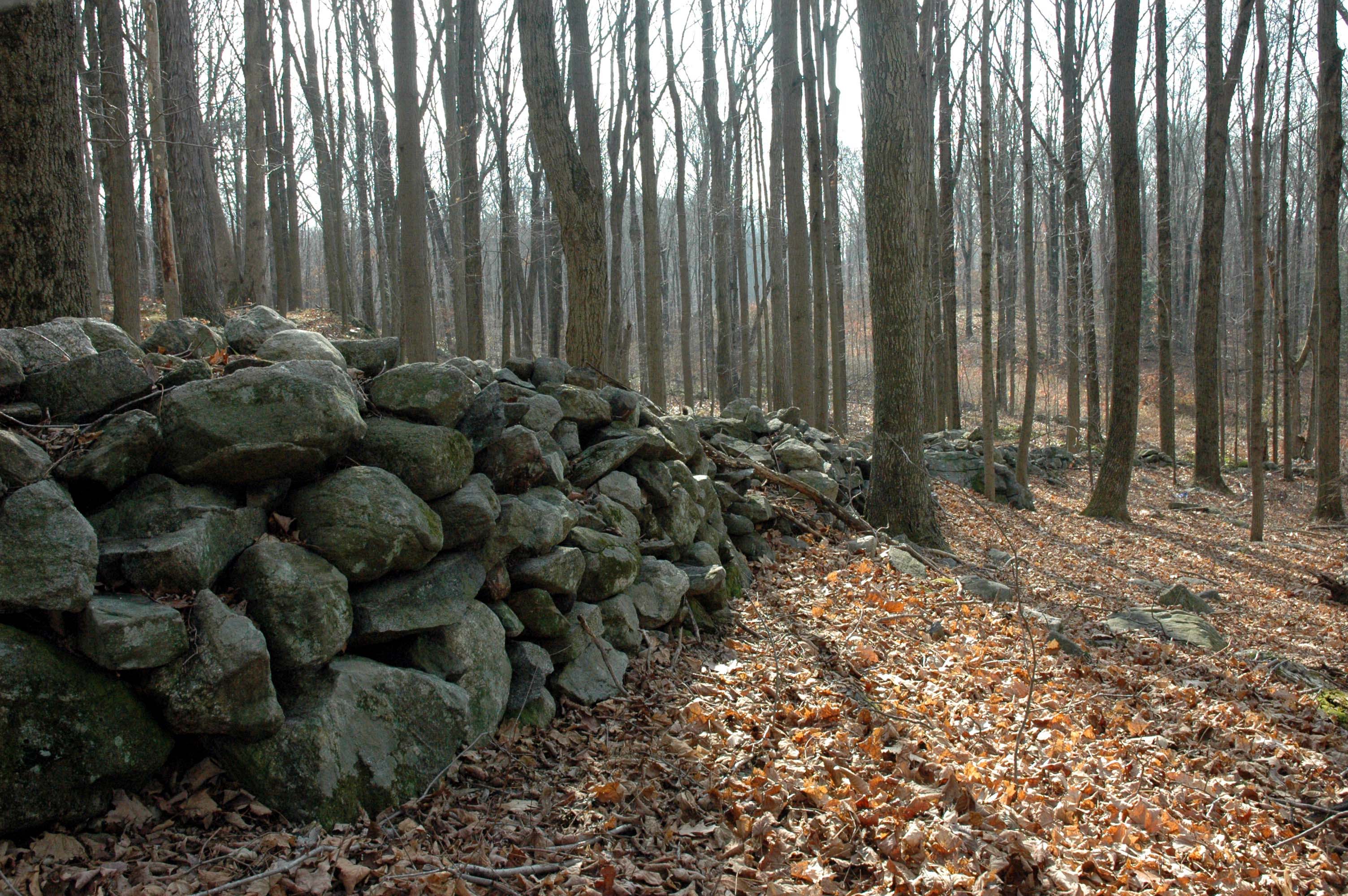

Living in the rock capital of the U.S./the North-east;the real farmers around
here us a skid-steer/rock bucket.My farm has been in use for at least
150 years and I am still "picking" rocks.I have miles of rock fence and piles
every-where.
every-where.
Why do you think New England has more rock walls than wood fences...:)
