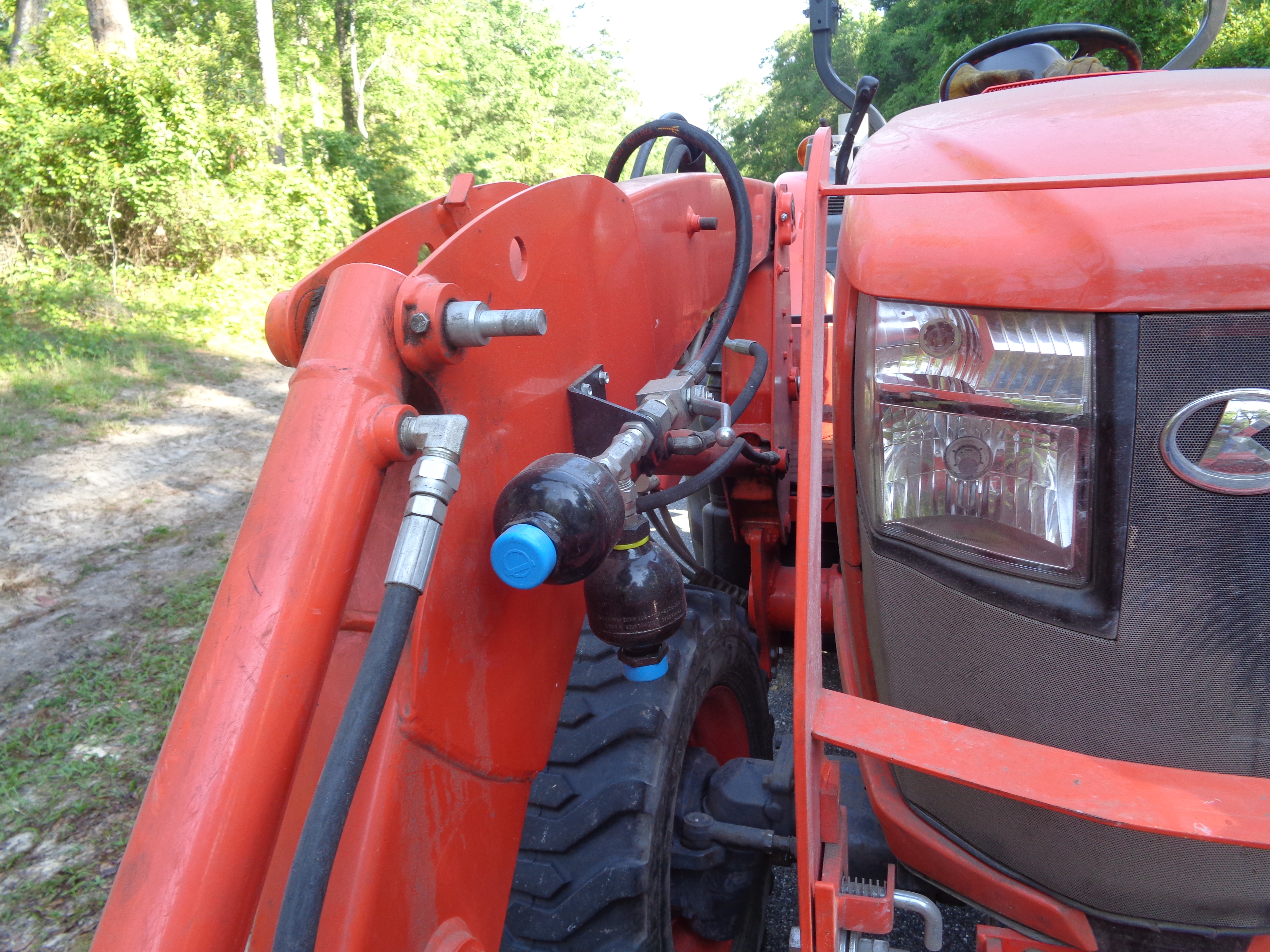

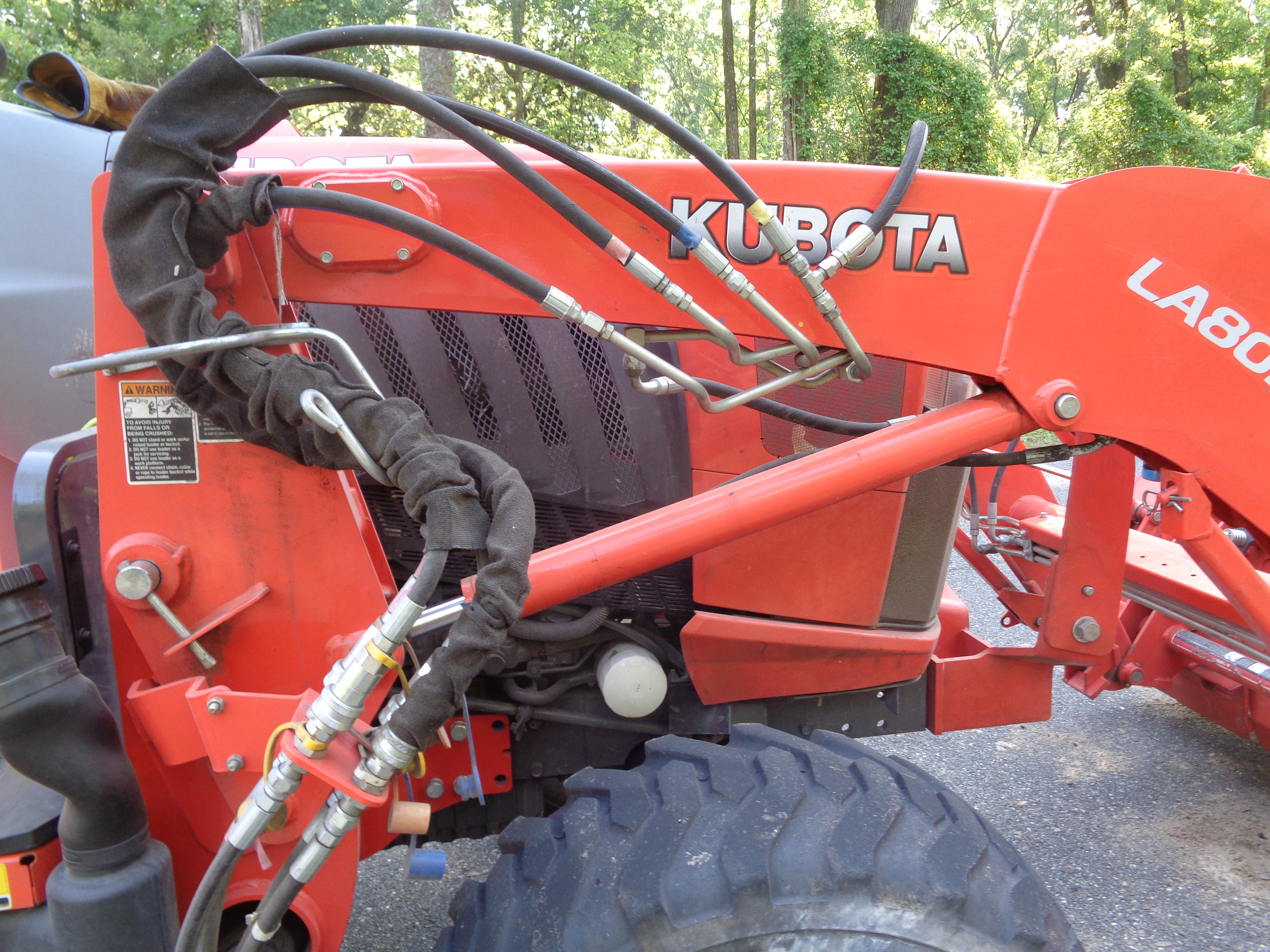

   / Rocking horse ride #8
#9
I'll try more speed, it does with no load in the front, and I'll putting some more weight on rear 3pt
