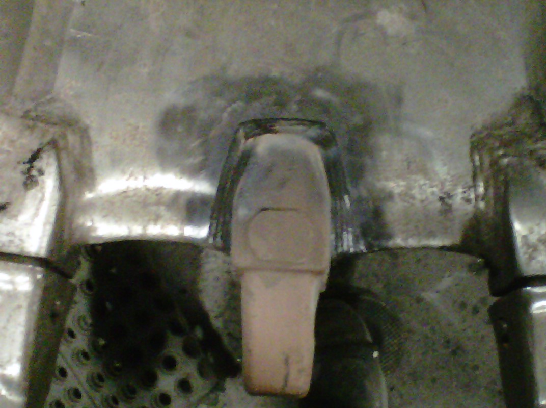

Ive done a lot of cutting edge install and replacement on bucket's graders ETC. I know our steel classification in Canada is different then the states. But here an AR steel is an atmospheric steel usually used on bridges where it doesn't need to be top coated, It has higher amounts of nickel in it to prevent corrosion.
For cutting edges that we have to get custom made, we get them generally made of a QT steel, which is not a mild steel, Its carbon content is higher and is quenched and tempered. They have grades from QT-100 - QT- 400. (there may be more but is what I am familiar with)
QT 100 is what I think you Americans refer to as T1 steel.
As far as welding it, I use 7018 or a t9 flux core variant that has the same finished properties as 7018 (hardness, notch rating)
The thing with this stuff is preheat. Not just the material you are welding, but the surrounding area, post heat treatment is just as important as preheat. If it cools to fast it can lead to cracking and weld failure.
On this bucket that I replaced the tooth mount on, I preheated about 2 square feet to about 120 degrees (Got all visible moisture out of the steel) and after welding I covered the tooth with a welding blanket and after 2 hours it was still hot to the touch. tooth.jpg
So preheat an IMO I wouldn't use a 60XX rod. Stay with 7018 and you should be fine
