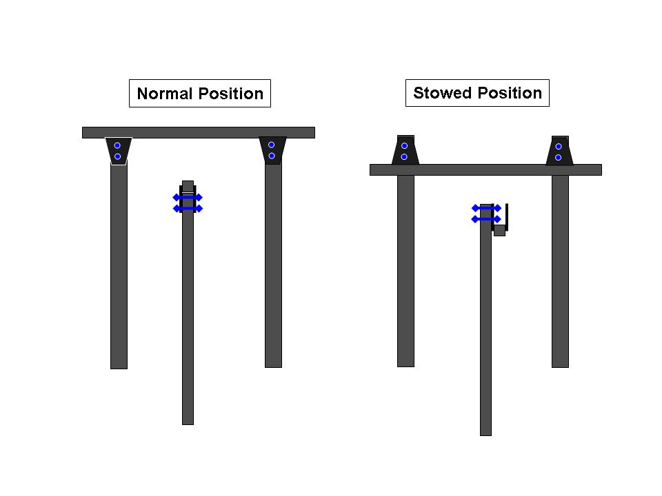

Good morning Jim,
I'm 99% sure the pic below depicts OP's ROPS configuration. I'm thinking just a hitch pin in lieu of bolt should be adequate if removing horizontal bar suffices.
JC, I agree that four (4) pins will be sufficient. My folding ROPS on my tractor is held by a hitch pin inserted on each side. I'm wondering if the OP could not just pull the top off, turn the top bar and flanges upside down, and then attach it to the front of his arms with the pins while in the garage. When he gets out of the garage, he can flip it back right and install it onto the top of the ROPS posts as normal. See my attachment.

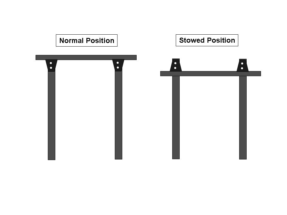

Hi jinman, sadly the cross member is solid. So I can't just do a flip.
I don't mean as a permanent change, just to hang the ROPS top so that when you get it out of the barn you can easily reinstall it. Even folding ROPS take time to fold up and insert pins. On yours, you'd pull the pins, set the ROPS top in place and reinstall. See the modified illustration below. If you forget to reconfigure your ROPS, at least you will have some rigidity between the tops of the arms.
   / roll bar question #20
Do the upright members go into sockets [that I cant see, but may be hidden] between those flanges on the crossbar? If there is a full length socket then youre good with 1 bolt .. or pin, on each side. If not a socket you must use both holes and bolts -- not pins or else the strength will be severely compromised.
larry
