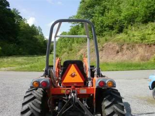

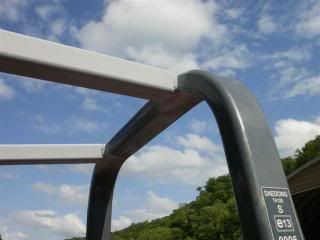

Update:
I kept getting a serious rattle from 1600-2000 rpm from the front support tubes where they bolt to the loader arm brace. I drilled a hole, then welded a nut to make a "set screw". Once tightened up, it fixed 90% of the rattle...so now it only vibrates at 1900 rpm, so I just stay out of that "zone".

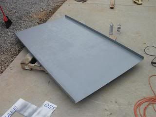

MotorSeven, I've been thinking along the same line. 250+ for 8 dollars worth of plastic doesn't seem like a good deal. Could you tell us what the diamond plate cost? .perhaps before and after the rollI. I was also thinking 72" for some shade on the backhoe driver
