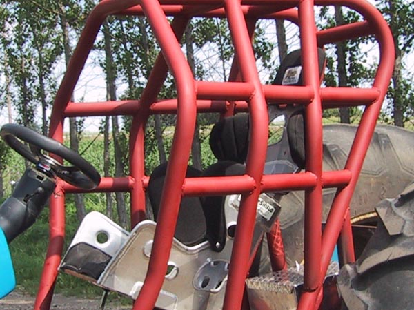

You guys are turning this into a major project...lol. Its basically a garden tractor. He's not gonna jump it. Jeeeezus...lol.
By the way...why dont you just let your welder handle it ? You've praised his ability. Are you trying to impress him ? Now your talking about heat treating this ? LMAO !!!! Still...back to your idea I see. I'm surprised your not making this out of 8" I-beam. Heat treating...lol. Say...why not stop by your local hospital and see if you can make an appointment to get the welds X-RAYED ????
Please post pics of this NASCAR approved cage when its completed sir. Tractor should be worth at LEAST $5000 more when your done (rolling my eyes).
Oh...and just in case your wondering about my experience: My parents owned a machine/fabrication shop (been doing this stuff most of my life). I then went into the Air Force, and worked on the flight line (FMS) as a welder. I worked 8 years as a JOURNEYMAN welder in maintenance at a Dunlop Tire plant. I have worked the past 18 years as the JOURNEYMAN LEAD WELDER/GROUP LEADER in the tool room at General Motors.
Not that any of this matters...but just in case you questioned my credentials.
Should look something like this...by the time your done.

   / Roll Cage Tie In Suggestions #35
Now I was just talking about using the 1 3/4-inch round stock for the short little nipples, not the entire cage.
I had the opportunity to spend a Saturday with some NASCAR weldors at Miller's testing facility in Chicago, those boys forgot more about welding than you and I will ever know!;)

Don't forget to weld in some crack arrestors! (p. 181) ;-)
http://www.shipstructure.org/pdf/81symp14.pdf
Good luck. I think you'll be fine with just tying the top tubing into that square bar by chamfering the edge from the outside and putting in 3 weld beads, but that's assuming you aren't going to roll it off a cliff.

Just hit the ignore button for posters you don't like. I think you are doing a great job and in my opinion the rops is going to be the weak point. Be sure to think before you add too many gussets. Sometimes they can create local stress concentrations in excess of what would happen by just letting it bend. I have a good article on it I'll try to find.
