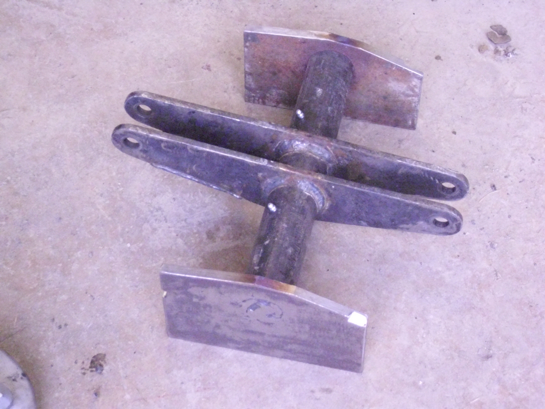

Yes the long arm is down on my 1460. This gives more mechanical advantage for the cylinder.
   / Roll Over Linkage - Some help plz #12

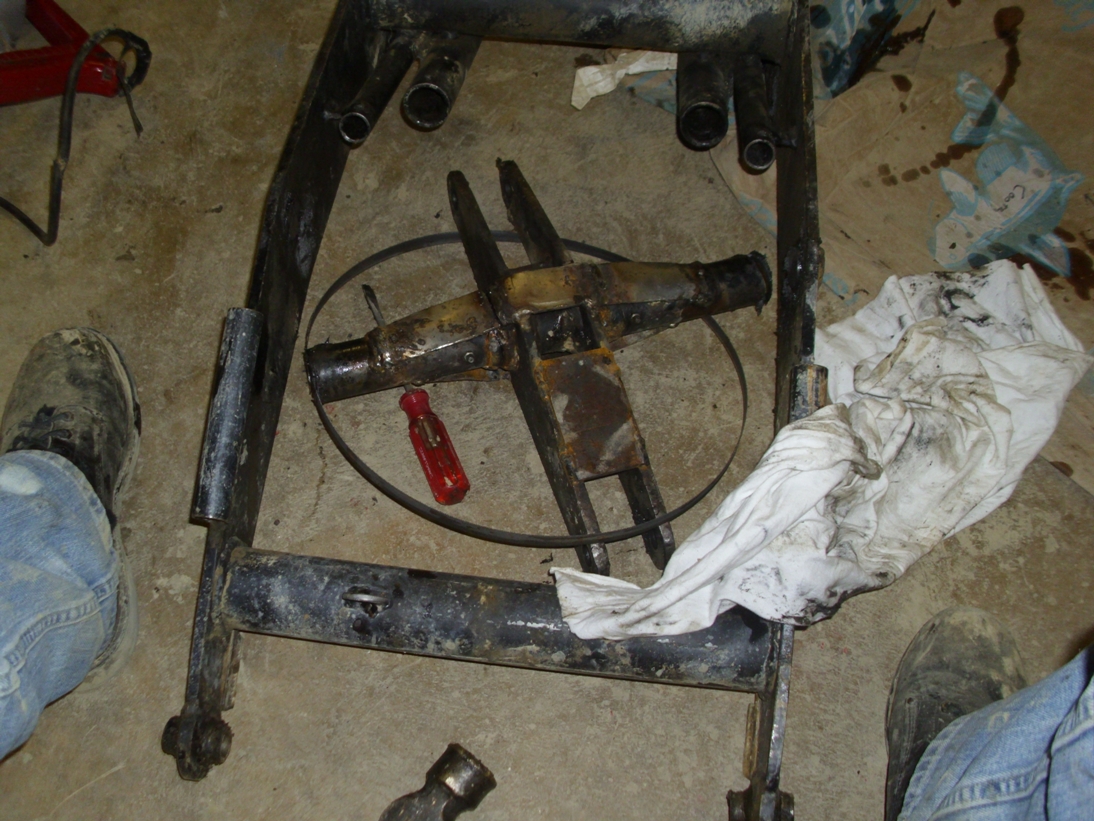

Mine was long arm up but it bent the quick attach plate so they sent me an entire lift assembly to replace it. Now short side is up the way it is suppose to be, that is what they told me at PT. I have a PT 425 by the way.
   / Roll Over Linkage - Some help plz #13
Does your roll-over assembly have the space to rotate around so the short end is down, or does it hit the connecting tubes for the lift arms? .
The difference is that if the length of the bottom and top roll over arm is about the same length as the QA plate mounts, then there is no mechanical advantage. If it is longer that the QA mounting points, there is a disadvantage.
With the short arm on the bottom, you will transfer less power to the QA plate. If you have the desired tilt, I would not worry about it.
If all mounting points were equal, you would be able to transfer the force of the cyl to the lip of the bucket.

On my original rollover link, the length was 24 in, and the replacement was 20 in. and the layout of the holes was different. More force with short side up.
Can anyone roll their rollover link 180 degrees?

Finally found the picture of the two roll assembly's for comparison. Big difference. The new one was disappointing, as I had to compensate for the roll over angle. The straight one was better.
http://www.tractorbynet.com/forums/...-pt425-lift-arm-center-link-tilt-assembly.jpg
Wow, that is one heck of a difference.
