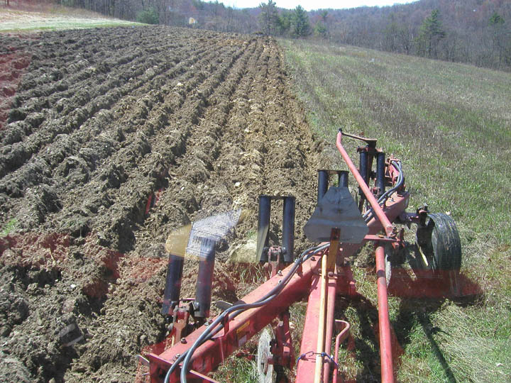

You definitely want a high clearance plow, nothing worse than constantly having to get off the tractor to unplug the darn thing.
Have you looked at the old IH or White plows? Lots out there for decent prices since many folks no-till.
